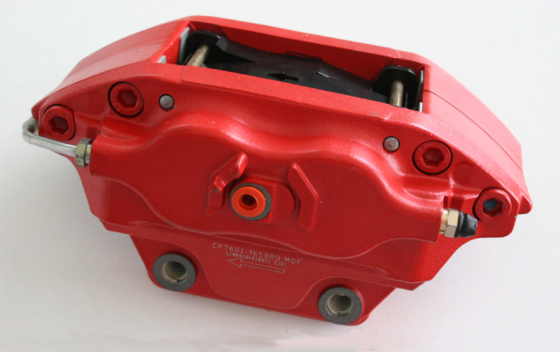

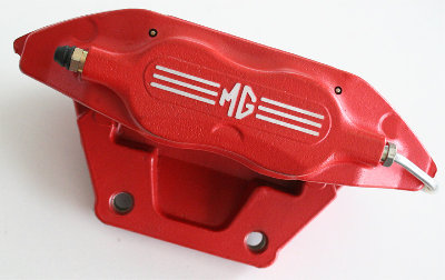

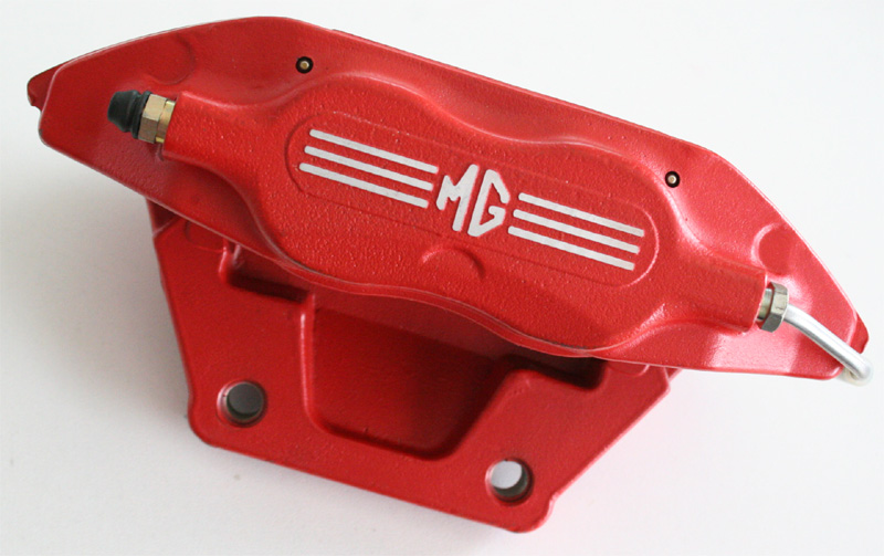

I did some research into diemsions/specifications of various OEM fitment four pot calipers from different brands, knowing that the obvious choices are just blatantly over priced. I setteld on the MGTF Trophy/T160 AP Racing calipers:
The MG area will be milled flat, the calipers resprayed in gloss black with the standard yellow AP Racing decals i.e.:

Re: MWSTEWART | Si project - AP Racing Brakes 19/12
Postby Excursion on Sun Dec 19, 2010 10:18 pm
My choice was based on the data which I collected:
MGTF
PCD: 4x98.5 mm
Wheel Centre bore: 56.6 mm
Caliper lug spacing: 82.55 mm
Disc size: 304 mm
Fiesta
PCD: 4×108 mm
Wheel Centre bore: 63.4 mm
I plan to use the calipers with ST170 discs. The loss of 2mm on each side of the disc is offset by a ridge on the MG pads. If the ST170 discs don't suit the caliper offset then I will have the centre bores on the MG discs enlarged and the holes milled to suit the Ford PCD.
The Calipers should be a bolt on solution, if not they will be modified to suit. Two piece discs will be added later. All in, I've saved at least £1200 off an AP kit.
