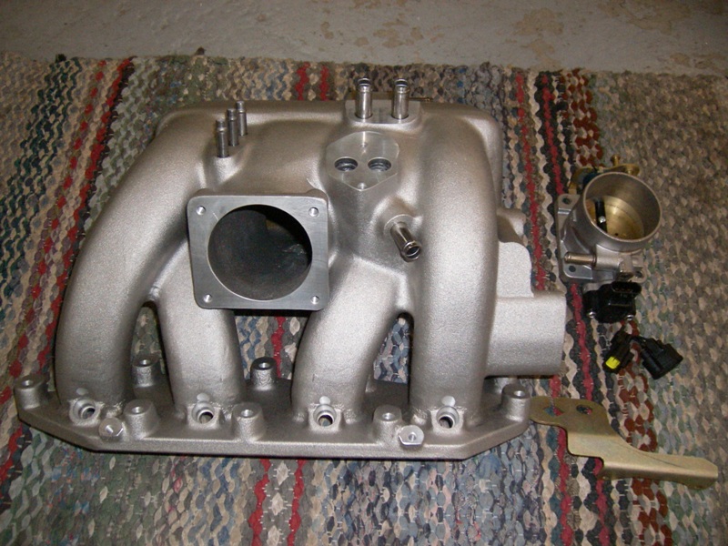

Re: MWSTEWART | Si project - FRS Manifold 13/12
Postby Excursion on Mon Dec 13, 2010 11:58 am
I have bought a Focus RS Mk1 inlet manifold and some brand new injectors. This obviously is a bolt on solution for the Zetec, so I'm going to use this initially whilst I take some time to sort out the Pulsar inlet.
If I stay this route, then the Ford Racing manifold becomes an option.
I could do with a spare 1.8/2.0 head to help mock up the Pulsar inlet. Anyone got one?
Postby Excursion on Mon Dec 13, 2010 12:19 pm
RS_seg :i got hold of one of those ford racing inlets ,but had to sell it on when it clashed with the brake bar that goes along the bulkhead to the servo. :(
Ahh, I thought I recognised your username from Focaljet :D
What engine and gearbox did you have? Where did it foul?
I'm using a Black Top and ST170 gearbox with all the Focus mounts, which means the engine is titled forward a few degrees like the black top should be. When using a Fiesta gearbox, it isn't, and space at the rear is limited, so I've got a bit extra to play with...but the Ford Racing plenum does look massive!
Postby SEG1 on Mon Dec 13, 2010 12:47 pm
Excursion :
i have the silver top engine with a focus rs box ,the engine and box have been spaced forward 1cm and i still had no luck. :( .it was only fouling right at the bottom of the manifold i could of cut about 5mm off and re-weld it,but i didnt want to mess with the manifold.
since your engine has been titled forward there is a good chance it will fit. :D you can also get a pedal box and do away with the servo (what i was thinking,but not practical for everyday driving or road use).
the ford racing inlets have had alot of R&D and is probably the best manifold for the zetec turbos,im just gutted i could fit one :(
Postby Excursion on Mon Dec 13, 2010 1:08 pm
RS_seg :i have the silver top engine with a focus rs box ,the engine and box have been spaced forward 1cm and i still had no luck. :( .it was only fouling right at the bottom of the manifold i could of cut about 5mm off and re-weld it,but i didnt want to mess with the manifold.
Thanks for the info mate, very useful! I may get one and see if I've got any more room where I need it.
Postby jonyb4 on Mon Dec 13, 2010 4:25 pm
i have a spare 1.8 silvertop head going if alex falls through
that focus inlet (standard) looks no different to the normal 2.0 inlet ecpet the metal tb and intake!, is there any difference or am i right?
the racing one looks the nuts though!, sod pulsar inlets :D
Postby Excursion on Mon Dec 13, 2010 4:28 pm
jonyb4 :i have a spare 1.8 silvertop head going if alex falls through
You're right, it's the early Focus inlet (moulded, not bonded) but with FRS specific brackets for the injector rail and something else below the ISCV, what looks to be a US TB, and the FRS top section.
Postby SEG1 on Mon Dec 13, 2010 4:36 pm
is the frs inlet the same dimensions as the ford racing one? would have thought they would be similar

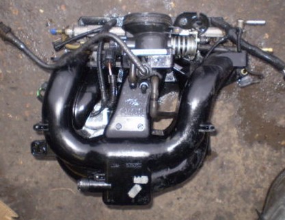

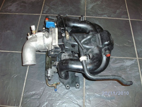

Postby Excursion on Mon Dec 13, 2010 9:39 pm
RS_seg :is the frs inlet the same dimensions as the ford racing one? would have thought they would be similar
I'd be surprised mate, the Ford Racing manifold looks a bit bigger, I know the internal ports are larger.
Early Focus:
Late Focus:
Ford Racing:
