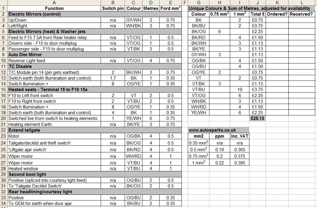

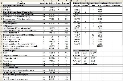

Small update, I've put together an order for the additional Thin Wall cable that I need to add extra features to the loom. I found a supplier who can match all of the MY2000+ Ford colours, which is great. It took a while!
