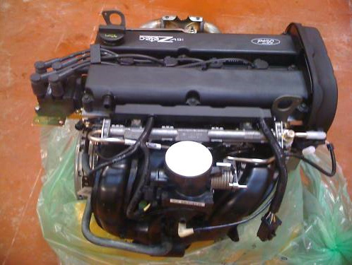

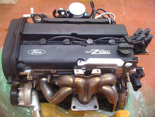

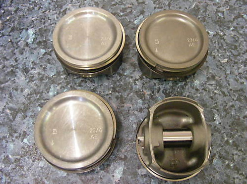

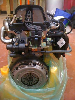

Some engine purchases.
Brand new Ford Crate Engine - Series 3/Black Top 2.0
Brand new Focus RS Mk1 Pistons and Rods
I was going to fit a Focus RS engine, but the cost/benefit ratio didn't stack up for me. I appreciate the FRS lump has a 30% increased flow water pump, and unique cams, and valve springs, but the design goal for this project is a road car. It'll be given to my girlfriend for her runabout (I'll pinch it for the odd track day!), so power will be capped to 280ish bhp. For this I don't need anything exotic in terms of hardware, and it will be managed by EECV management for great driveability.
Re: Si project - Engine 22/09/2010
Is that FRS management?
All sounds great, where did the engine come from?
oo brand new blacktop, bet it was a few notes
looks good, will look factory in the mk3s bay

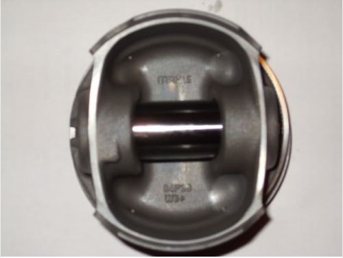

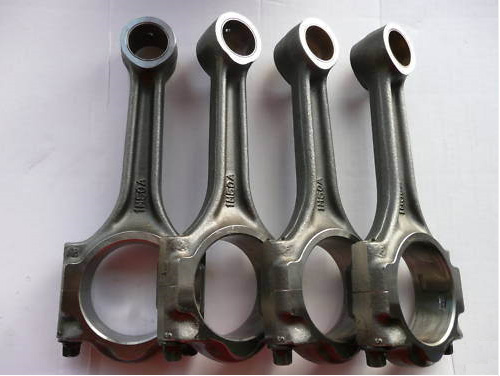

Mark, what sort of money are the rods and pistons? If you don't mind me asking, that is
- Smo
- Posts: 8658
Smo :Mark, what sort of money are the rods and pistons? If you don't mind me asking, that is
Sure, £270 delivered from eBay.
Great stuff
That's a really good idea, using a new crate-2.0 Blacktop then installing the FRS pistons/rods
At least you know the engine is new and isn't some Ebay rip off that's covered 200,000 miles at 30 PSI boost but is being sold as "30k miles, runs perfectly"!
I think the Ford EECV is a great bit of kit, "Allinking" on this forum and myself are both using it. There's no denying that stand-alone ECU's are very desireable but pound for pound, the EECV FRS ECU is a great choice for a 300ish BHP Zetec or Duratec in my humble opinion
lovely parts you have there ,can i ask is there any difference between frs and st170 rods? both steel?
- FRSJON
- Posts: 4662
- Location: ISLE OF WIGHT
Cheers chaps.
Jimmy I love it, the SCP bus should output lots of useful information, that and the usefulness of EOBDII make it a winner. I think the later units also have CAN! It's technically far superior to most of the basic after market stuff anyway.
smo The FRS pistons/rods are a funny one when it comes to resale - that's why I got them so incredibly cheap. For one, Ford don't sell the rings for them, and also the pistons are only made to suit a standard bore - which rules out pretty much all second-hand Zetec's these days.
FRSJON Yes they are both steel, but the FRS rods are even beefer than the already beefed up ST170 rods:
Engine/material/wrist pin
Std. Zetec - cast - 20.638mm
ST170 - Forged 20.638mm
FRS - Forged - 22mm
FRS - Forged - 22mm
