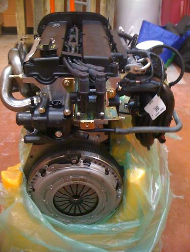

Here's mine Image Worth it just to look at :lol:
Clark - I thought this was just an oil loss issue. If it's knocking then ditch it because that worn metal has to go somewhere i.e. all around the engine.
There are too many decent Zetecs out there, even the 130k milers still have honing marks in the bores, this engine sounds like a nail.

Ryan donated a air filter that fits the maf so that did away with the black tape
Nice genuine ford fuel filter
A sticker that is now correct to the engine :D
mounting the ecu with the fancy bracket jay made me. I used armourflex tape to insulate the bracket.
I cut off the rubber boot to allow more room for the loom to flex and manouver the ecu into position.
All fitted , mount was fitted to the brake servo mounting studs on bulkhead.
Under dash insulation refitted :)
