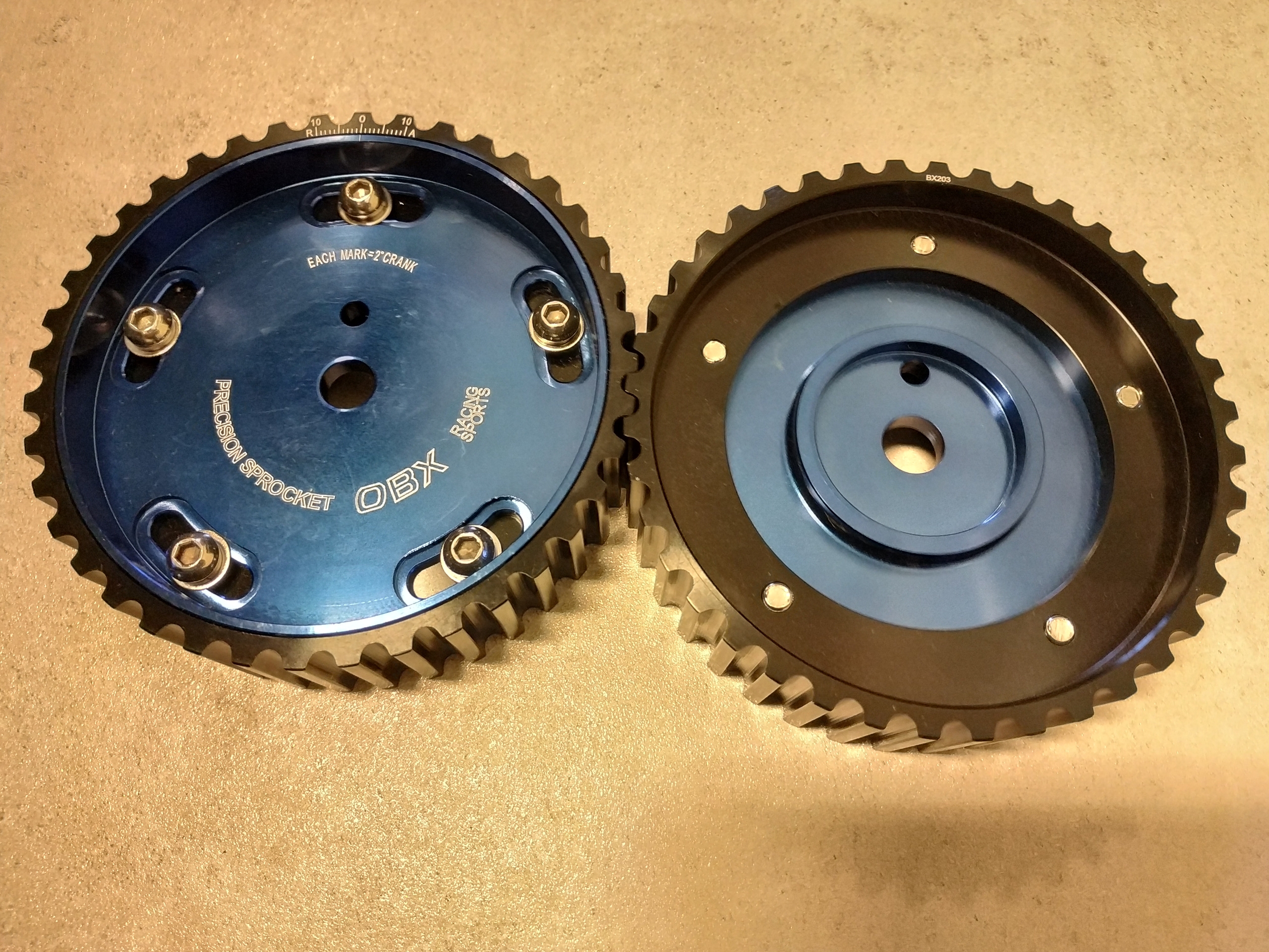

- Pipercams 285H, OBP Vernier Pulleys

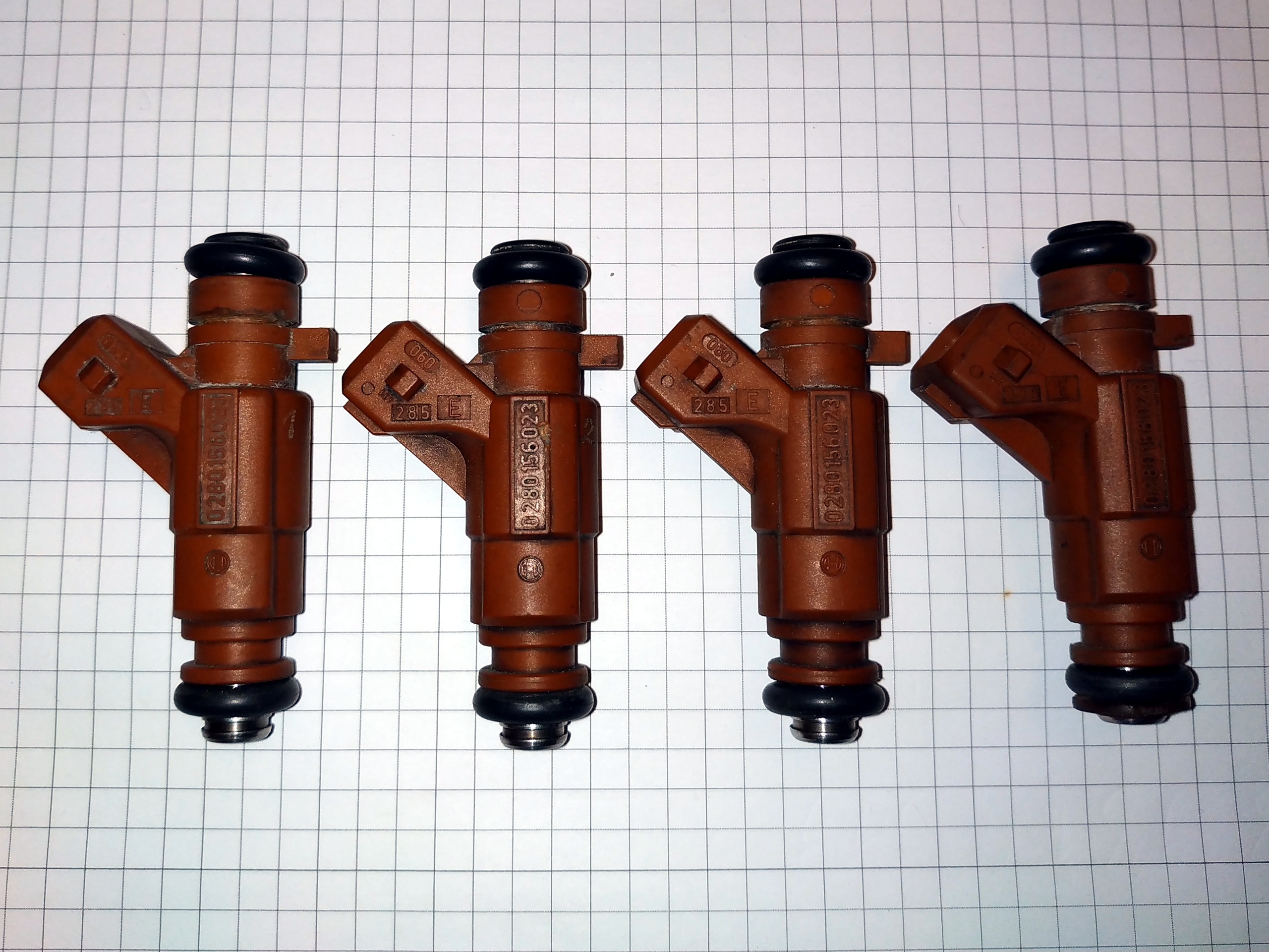

- ITB based on GSXR1300 trumpets + Saab Turbo injectors

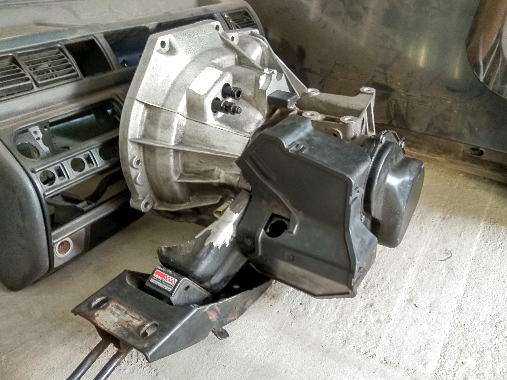

- Fiesta MK6 TDCi housing
- Torsen Val Racing 50% 10Kg
- hybrid gears and main gear ratio 200km/h@7500rpm
- 4-blade sinter clutch
