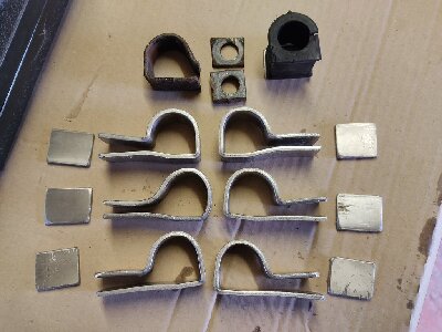

Postby Mav Singh on Fri Dec 09, 2022 4:13 pm
hi, can i get a set of these for my car? one has snapped again....
1.6 si
Mav Singh
Posts: 1235
Joined: Sun Dec 29, 2002 3:15 am
Location: West Midlands
Your car: 1995 Fiesta Si 1.6
Re: New stainless steel rear anti roll bar barckets
Postby Mav Singh on Wed Mar 22, 2023 10:41 pm
currently in the process of making these clamps myself. looks like im the only one daily driving a mk3 fiesta these days.
just got the hole left to drill in the clamp. used 3mm 304L stainless steel 25mm wide with length of 200mm. thats enough to make 1 clamp and its washer.

Postby BOBFRST on Wed Dec 27, 2023 12:50 pm
They look like they'll do the job nicely Mav :)
I could do with a set of your making them to order :D :D
