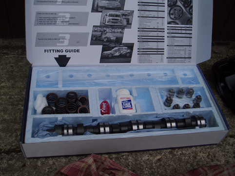

This is the engine rebuild last year
The head with a Kent CVH34 fitted

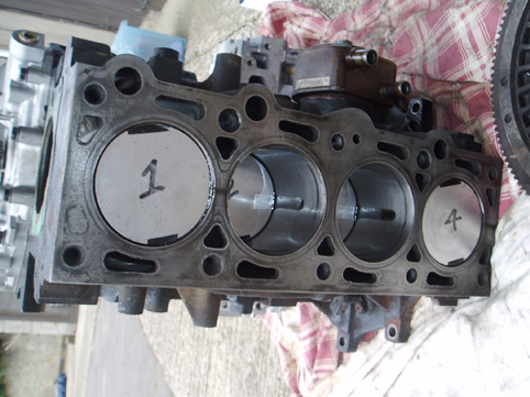

The block with new big ends, mains, oil pump, rings and i had the pistons skimmed to match the skim on the head for correct compression

Postby Fezzy Turbo on Fri Jan 07, 2005 10:33 pm
Nice car mate .......
becareful of skimmed pistons though.

Postby dan_turner on Fri Jan 07, 2005 10:52 pm

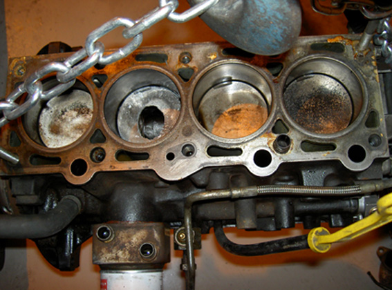

Funny you should say that!!!!!!!!!
Last month
OOOOOOOOOPS!!!!!!!!!!!
I Know what the problem was though the fuel pomp lost pressure and it ran lean ive got a escort cossie pump ready for fitment now

Postby murfs_frst on Fri Jan 07, 2005 10:59 pm
just out of intrest whats the problem with skimed pistons,
very tidy fiesta m8 :D
murfs_frst
Posts: 134
Joined: Tue Dec 28, 2004 1:46 am
Location: harrow,london
Postby dan_turner on Fri Jan 07, 2005 11:02 pm
it makes the tops of the pistons thinner so less heat resistant causing them to melt down. like mine did!!!!!!!!!!!!!!

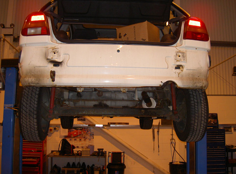

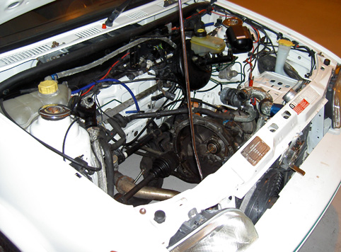

Postby dan_turner on Tue Jan 18, 2005 11:06 pm
Hi all here is the start of painting the underside of my car unfortunatly the battery went flat so i didnt get any more on the day but they will follow soon
cheers
