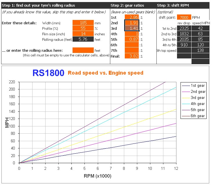

Changing Petrol 5th for Diesel 5th. I gave up trying to find a 5th gear puller, so fabricated my own.
Diesel 5th vs 1800 Zetec 5th

whats the advantage of putting the 5th gear from the diesel box into the petrol box? and what are the differences in gears from the photo of them both? apart from the size

Postby Ruishy1 on Wed Mar 24, 2010 9:52 pm
the diesel has a longer 5th ratio IIRC so higher top speed, and better fuel economy at cruise

Postby jonyb4 on Thu Mar 25, 2010 4:27 am
no it would take longer to get to the top speed as its a longer gear, but it would take you to a higher top speed then the petrol one (taking longer to get to it compared toa petrol ;) )

Postby Excursion on Thu Mar 25, 2010 12:21 pm
Petrol 1800 5th is mismatched for the 2.0 IMO. I plotted the graphs using projects utility.
RS1800:
Rebuilt with Diesel 5th:
You can see on the RS1800 graph just how short the 5th is, this is to negate the lack of torque from the 1800 engine. The 2.0 can cope with much more than the 0.87:1 5th.
Adding the 0.76:1 5th gives a nice spread of ratios without too much rev drop between 4th-5th.
I beleive some Escort 1.8 Zetec's had the 0.76:1 5th
