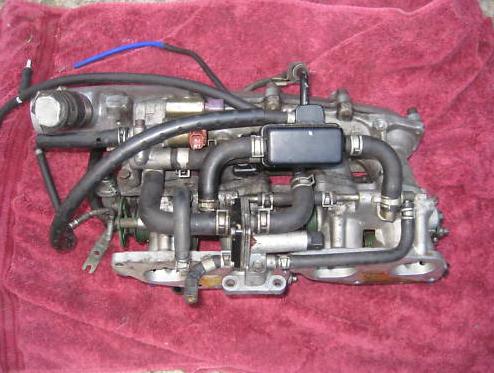

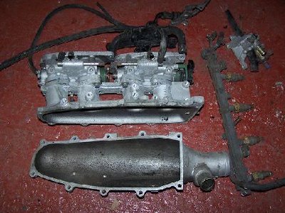

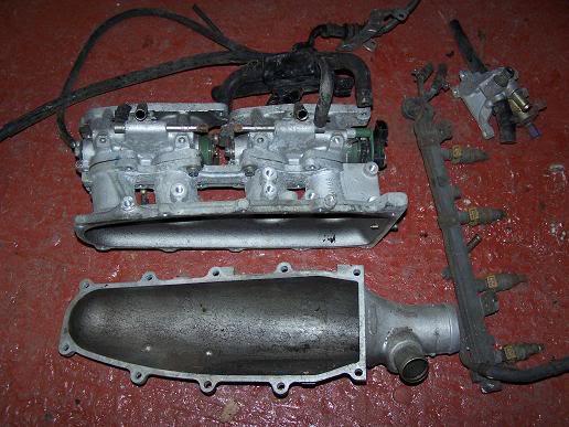

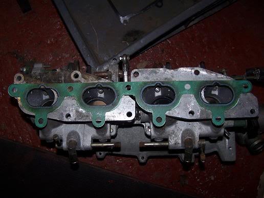

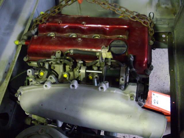

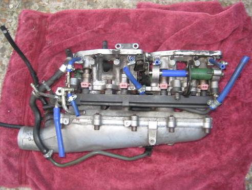

New inlet manifold. I've wanted to use this manifold for about nine years now, but never had a project that would suit it.
It has 46mm ITB's and a great plenum design that I can easily space to suit my capacity requirements.
It's going to be a lot of work, and I'm not sure about fitment around a black top alternator, and also in my application the engine will be tilted to aid weight distribution, but if I can make it work it'll be amongst the best of the Zetec inlet manifolds to date.
Here are the port centres compared with a Rover inlet gasket, pretty close! A small amount of welding and porting required on Cyl. 1 and 4.

Postby jonyb4 on Wed Nov 03, 2010 12:26 pm
Looks like a cossie inlet to me, nice thou should add some ponies and look good too
Re: MWSTEWART | Si project - ITBs 03/11
Postby Sphinx on Wed Nov 03, 2010 12:36 pm
Is that a Pulsar inlet?
Postby filtra on Wed Nov 03, 2010 1:08 pm
Yeah, looks like a pulsar inlet, didn't sunil run / plan to run one on his n/a 2l?

Postby jonyb4 on Wed Nov 03, 2010 1:41 pm
as in the 1.3 pulsar?
why would a 1.3 inlet be any good on a 2.0?
Postby Ruishy1 on Wed Nov 03, 2010 5:58 pm
inlet from a nissan sunny gtir, sr20det engine.
nice :Q
Postby ~nomad~ on Wed Nov 03, 2010 5:59 pm
jonyb4 :as in the 1.3 pulsar?
because Pulsars are not 1.3, thats why.

Postby ~nomad~ on Wed Nov 03, 2010 9:09 pm
good times - back on topic, pretty interested in this, if it can be made to fit. How do you think it will compare with jenveys in a NA setting Mark?
~nomad~
Posts: 12504
Location: hertfordshire
Your car: Breadvan
Postby Excursion on Wed Nov 03, 2010 11:54 pm
~nomad~ :good times - back on topic, pretty interested in this, if it can be made to fit. How do you think it will compare with jenveys in a NA setting Mark?
I don't see why this wouldn't be just as good, if not better. It should be as good as the massively expensive Jenvey set up with the alloy plenum.
The ports are close enough to get a decent match after a little welding and re-shaping. mMy main concern is packaging, it may be Ok for you with the Silvertop, though!

Postby Ruishy1 on Thu Nov 04, 2010 7:21 am
what are the distances for the ports mark ?
Postby Excursion on Thu Nov 04, 2010 10:06 am
Excursion :I don't see why this wouldn't be just as good, if not better. It should be as good as the massively expensive Jenvey set up with the alloy plenum.
PS For a Turbo app the ITBs don't make any difference at WOT, although going from part throttle to WOT is much crisper. It's worth it for the small outlay of the second hand manifold.
It should however make a significant difference in your N/A application.
