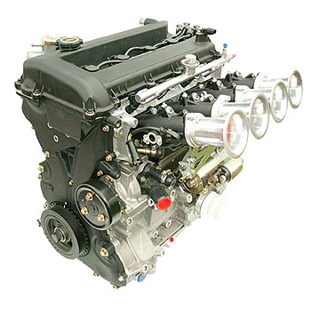

U know something! i got a mag from burton power there last week and am in the process of finding can that engine be turbo'd, now i know it can, that was [ERRR] i was thinking of going for my fezzer.
they say that the cranks are strong but the rods and pistons are not, they say that it can be tuned to 300bhp with no mention of a turbo, but that means serious rebuild though. and a lot of money.
good luck with it mate i am goin to keep an eye on this one for sure. i really hope it works out, but ull be finished b4 me.
here is a picture of it, looks good but not so sure about the plastic look though. but can be tuned to more power than the zetec.

RST-CRAZY :U know something! i got a mag from burton power there last week and am in the process of finding can that engine be turbo'd, now i know it can, that was [ERRR] i was thinking of going for my fezzer.
Yeah you're right there about the Duratec producing silly power even in N/A form - SBD got 304 bhp from a 2.0 without forced induction! :o
As standard it's a "squarer" engine than the zetec in that the bore is bigger and the stroke slightly less (similar to V*xh*ll XE Lump). This, combined with the fact it already has massive valves and a very good flowing head (originally for emissions puroses :rolleyes: ) allows the engine to reach high revs easily and breath very well.
Although I love screaming N/A engines for balls-out fun, I want this one turbo'd as it's nice to have an engine that idles like a standard car and has loads of useable torque in the low/mid range to make it a nice car to use on our busy roads as well as the odd track-day. Being just over 2.3 (once re-bored for the new pistons) it should have an abundance of torque! :)

I was wracking my brain trying to decide which alternator setup to use, I was all set on forking out for Burton's Duratec Alternator kit (£450 inc Vat! :rolleyes: :o ).
Ridiculous price-tag aside, I was also swayed away by the fact that I'm converting the Fez to power steering from the MK3.5 (I know, I must be GAAAAY! :lol: ) so am using a Fiesta ST150 Power steering pump with all MK3.5 Fez Power steering pipework and rack.
I have purchased a Mondeo/Focus Duratec 2.0 Alternator from Ebay (hurry up Royal Mail :rolleyes: ) and said ST Power steering pump.
As you can see, the block still has the idler and tensioner pulleys present, the alternator goes at the top on the rear and the power steering pump goes at the top on the front so along with a non-aircon Focus 2.0 Duratec drive-belt, I should be laughing (for a quarter of what Burton's effort would have cost me)
Side view of my 2.3 Duratec.
