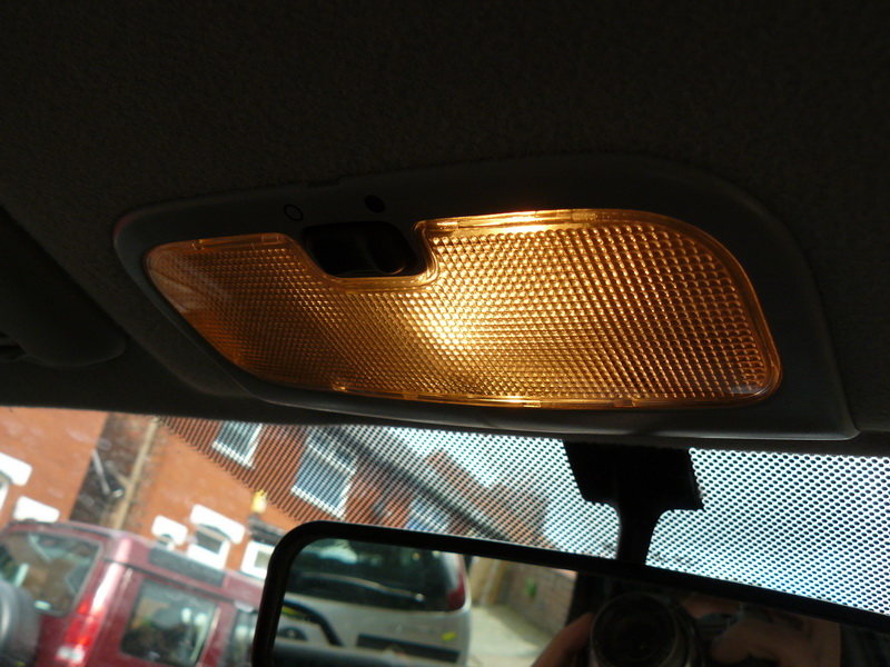

Has anyone done any swaps/modifications on these? I find them rather boring, would want something thats probably abit brighter, maybe even has 1 soft light, and 2 seperate reading lights.
I know that many people put VW passat interior lights into there mk4 golfs.. just wonderin if anyone has put anything into there fiesta (mk3) from a mondeo/focus/scorpio etc....

oo! that looks not too bad there Tweek. how did you fit those in? Normally when the mk3 interior lights are there's a bit indentation surrounding it.
Does it just fit snug into there? I'm very interested, as this could be a cheap, £10 mod (i reckon we should create a thread/topic along those lines)

You need to take a knife to the headlining to make the hole a bit bigger. Not only that but you need to cut some of the plastic off the back of the light too. Remove the connector wires from the plug, connect to new light and use some araldite to fix the new like in (tidier than mine though lol)
Don't worry about changing bulbs either, can remove the glass and bulbs from the outside

cool, sounds good. but if its glued in.. then it would never come out again (unless one hacked away at it). It would be good if there was a way of clipping it, or slotting it in. For whatever reason. LIke something stupid, like if the wires corroded lol.
If i do this.. i could use the boring light as a rear courtesy light, like on the fiestaguides website.
on a side note.. what about colouring the entire headlining black? seems like the only thing abit out of place in the mk3.5 insides

I've changed mine to have 3 crystal clear Blue 10,000MCD LEDs in. with a resistor for the 12volt

A mod like this would be perfect.

You could also just get a reading light (led on a flexible arm, which plugs in the lighter socket) from a pound shop. I know my local shop sell one.

naaah, I wouldn't want to buy one of those reading lights. I'd prefer to improve what I have, and the puma lights look like it would be a nice thing to have, without making it stand out too much. (maybe even spray it black so that it would match the dash)
