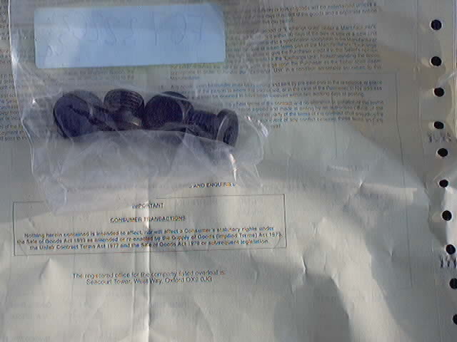

4 x 6732263 - Copper washers (see pic below)
4 x 1008597 - Blanking Plugs (see pic below)

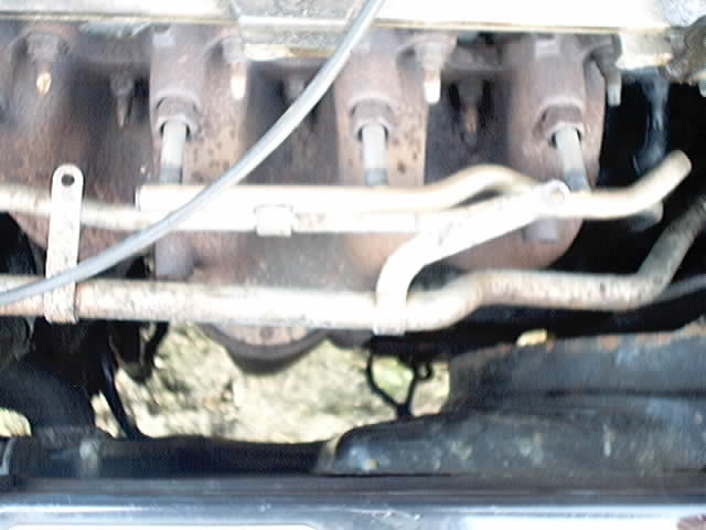

Then it's just a case of getting a 19mm spanner and undoing the pipes 1 by 1....if your car is anything like mine then they are probably a bit difficult to remove so I decided to get a 19mm 6 sided socket on them. The pipes are very thin and cut easily...as you can see:
To remove the pulse air piping follow the 2 metal pipes down towards the starter and you'll see a big black box bolted to the block infront of the crank position sensor. Remove the 2 10mm bolts and unplug the vacum hose then carefully remove the whole assemby making sure you don;t damage the radiator.

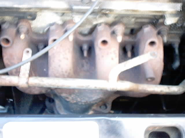

This is what we've removed...you can see the pipes that go inside the mainfold here:
This is it all removed:
now all you need to do is get the 4 washers and blanking plugs and an 8mm allen key and screw them into the holes in the maifold.

Good guide. Got my parts from Ford and it was about a fifteen minute job. Has anybody whos has done this noticed any difference? I haven't!

Went for a spin in mine last night was going about 30 and one of the baxtered popped out!
Fixed it, went out again, and the same thing again another one popped out
I lost that one so gonna have to get some more from ford
Getting then welded in this time.. bloody things.

Just rang my local ford parts. 97p each for blanking plugs, 11p each for washers. bank breaking. they're special order parts though
