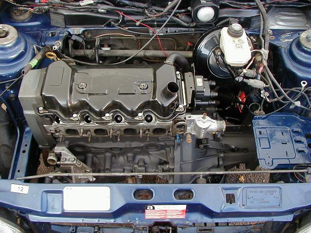

Next job was to get the engine reddy to go into my car
Fitting power steering pump and cleaning/painting replacing broken bits
ERST gearbox
Buy this time i had the engine out of my car dont have pics of this dont
know why must have been to busy :)

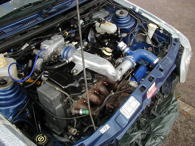

Back to it.
By this time i had run out of time off work so every thing was done in the eveings and at weekends which is why its taken so long to do.
Or so why i didnt put this up when i was doing it just didnt have time.
Inlet manifold going on and turbo
Power steering bottle, had to move this from buy the brake servo to the inner wing because i didnt want to run all the hoses past the hot turbo
and really just seems esayer having it there.
Rest off the stuff going in not really that hard just takes time had to cut
and join some off the water hoses to fit around the p/s pump.
Air fillter on
Rad and intercooler fitted had to cut a bit away to clear the fan.
Tank painted black then fitted with frst fuel pump
Put the drive shalfs back in used the si ones as the hub end is bigger on
the si's (30mm nut on an rs to 32mm on si's) same size gearbox end.
Then came in my view the hardest bit the wiring :aaah: this in its self
took about a week and a half.
I had fitted the rs engine loom into the car and left the si interior loom
the problem came when i went to plug the looms together.
Cant remember this exactly so dont hold me to it but the si loom had
some thing like 12pins onit and the rs 7pins and there all diffrent colours
So started looking at all the diagrams but this wasnt really any help as
they didnt show this plug so i started taking the looms apart and fine out
what each one did one by one.
Found out a lot of the si ones werent needed for the rs loom and a lot of
them were just current returns so conected the ones that i needed put some petrol init and tryed my luck, after terning it over for ages i still
wouldnt start so swaped over the current returns and it started :D :D
Thats about it sure iv miss bits out just ask if you have any questions.
Still finshing it off now im being really picky about it because i want to get
every thing just wright befor its back on the road so still lots off updates to
come.
This is it as off a few weekends ago
Now with pace cooler :wink:

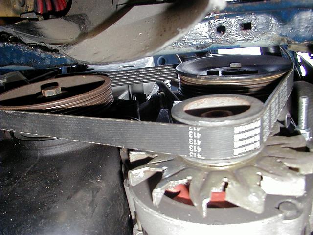

Postby jayrs on Fri Nov 17, 2006 11:55 pm
nice one mate
take it yuo fitted the alternator at the back then?
and used what pully for the bottom mate to run the belts?
Postby russ_si on Sat Nov 18, 2006 12:13 am
No the alternator is fitted under the p/s pump same as i was on the old
engine used the pully of that as well, belt is 6pk by 937 or so and runs
around the out side of them all.
Can get a pic if you want?

russ_si :No the alternator is fitted under the p/s pump same as i was on the old
yeah please mate, would be good to see how its set up :)

Postby russ_si on Sun Nov 19, 2006 5:45 pm
Alternator, PAS pump and bottom pully. Hope this is ok hard to get a good pic of it all.
Let me know if you want any more.

Postby jayrs on Sun Nov 19, 2006 5:59 pm
i see, wonder if a p/s pump could be fitted under the alternator on a T2'ed rs.....hmm
Postby russ_si on Sun Nov 19, 2006 6:09 pm
Sorry mate that pic is tacken from under the car looking up.
So the p/s pump would be on top of the alternator :)

Postby jayrs on Sun Nov 19, 2006 6:22 pm
sorry mate i dont really make my self clear some times.
i ment if i was gunna fit p/s on my rs i wonder if i could fit the pump under my alternator as i still run a t2

Postby russ_si on Sun Nov 19, 2006 7:37 pm
:lol: :lol: sorry.
Not sure would be very low, think you would end up hitting it.
