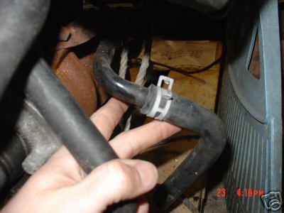

The radiator you can see in the pics above is the one at the top of this picture. The one below it is a Fiesta Si radiator. You can see the three ports are on the right hand side. In, out, and header tank return:
Is the coolant hose you speak about going into the oil cooler?

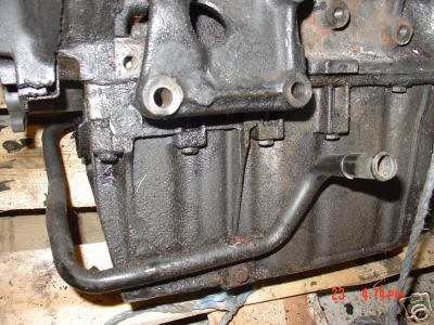

Postby rob pace on Thu Mar 23, 2006 3:49 pm
yes james you are correct its to do with the oil cooler, these hoses in picture 2 and 3 come from the back by the oil filter on the endura engine. to start heres a picture of the radiator from my n/a diesel, just 2 connections.
in pictures 2 and 3 i have taken pictures of the oil cooler pipes, this is what confuses me a little, where to link them up to with the fiesta as the n/a diesel did not have this :-? :-?
also see in picture 3 the hose in my hand, this this pipe comes from the top right of the head at the back and goes into the top matrix hose, its exactly the same on my n/a diesel.
you mentioned about the header tank return (i havent got this on my radiator), see picture 4 i have taken a picture of a hose of my n/a diesel, this comes from the thermostat housing into a plug on the left hand side on the head at the back and into the top of the header tank, the endura engine has exactly the same, and i have tried the pipe on the endura diesel and it fits lovely.
regards :D :D :D :D

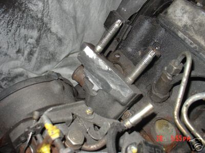

mount
Postby rob pace on Mon Mar 27, 2006 2:54 pm
just been doing some work today removing the last of the parts i dont need, progress is slow as i work early hours.
ive angle grinded this mount off the front, something to do with the PAS i believe :-? :-? :-? , it was most annoying to remove and took a while. this is about half way through in the picture.
just purchased some new glow plugs, and when i took the old ones out they snapped off :lol: .

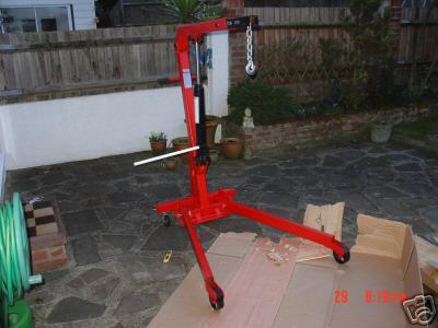

Postby rob pace on Wed Mar 29, 2006 8:05 pm
finally recieved my hoist today £133 delivered for a sealey hoist capable of lifting 1 tonne, im only going to use it this once and sell if on hopefully, no point in hiring a hoist as ill spend more money on hiring the bloody thing :lol:
also picked up some new glow plugs today and installed them. also getting some new gearbox mounts and a engine mount from ford tomorrow and on the lookout for-

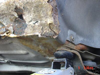

Postby rob pace on Tue Apr 04, 2006 11:45 am
project abandoned!!
after taking the lower arm cradles off i found nasty rust and i could put a screw driver through some points of it.
however i still have a brand new hoist and endura engine almost completed if they want to take it over from me?

Postby rob pace on Wed Apr 05, 2006 5:39 pm
the final days of 3 years of ownership, heres why i made a decision to give up the endura project!
look at the top picture, thats the bottom of the wing, i pulled it off with my hands! and in that pic look at the rust on drivers side and by the wishbone bolt where the jack is holding the car up!
and look at the car with no bumpers after being stripped a little! loads of parts avaliable!
