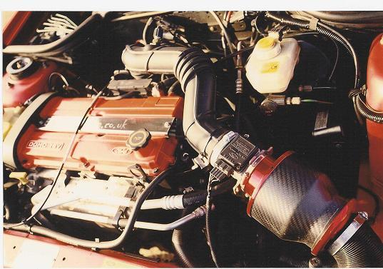

also that inlet in the pic in the post above, would that be ok or would i need the other zetec one?
as for the ecu, does anyone no the code on it as might pop to the brakers soon and i can have a route about

Ollybee says a BLOB ECU there, and hes probably right. As for the inlet, your best off getting the normal metal one as im pretty sure those ones dont fit in the Fiesta bay

As for the inlet, if it fits in your engine bay and all the ancils are compatable with the loom/rest of the engine bay etc then shouldn't be a problem. Otherwise as per my conversion - trial and error.

ill have to get the metal inlet as i wont have time to trial and error as got a week off nxt month 17th to the 21st and gotta be done within that time limit so cant afford to need an inlet and not to be able to get it
or because ive got a 1.8 will i need a different ecu?

go for the normal inlet then, get a 1800 one as the internal bore is bigger.

lol right just found out, i get my engine delivered soon, just got me afew pics, i am going to put in a fiesta zetec si complete car loom in, and the engine is a 1.8gti zetec engine, as the ecu that will be comming with the engine is a SLUG, would that fit onto my car? as in the internal/external edis etc
