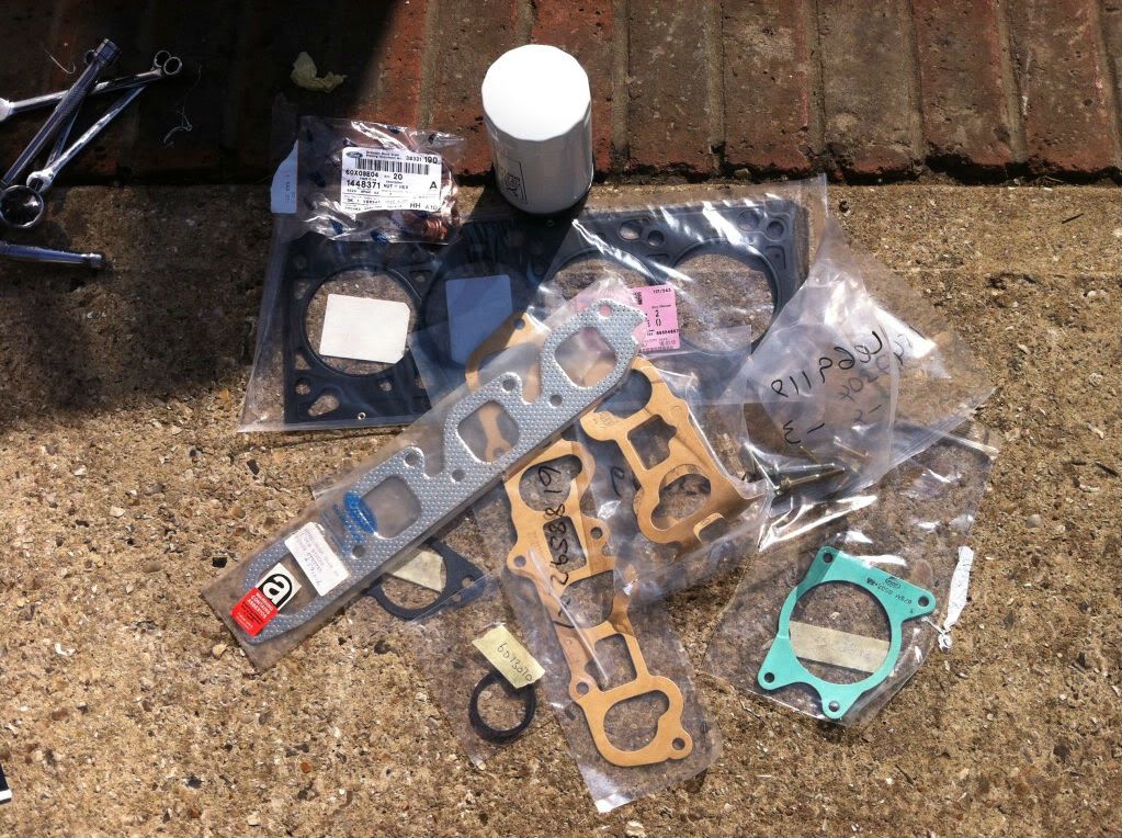

to cut a long story short when i last updated on here i was gathering all the parts i need to put the engine back together which included -
st170 headgaskit
sitec racing head bolts
new water pump
82 degree thermostat
all new top end gaskits
new plugs
new oil + fillter
coolent
magnitc sump plug from MSD
cambelt + tensioner
fan belt
new engine mout

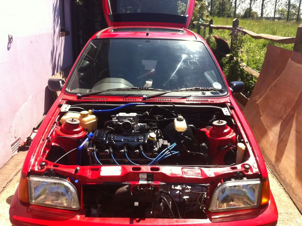

while i was at it i brought a new rocker cover (looks the nuts)
also brought a diffrent management ofab with greens an a chip done for ian howell by ahmed byjoo
PICS:

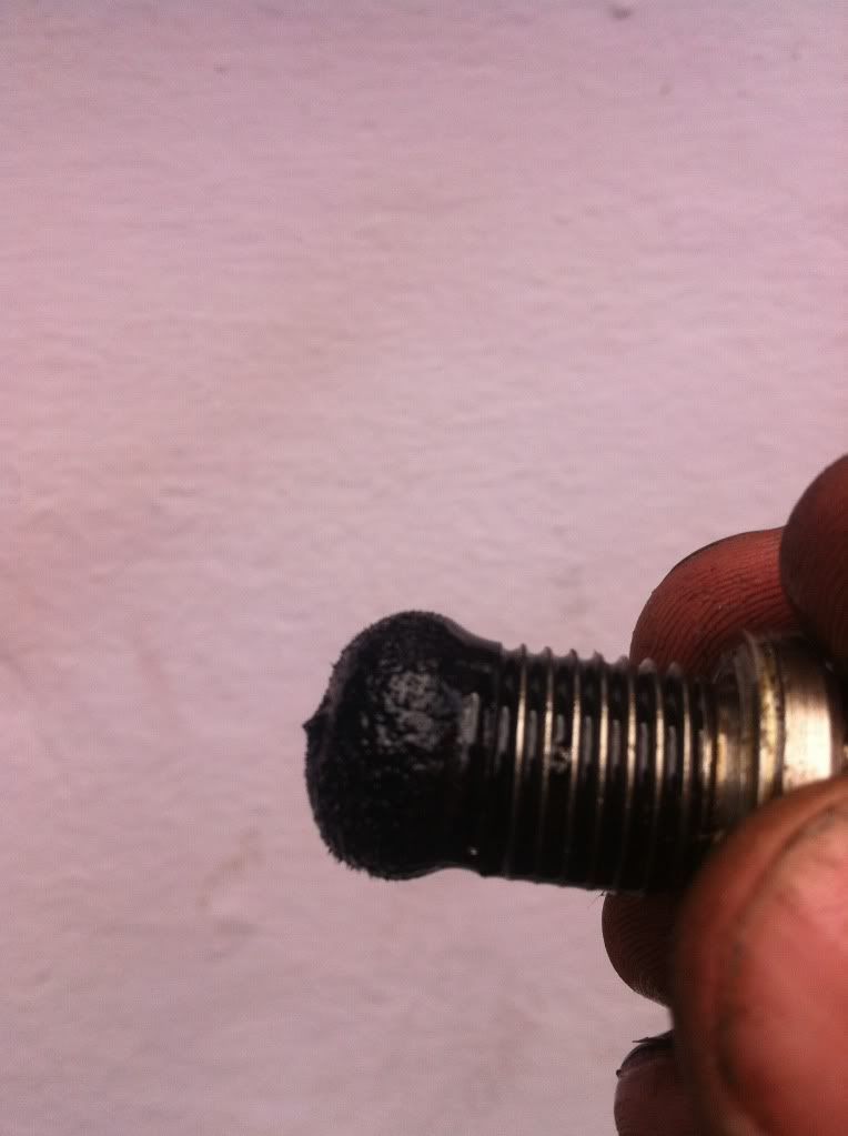

here is were the problems started

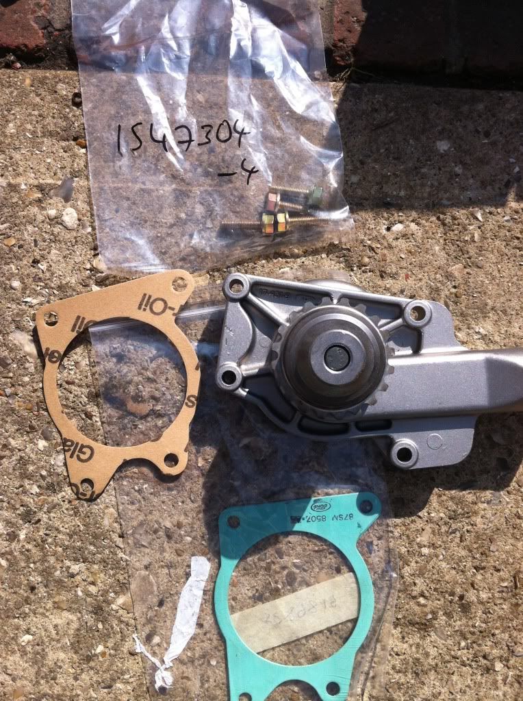

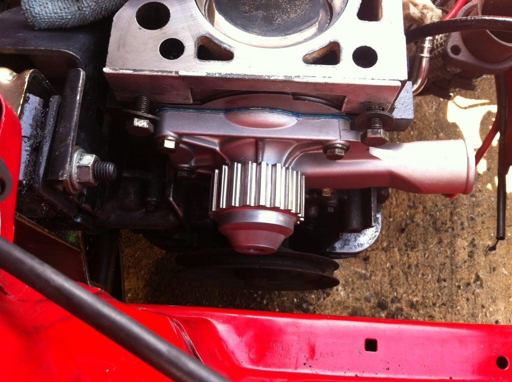

a few weeks befor i built the engine back up i boltted the new water pump on as i had a spare hour after work. all went well no probs apart from one of the bolts were not tourqing up as much as i wanted but i did load up with sealent for a sequare hold an seal.
booked 2 weeks of work to crack on with the car get it built an running over the weekend to have it mapped on the tuesday at grove garage the the rest of the week tinkering with it then the second week driving her up to scotland to see a few buddys an relax
........ NOO all the plans went out the window when i got to the stage on the saturday when i was pouring in the coolent, it pissed out from the bottom of the pump

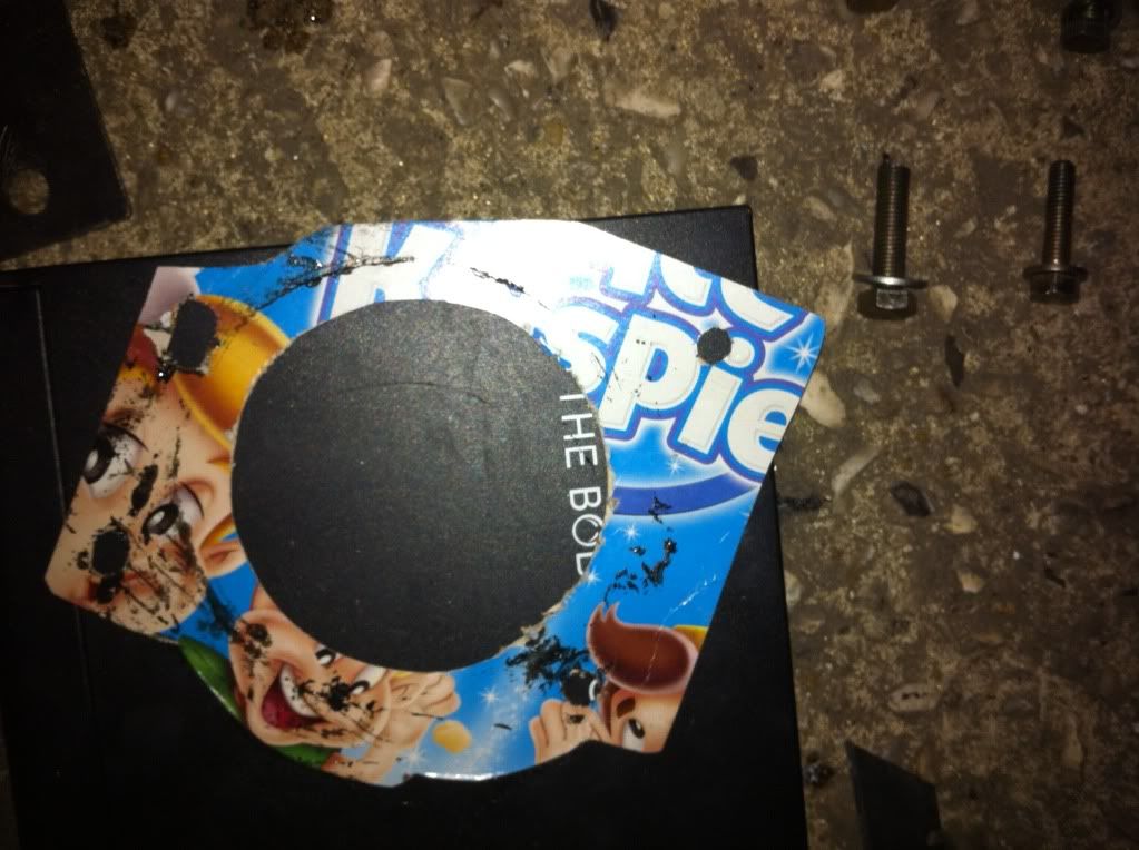

the bolt had come back to haunt me or thats what i thort so after 100s of calls to FRSJON who has been a massive help
i wipped it all of to see what was going on an it turned out that the bolt had pulled the thread so i pulled out every hair i had left out an tried everything just to hold it on tight. tried stud an nuting it put it all back together an still leeked so i thort right sod it called out a company to heli coil it an all he done was rethread all the holes an hope for the best an yep still leeked but still charged me 130quid!!!
rung him up an told him the job was not finnished so back round he come an to my stupidaty it turned out that it was leeking from the gaskit (block to plate) i was using 1.6 gaskit when i should of been using a cut out that matched the plate
my home made gaskit

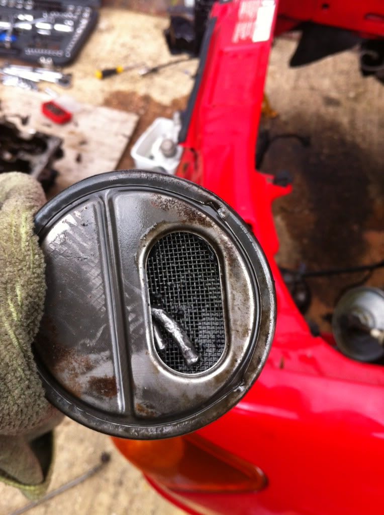

the phone call come after the weekend and bad news i needed a new cam as mine was a mess so i said go ahead with it like for like CVH 35 form kent ring me when its ready, week passes an i get a call saying had to turn the engine of when they was running the cam in as the oil preassure dropped below 8PSI
an there was a loud knoking noise coming from the bottom end.
so yes after everything i have done i have to rebuild my bottom end but with this i see an opertunity to go bigger an better so the engine is being taken to ian howell next week for inspection an also gonna talk about having a full zetec build.

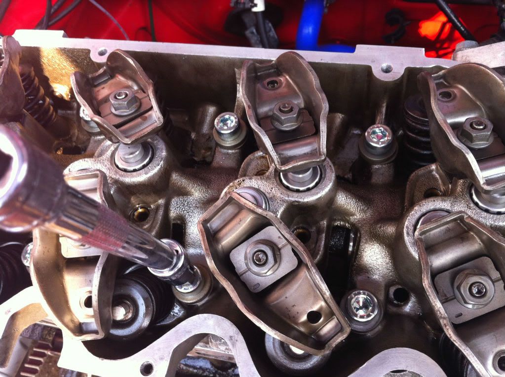

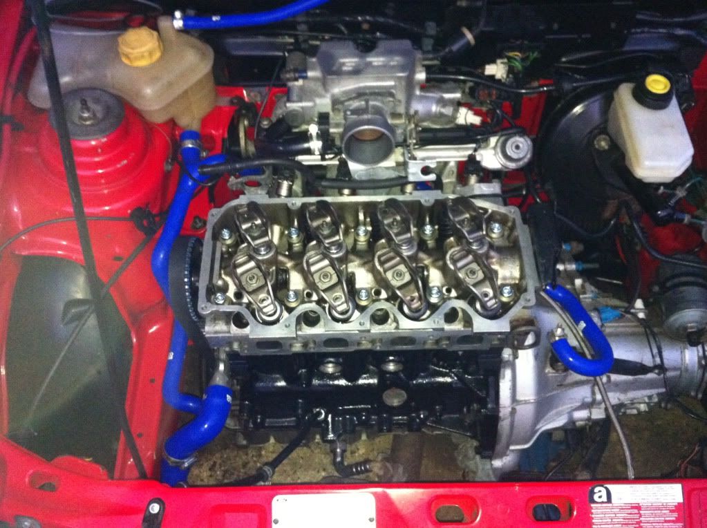

head going on.
inlet on

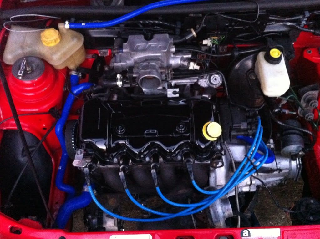

built up with new rocker cover
working in the scorching hot wether

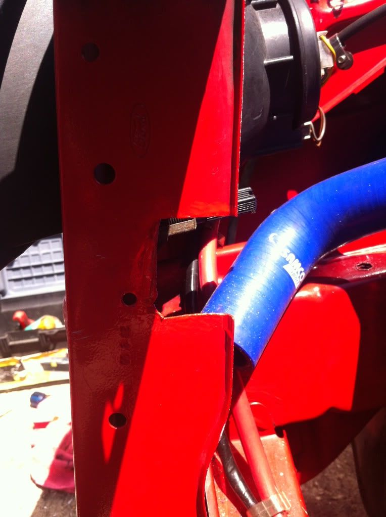

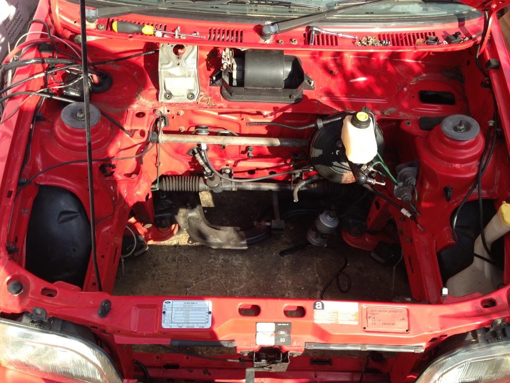

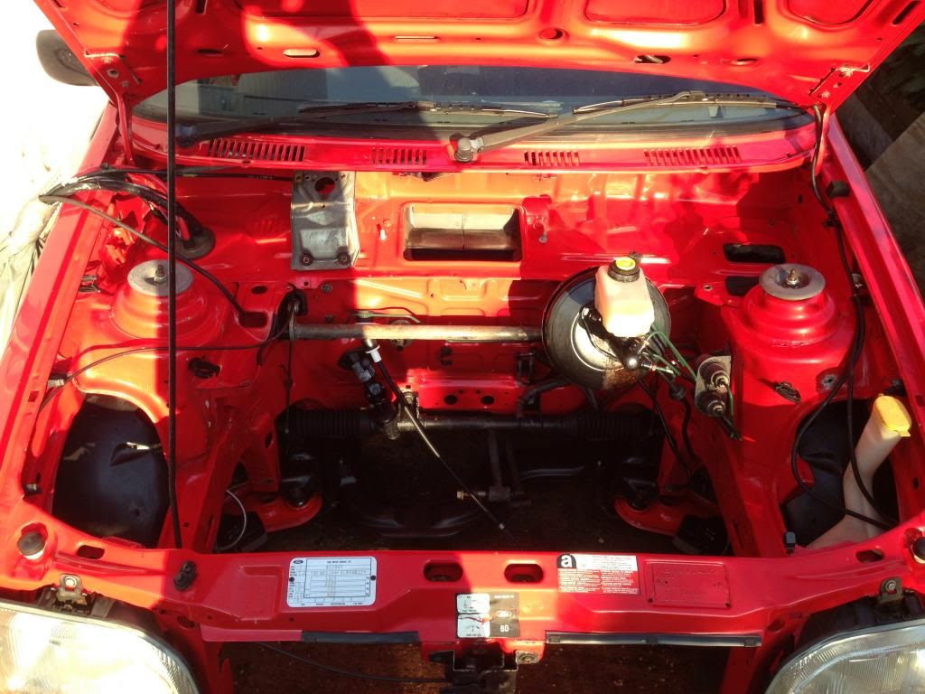

a bit i cut out so i could move the rad forward so the actuator would stop hitting it

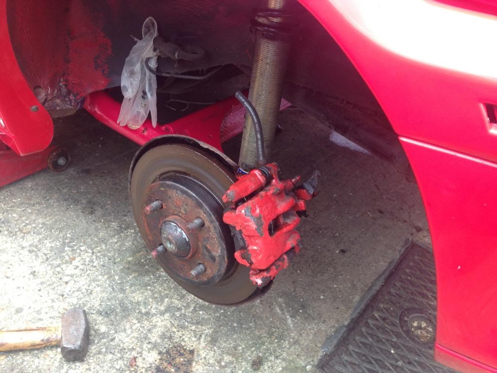

shims for the discs as the holes were made for grp A studs befor

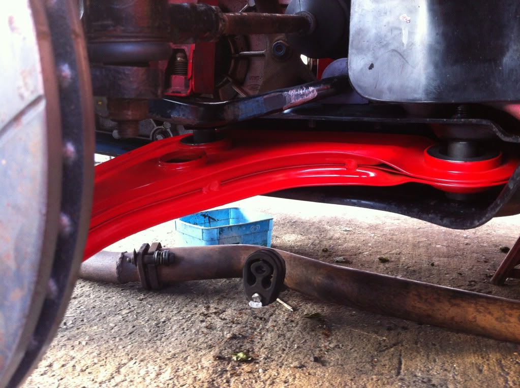

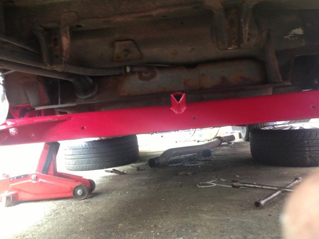

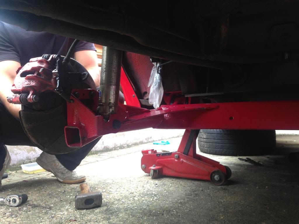

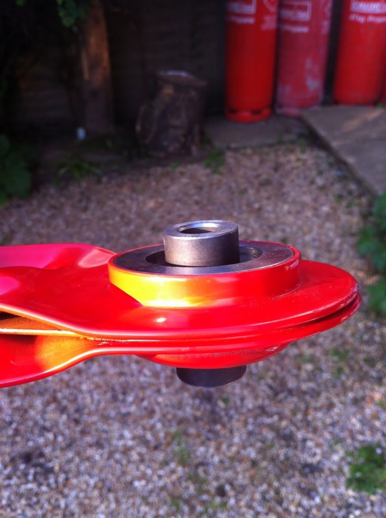

lugs i had made for the adjustable lower arms
arms in place
comments please
my home made gaskit

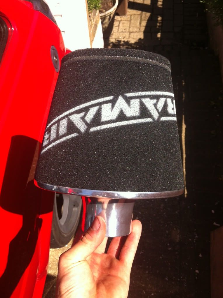

got me a new ramair filter made up

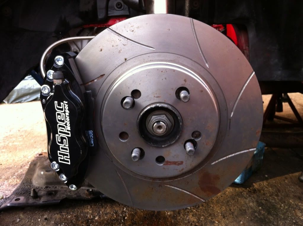

new hispec brakes

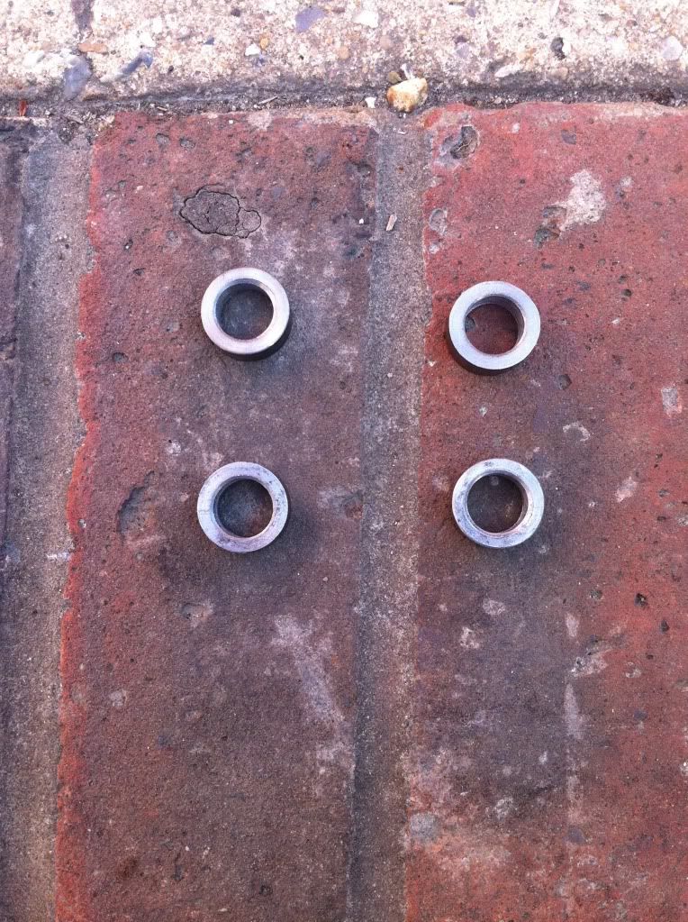

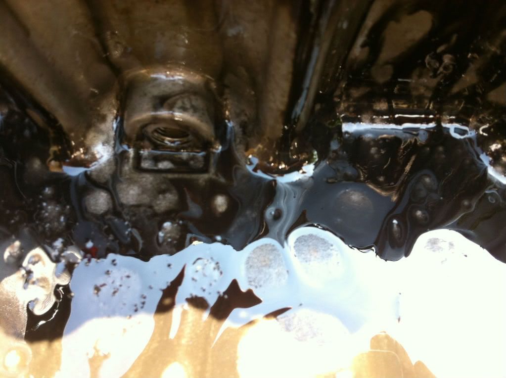

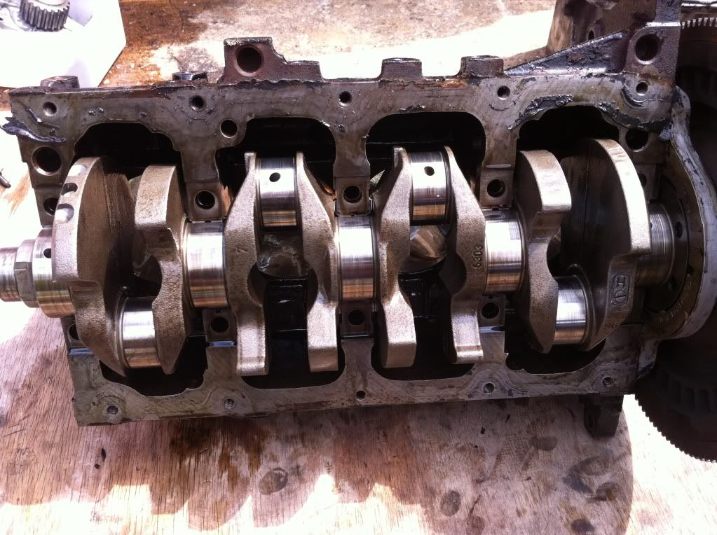

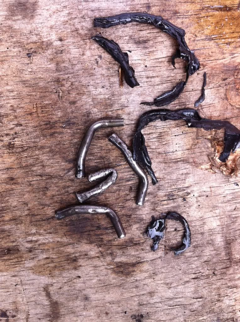

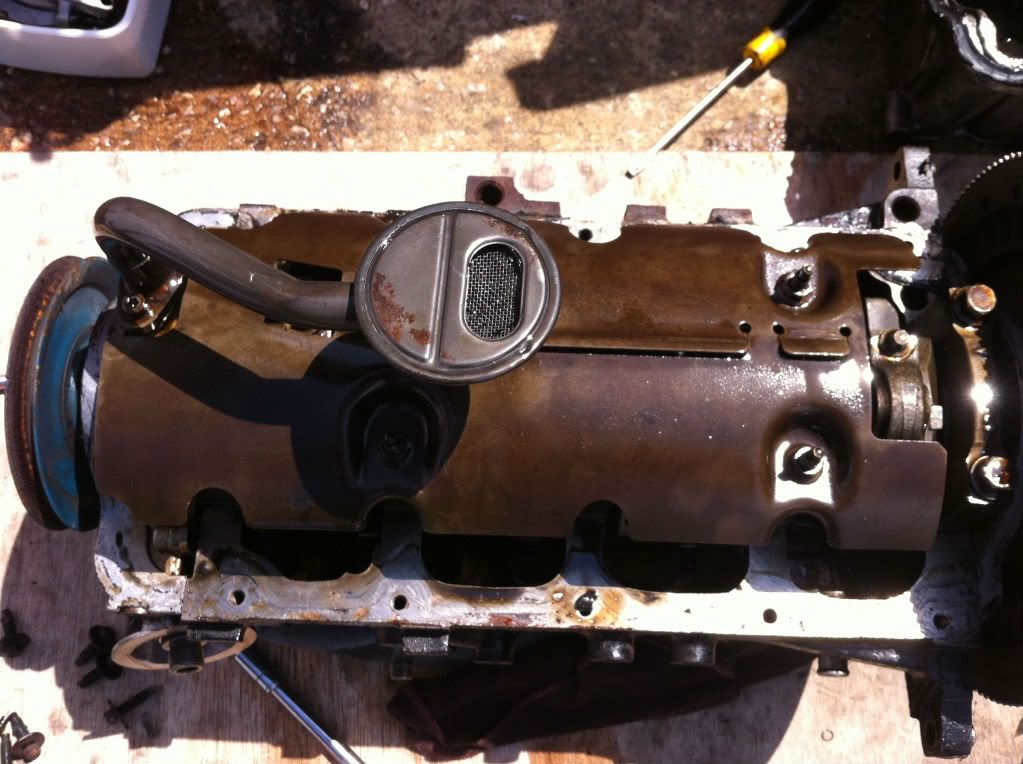

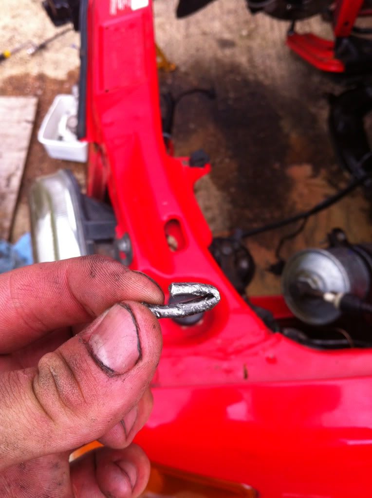

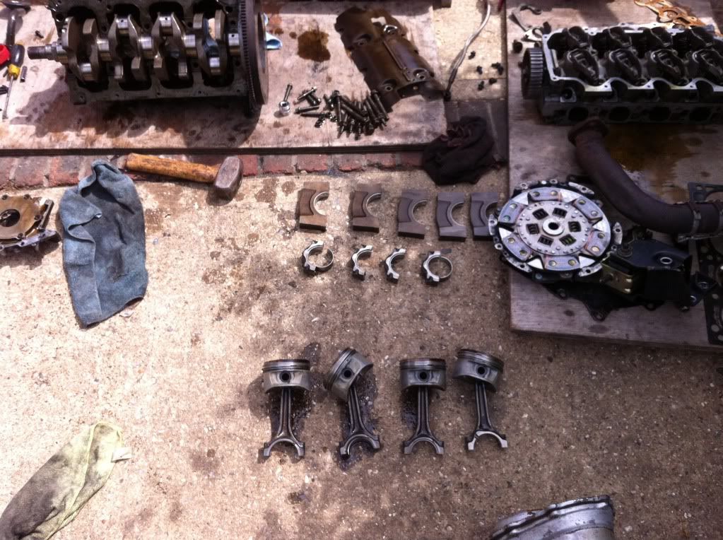

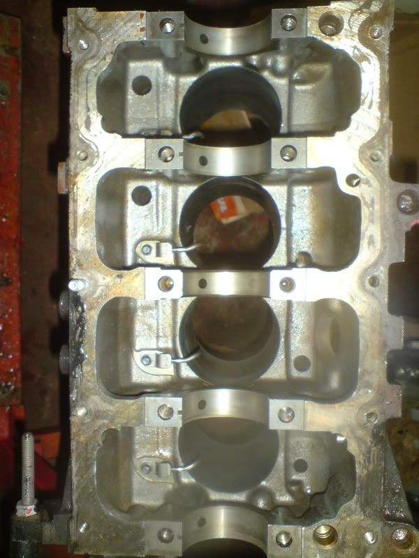

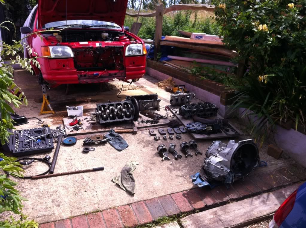

over the weekend i had time to strip the block an see what has caused the oil pressure failure an to also get the block to a bare shell as a mate is having it of me.
I did find something but i am confused as to were it has come from?
Pics
then i pulled all of this out!!!??
sump of oil looks full of metal
crank
mains, big ends, pistons an rods
fast an the furious on a budget lol
cheers ollie

they look like the remains of oil spray jets
all four of them, looks like the pistons have hit them
i machined mine so they didnt...must of been like that since day one for that engine

Re: ollieRS ZVH turbo project
OH DEAR THERE NOT THERE
- ollieRS
- Posts: 279
- Joined: Fri Apr 08, 2011 8:08 pm
- Your car: fiesta rs
- FRSJON
- Posts: 4662
- Location: ISLE OF WIGHT
was gunna say they look like the oil jets

what would of caused that then?
- ollieRS
- Posts: 279
vauxhall pistons without having the skirts machined so they miss the oil jets

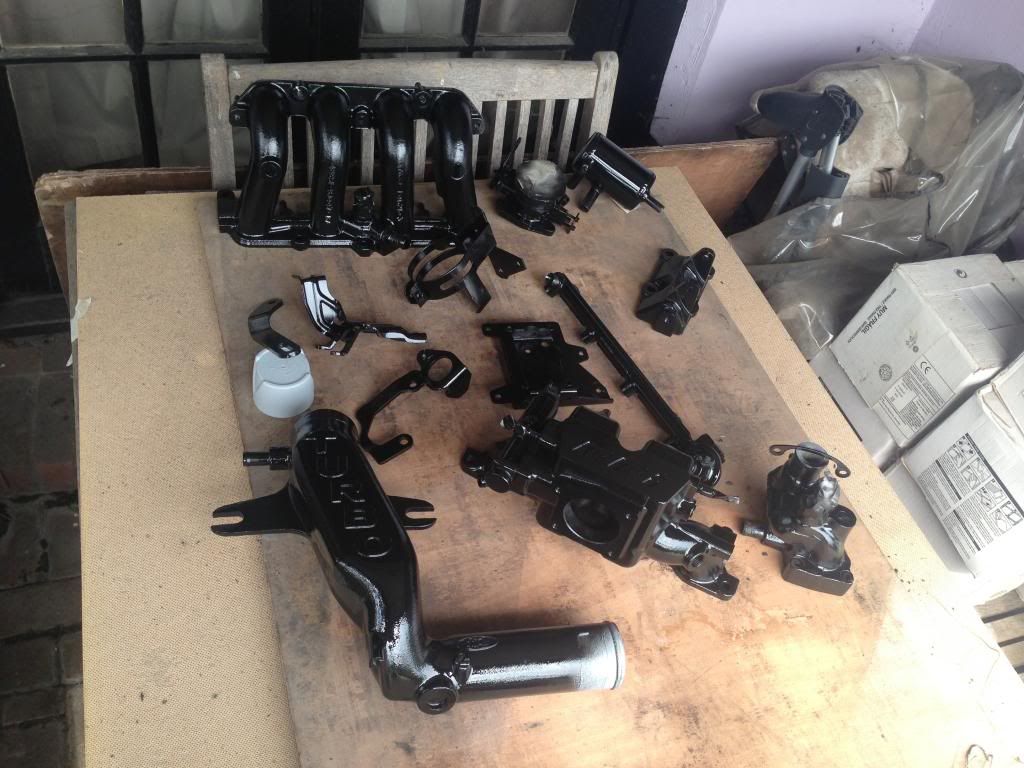

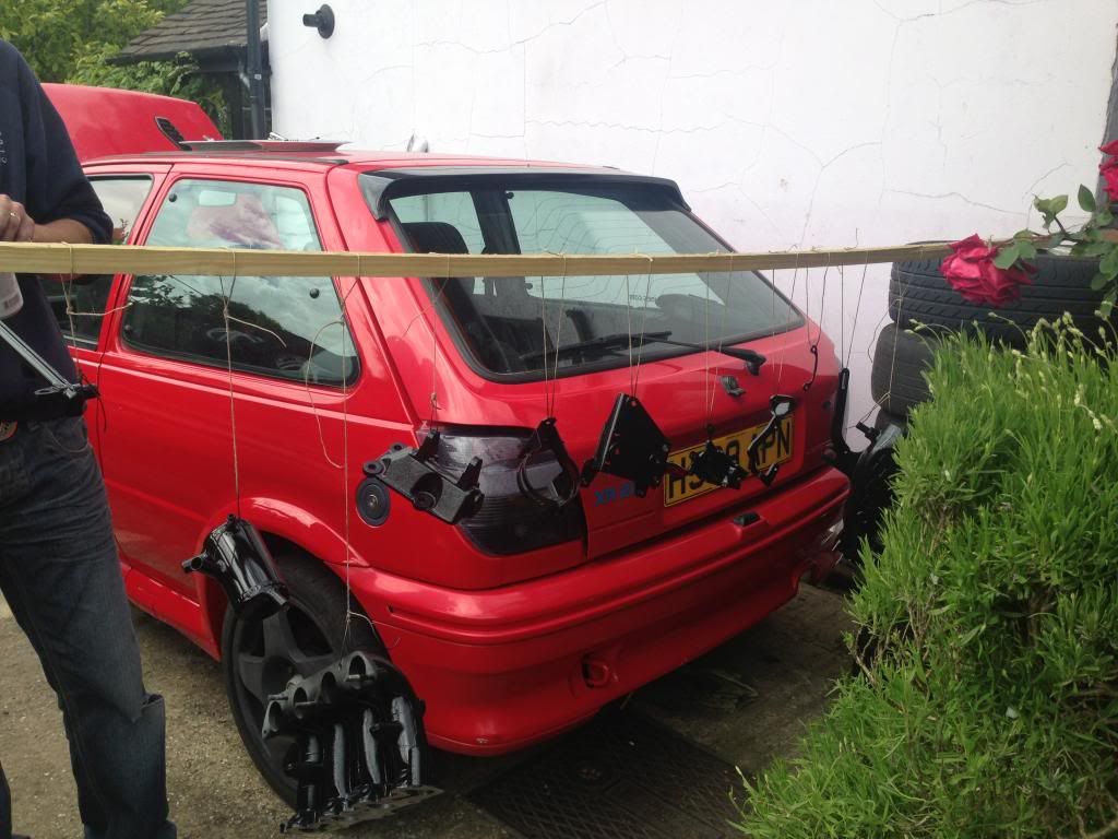

Work has finally got started on the car after a year from being of the road due to the oil failure! i was not gonna put it back on the road an even went to strip it twice!! but i couldn't bring myself to doing it.
got offered something i couldn't resist so ive pulled my finger out with the MASSIVE big help from FRSJON who has been such a life save like usual
from being left outside with just a cover on it, everything needed a clean
before
after
then finally fitted the ZS rear beam with st170 discs an suprisingly it went on with no probs at all but i do need to tidy things up an fix cables etc but looks good
with the beam all fitted jon got his spraying hands out and got a few bits done
primed (cheeky pic of jon lol)
drying
finished
the stress from spending a day with me lol it charges its self haha
comments welcome
cheers ollie
