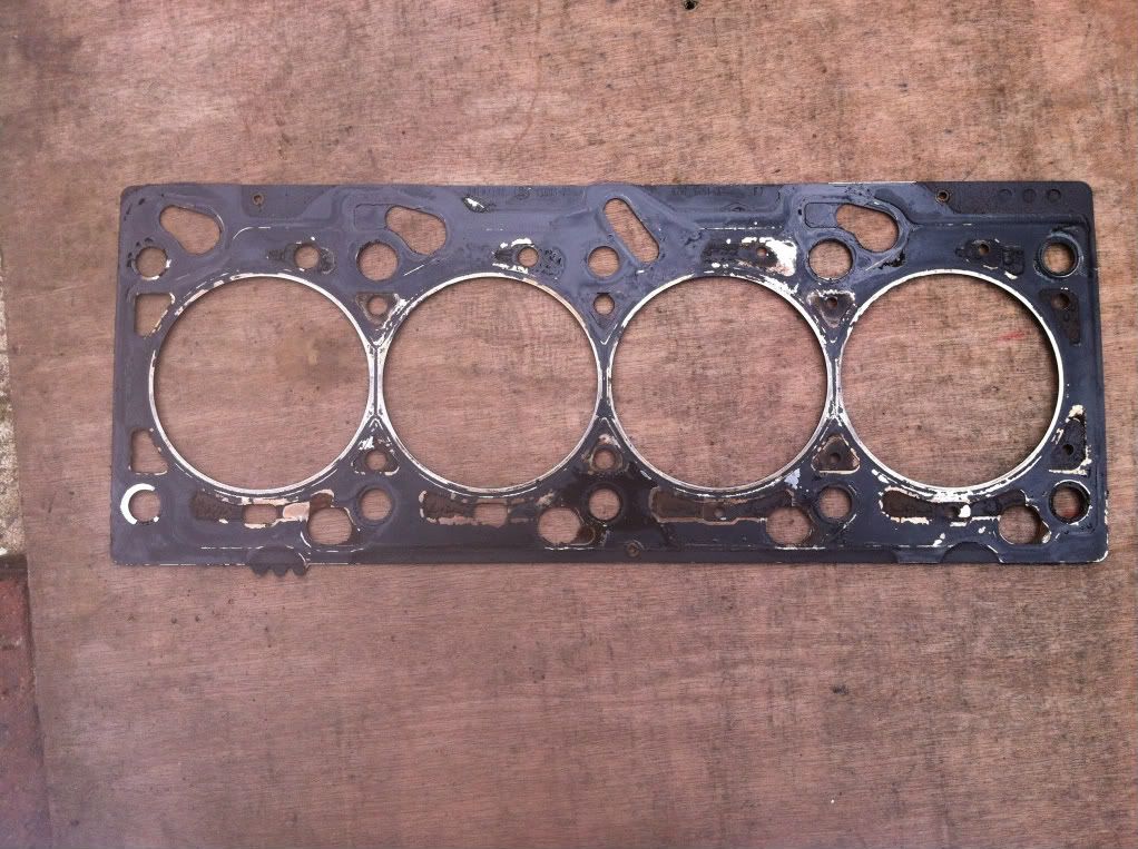

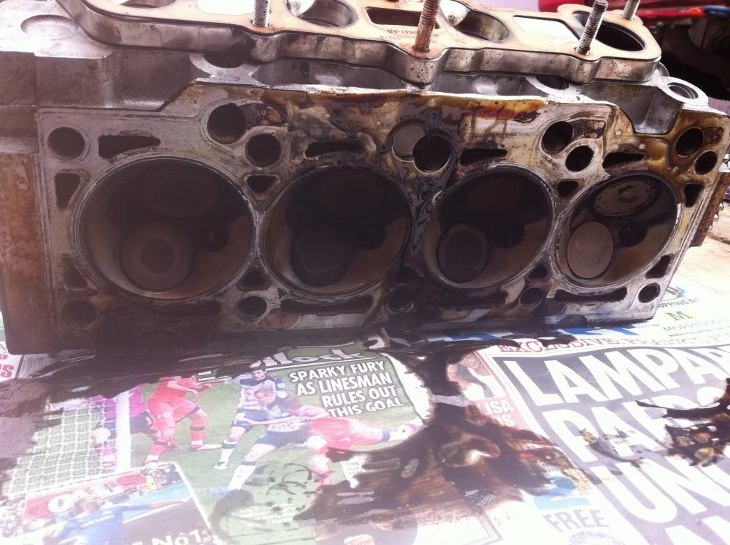

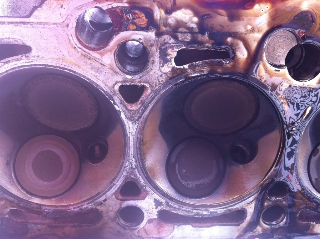

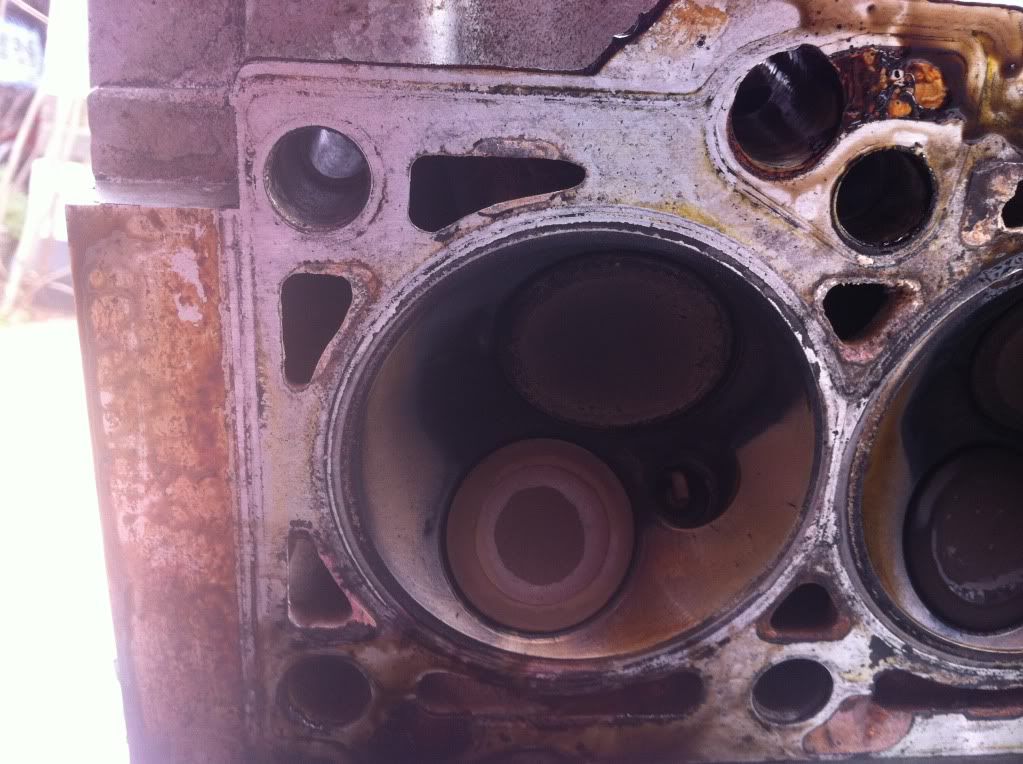

So finaly i can do some updating on here. its been a good few months since i updated an since then i have done quite abit, nothing to major but enough to keep me busy at the weekends as i dont have an inside to work in
ever since putting the engin in with the stg2 box an 6 paddle clutch i have had the problem when ever you go to pull away you get this massive judder thro the whole car coming from the box an also on the down shift you get a judder as well.
it wasn't since i asked my mate to pull forward gentely with the hand brake on i noticed the arm on top of the box the cable attaches to was vibrating up an down like a pornstar on speed
As i have never come across this prob befor i was quite confused so the first thing i wanted to no was if the box was ok so a phone call to bernnie was made at cts an then a trip up to see him. he took it for a spin did some test an turns out the box was solid an he was addiment it was the wrong relice bearing was inside. when i got the time i pulled the box of an the bearing fell out on its own
yep it was about 5mm bigger but this was just the start of the prob the hardest part was trying to find a 30.5mm bearing my first thorts was to ring up burton power as they are usaly good with this stuff and didn't wanna go to ford as they were the nob ends who gave me the wrong bearring in the first place. so after being passed around for weeks i ended up ringing burton an yep thats right they had the right one for me.
fitted the new bearring got it on the road an was lots better but still quite bad
i put it down to the 6paddle judder as the mounts are not worn an i couldnt think of anything else so i put a lid on that box an accepted it.

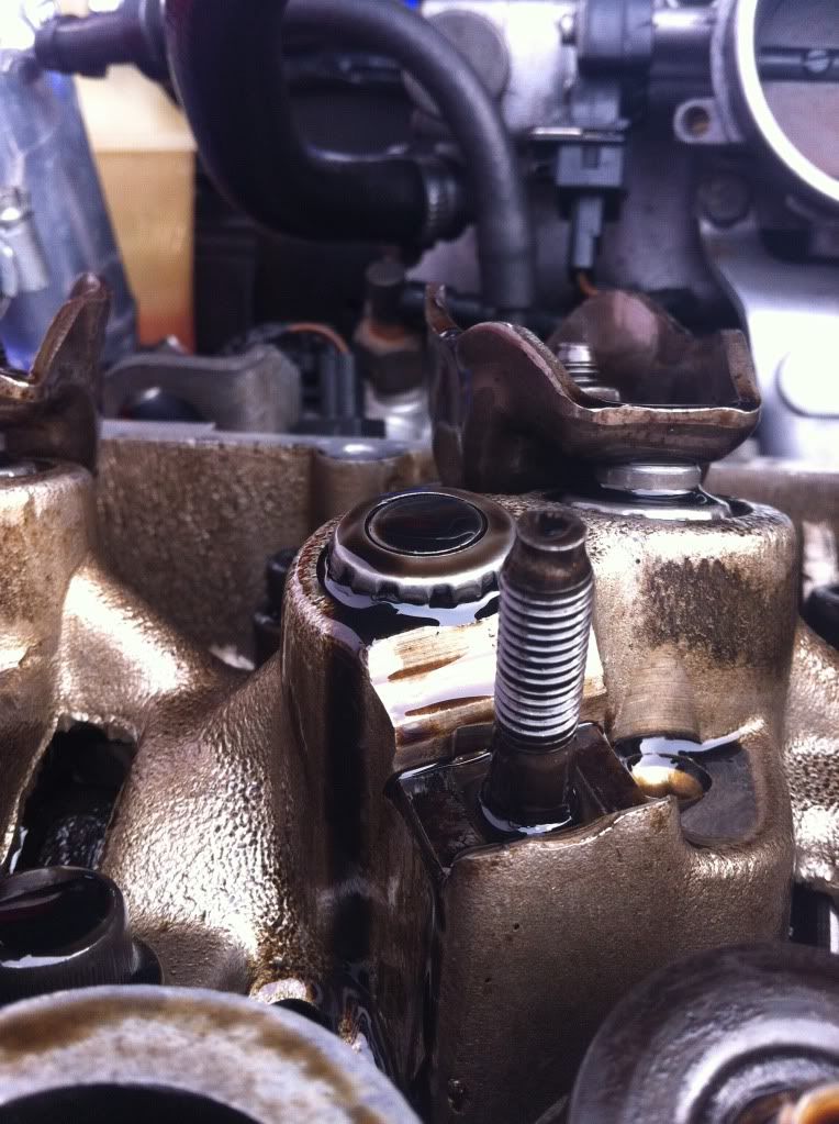

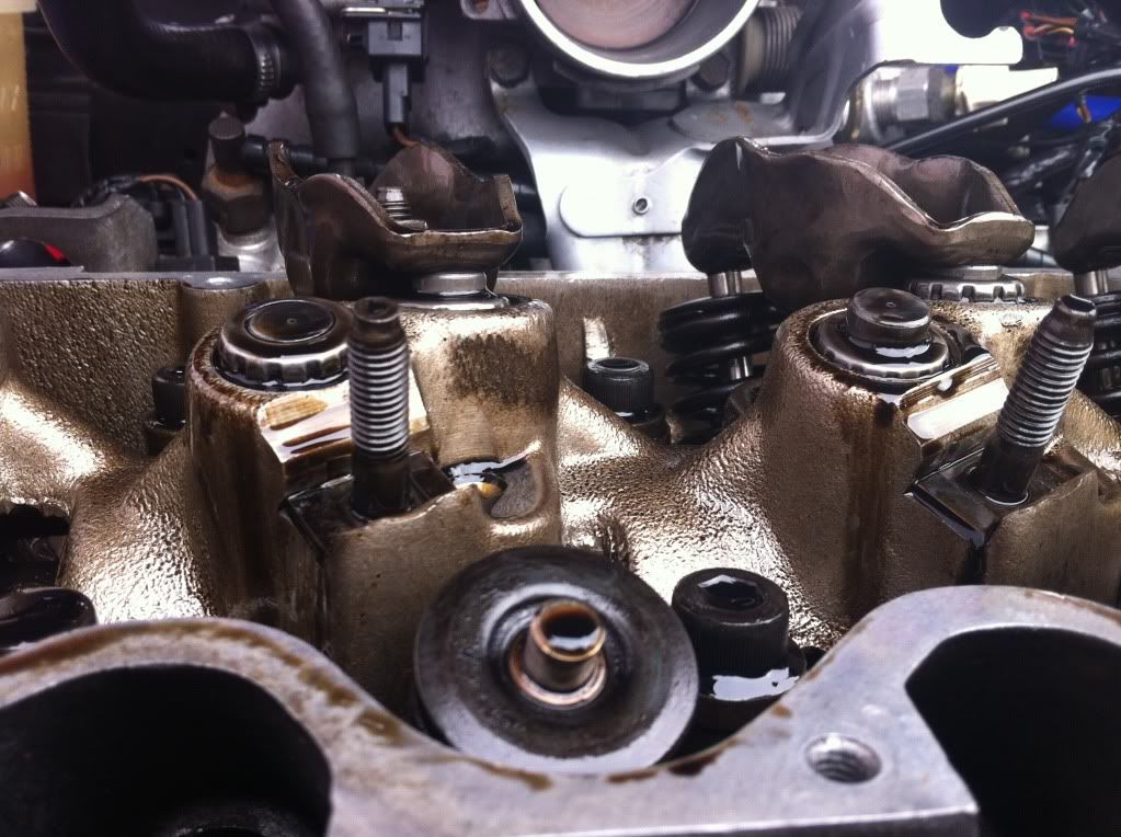

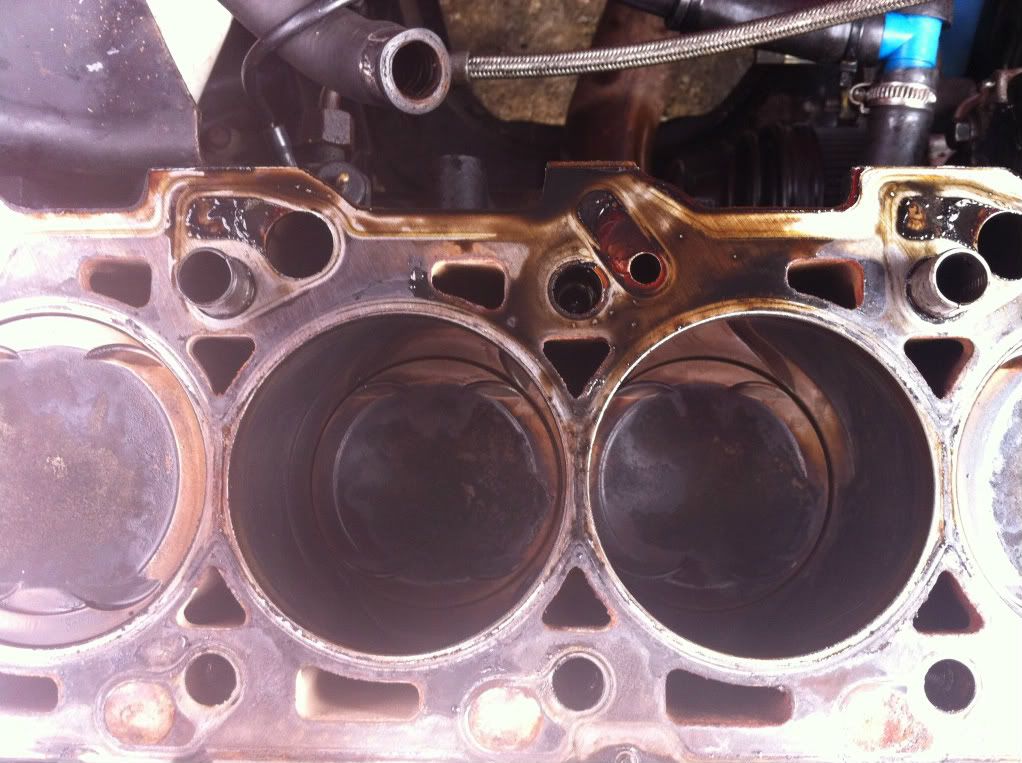

I changed my rocker cover gaskit an cleaned up around it as it was leaking but when i put a new one on it was a tad bent an must off moved abit when i fitted it as it created an bigger leak that went all over the box
( i also found that when i was doing my gear linkage the main breather pipe at the back of the block was perished from being done up to tight when i fitted the engin an was in a rush to get it done( hate being rushed) an that pissed oil out all over the back of the bay every bloody were, so replaced it cleaned up as much as possable did the rocker cover gaskit again an thats how i left it for a while as the weather has been rubbish plus was not really feeling happy when i was driving it due to the judder.

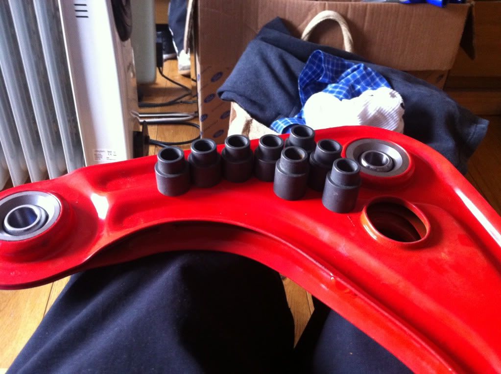

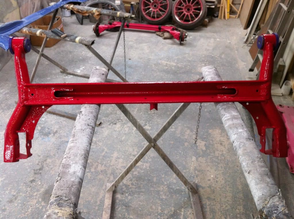

i picked up a zs rear beam ages ago and also polybushes for it so now is the time to get the beam on along with focus rear discs ( which i am gonna be using the rs2000 handbrake cable) if anyone has done this please drop me a pm as i am still after some tips.

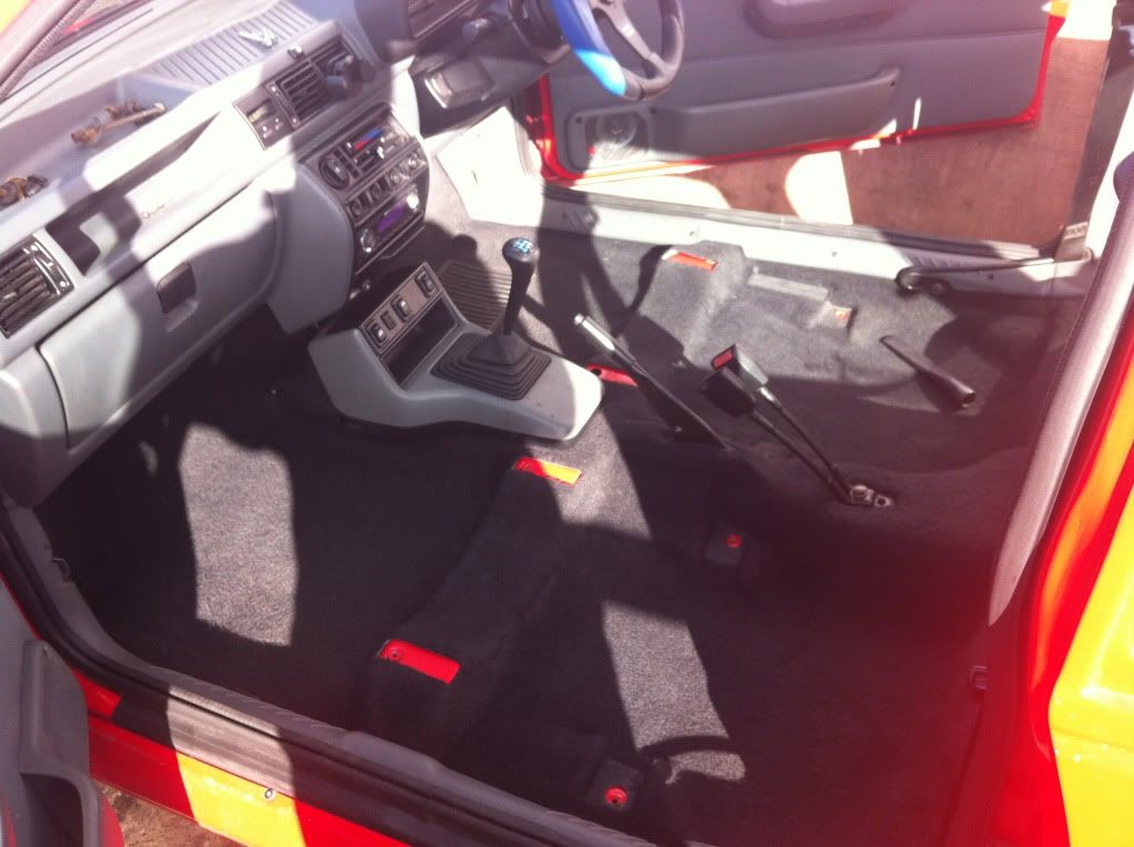

black carpit and extra black cut out carpit.

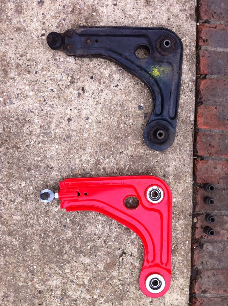

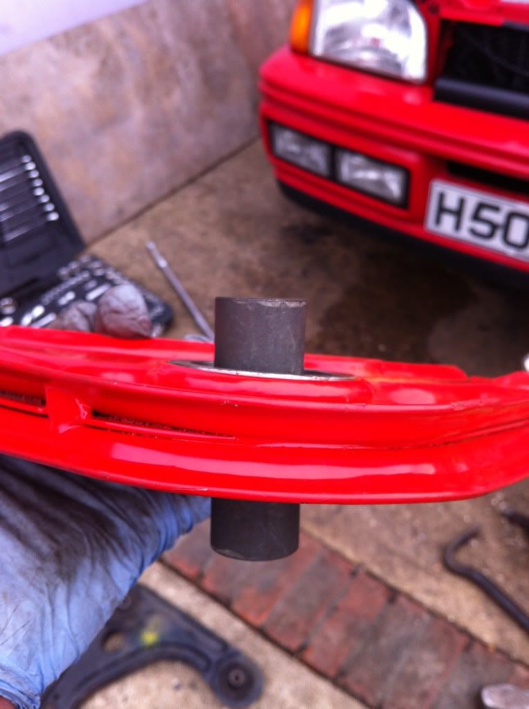

Best way of getting bushes out

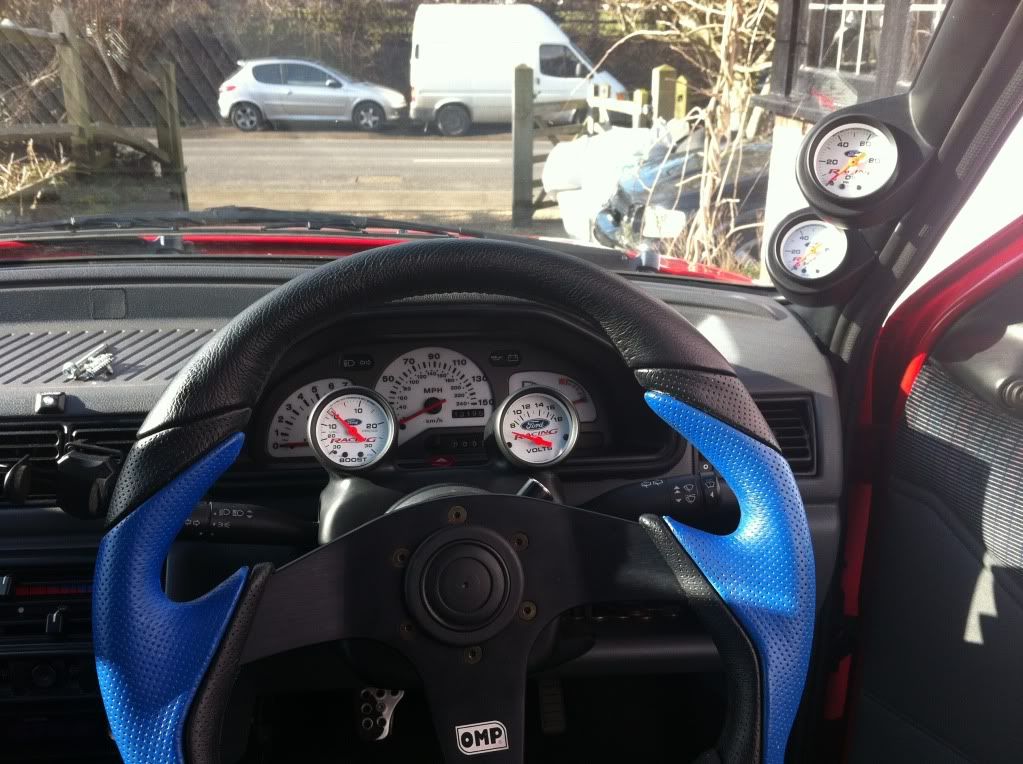

the beam just to say its not red lol crappy iphone does not do it justis
new wheel an gauges, white dials.

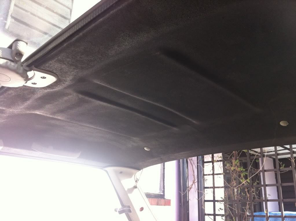

resprayed the roof lineing ages ago needs another going over but decided to put it on for now

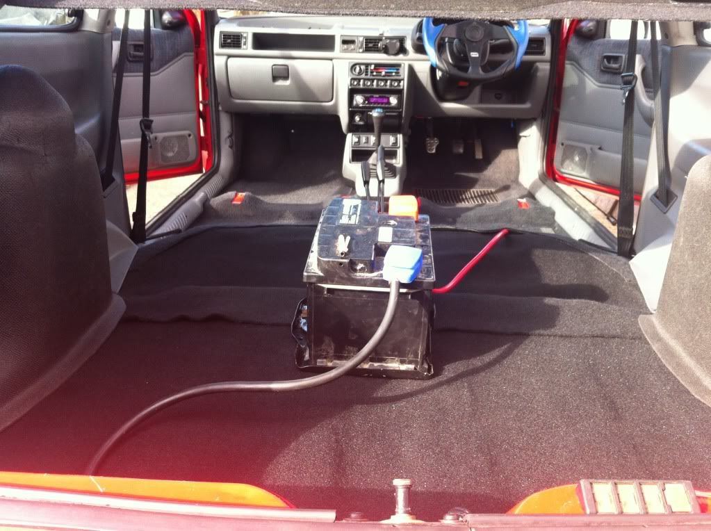

black carpit
extra black carpit the battery is not staying there.

black carpit

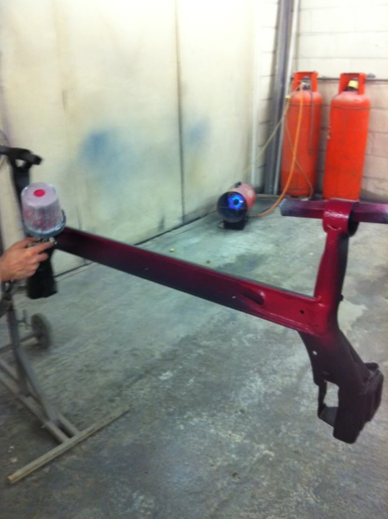

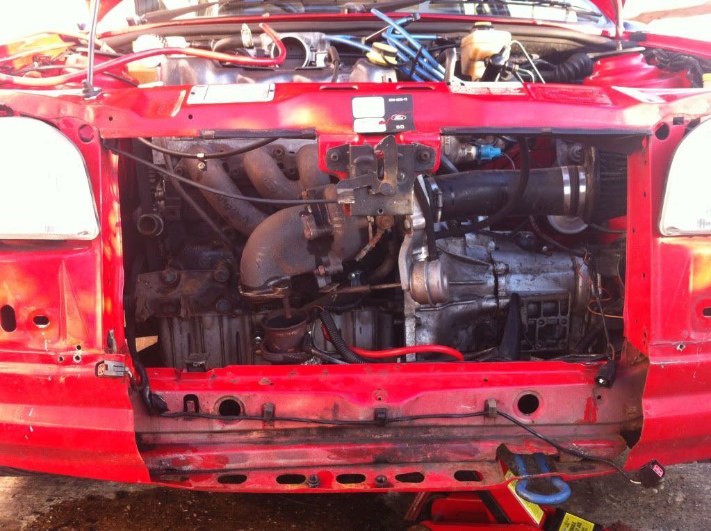

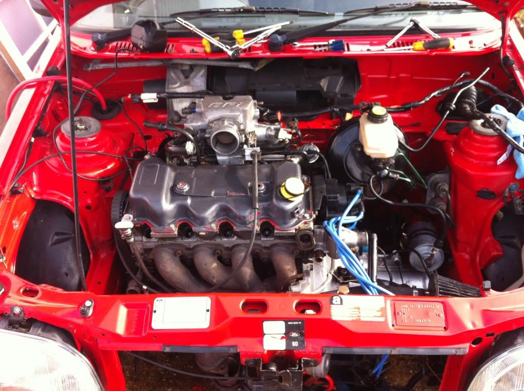

so to day was a quite a sucsesfull day the plan was to spray everywere with tardist an jet wash the whole bay an engin to give it a nice clean then tidy up the bays loom as when it was first put in it was a case of that will do just to get it done
first of i got cracking with the cleaning what ya think.
i got carried away abit like usal
stripped the whole bloody lot god knows were it all goes back lol.

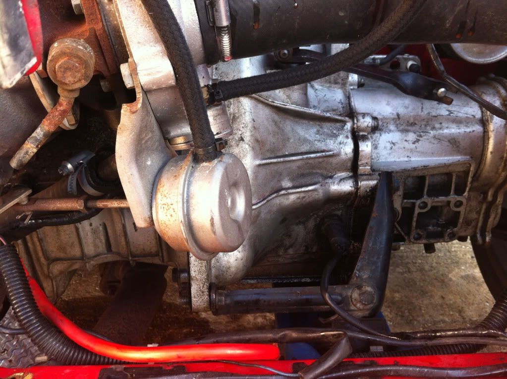

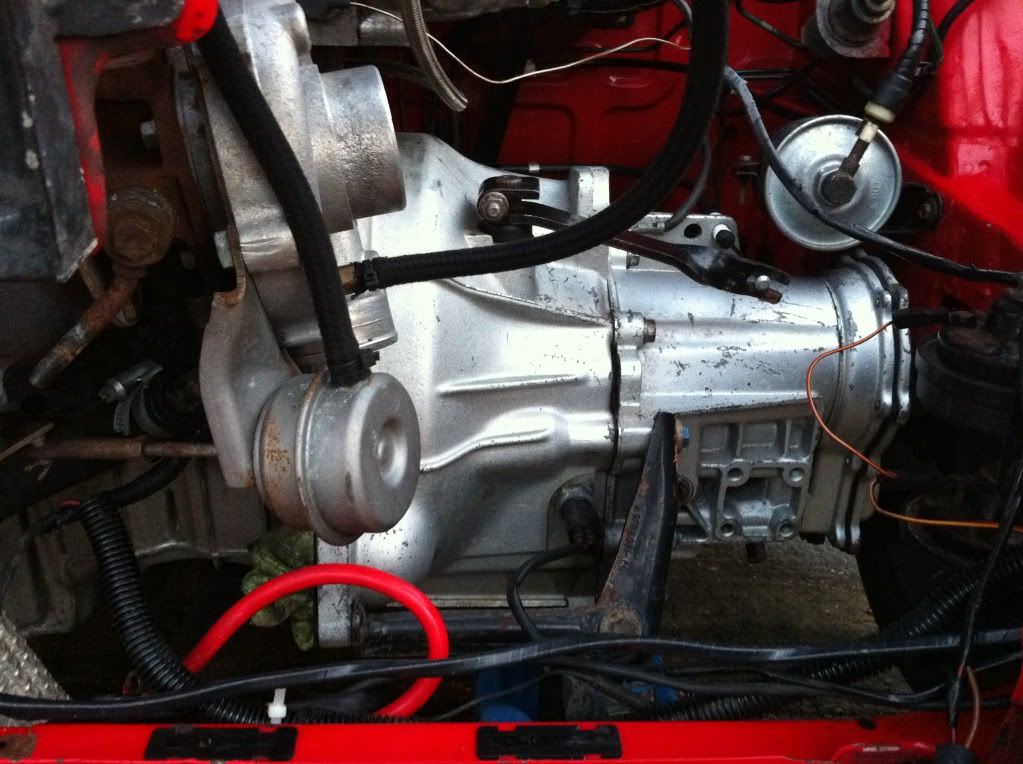

gearbox come up really good
befor
afrer
then i sorted all the loom out as it was chucked in
gonna crack on with getting it all back together to mo with the new alternator an starter cant put the hoses on yet as i am waiting for clips to arrive but lots to do an more cleaning lol

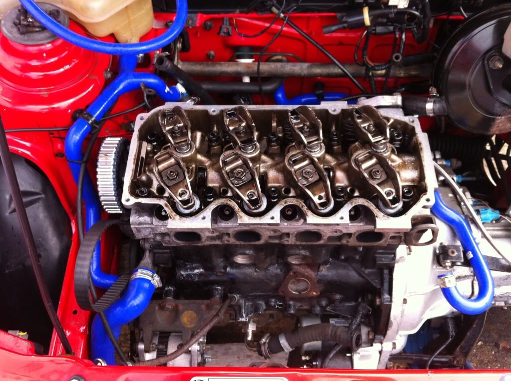

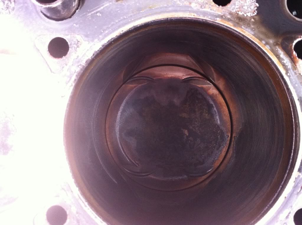

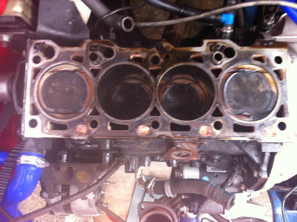

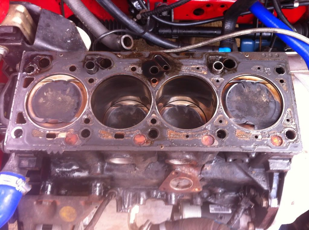

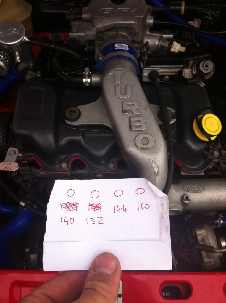

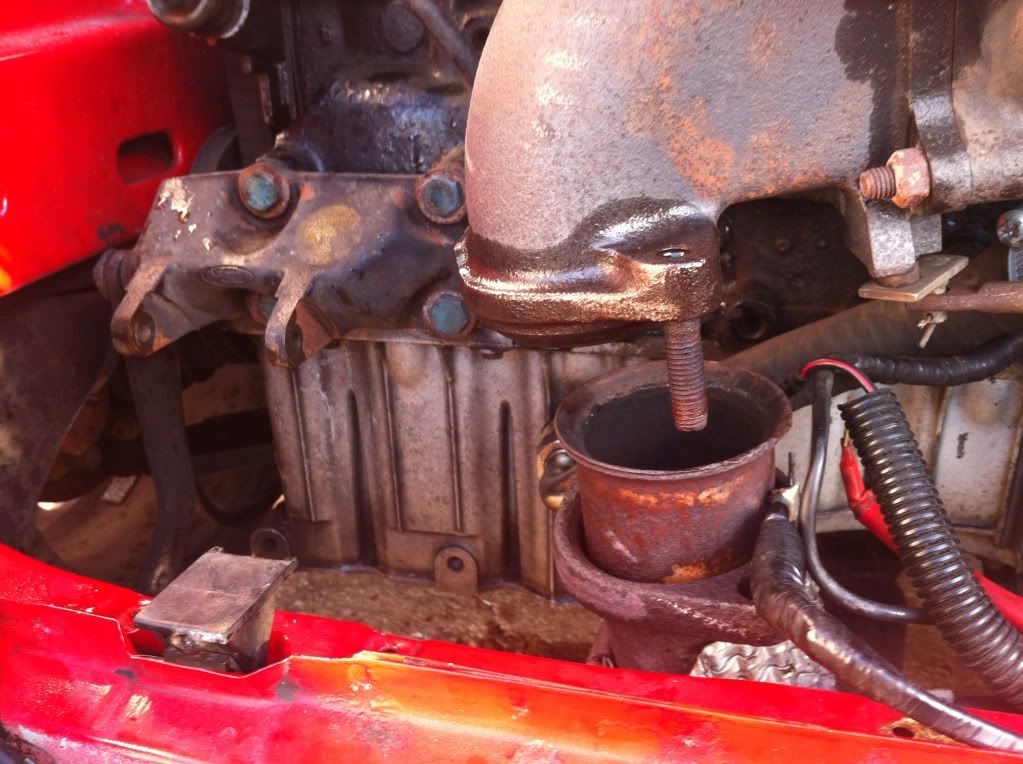

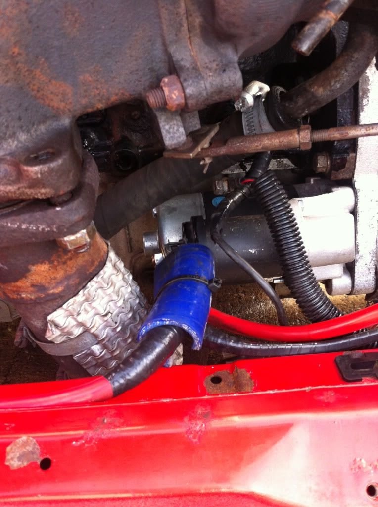

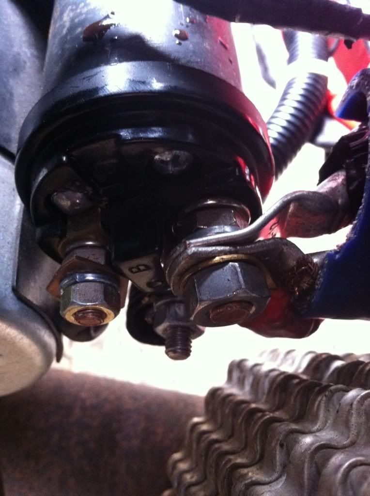

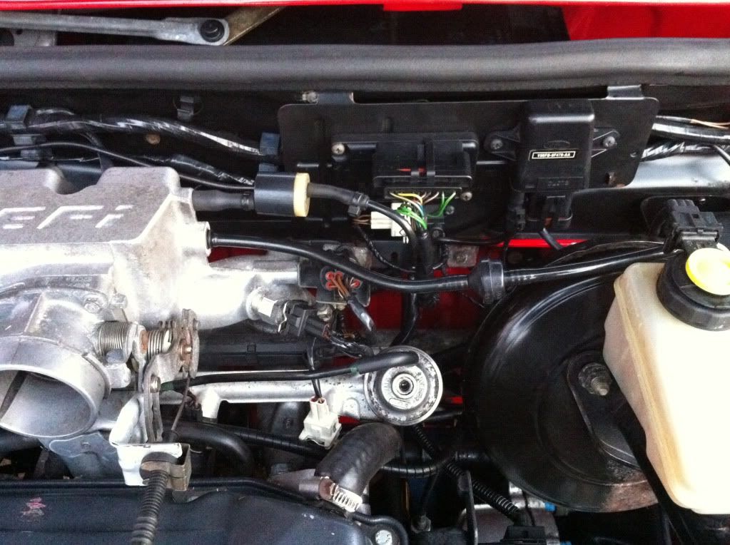

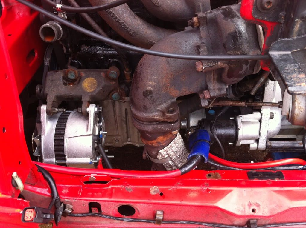

Today was a good day i got most of the bay all back together new starter motor on an alternator.
ran into a few probs an abit confused on why tho. anyways here is some pics from today
starter motor all plumbed in along with some hose to protect from the heat.

so after getting it all back together i wanted to conect the battery up so i could pop my alarm on. wel here is the prob it tried to turn over on its own!!!??
luckly the battery was flat the alarm didnt come on either so my thorts are that because the battery is flat the intelli start is trying to kick in??
thorts please guys ta.
an here is the alternator.

Are you sure youv wired up the starter motor correctly ? If there's poweer to starter its already earthed so coul turn it over..
I'm
Not insulting your intelligence iv done it before

wel tbh mate i think it is that as i have a memory like a fish lol and i have a relocated battery so all my wires are diffrent an i cant remember them for shizz.
god its anoying
god its anoying

so to day i woke up wiuth the same headache i had when i went to bed an that just made me feel like rubbish
so there was no motorvation at all today plus the weather was crap an was gonna turn anytime sooner.
what i did get done was i sorted out the prob with it turning over on its own an that was the live, earth and alternator cable which is all on the same bit of the starter wel the alternator cable was touching the black an red wire
so was arking it lol.
I craked on with the drive shafts, hubs and the lower arms but with my lack of enthusiasm i only got one side of the shafts in got the hub of polybushs in (one side). then it came to do the lower arms so i stripped it all down got the old arm out an i looked to see how the lugs go in to the combrake lower arms, now looking at it you would think "right wel them two go in there an the other two go in ther" WRONG so now i have the problem of working out which lug goes were for the arm to fit snug in.
after that as you can guess i lost all intresst packed up an went inside lol.
if anyone has fitted combrake adjustable lower arms befor please please lend me ya knowlage for abit
the starter motor fix
lower arms with both size lugs
comparison of both arms
the lugs in the joints which i thort was right
thanks
thanks

Not much Of an up date really I spoke to Dave at compbrake about the lower arms an the lugs ya get with them, wel it turns out that they were the wrong ones an are to big so I am having the right ones sent out for Monday.
Knowing that I decided to finish the rest of the jobs around the arms including changing the driveshafts, hubs an also putting in the polybush top mounts in. Got a few pics but I am updating on the IPhone lol.
What I will say is doing all this work is kinda anoying me as if I had the choose I would strip the car an start with the restoration which I am gonna be carrying out after this years shows. I can't start it now due to obveusly money an time playing a big big part espically money and also Its my only car. It was always ment for everyday use as I belive in cars are to be drivin not make a garage or track or stand look pritty
I want it for this years shows and after the last one take it of the road strip her down have the body brought back to life with my new colour have all bits powder cotted which needs to be an freshen everything all up.
Just a shame I can't do it now as I see bits of rust/ suffice rust bits that need a coat or spray of something an I can't do it until the time comes.
All sounds abit of a sob story but wanna no if anyone else has been or in the same sittuation
Thanks.

I have been busy over the past few weeks with finishing of putting everything back together and getting it back on the road for the summer.
I had the wrong lugs sent out from compbrake again
so have not been able to put the lower arms on yet. I got all the new coolent samcos on which imo looks nice an fresh
here are some pics

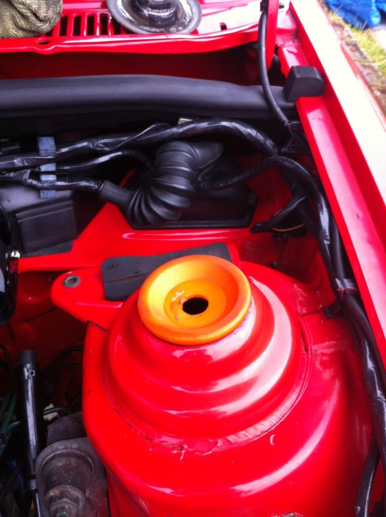

top mounts

with everything all bolted back together gave it a good clean ready for the rsoc meet
and the first time with it being back on the road and the drive up there was very intressting as i had 2 noticable problems the first being a boost problem which turned out to be a lose clamp

area but with it being a new alternator that is the confusing bit also when i floored it it would lose power (electrical).
the next day after work i decided to check out everything around the alternator befor i got dark.
First of i losened of the belt as that was very tight check both conections which were fine so took it out for a spin but still no joy

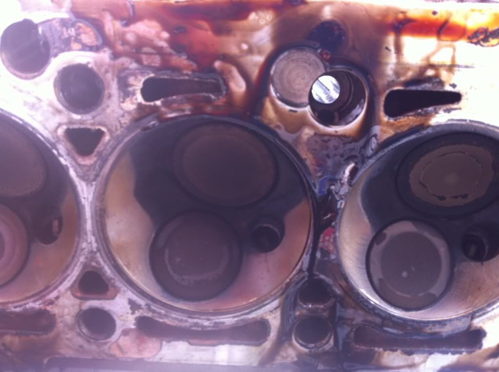

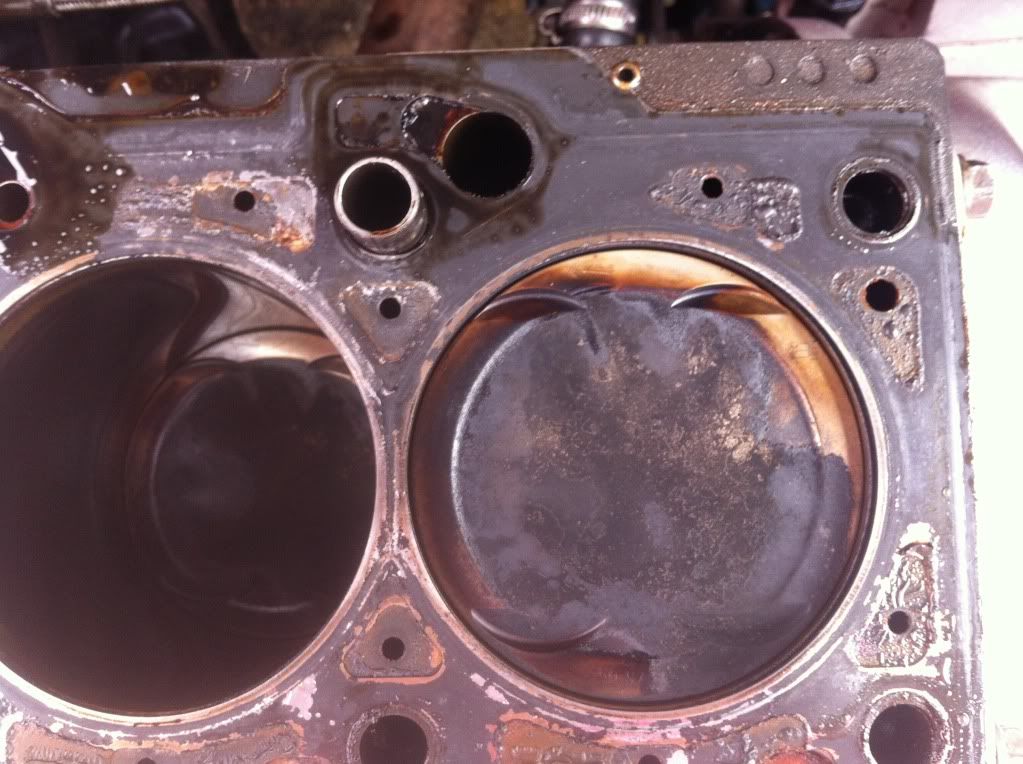

as soon as it turned over there was a loud tappety sound with also lack of compression an white smoke bellowing out of the exhaust
i limped it back to my house which was a 10 sec drive tucked it away till the weekend.

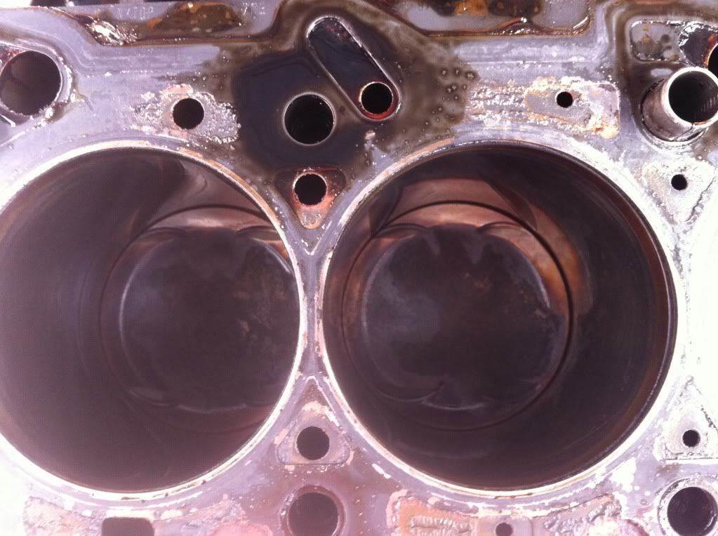

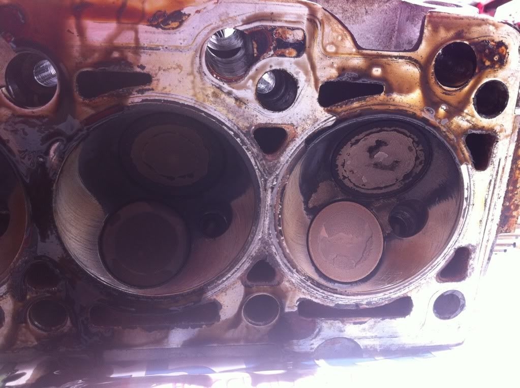

which leaves us with what i did today an what i have found. i will let the pics do the talking.
compression test first
the reason for the tappety noise
compared to the one next to it

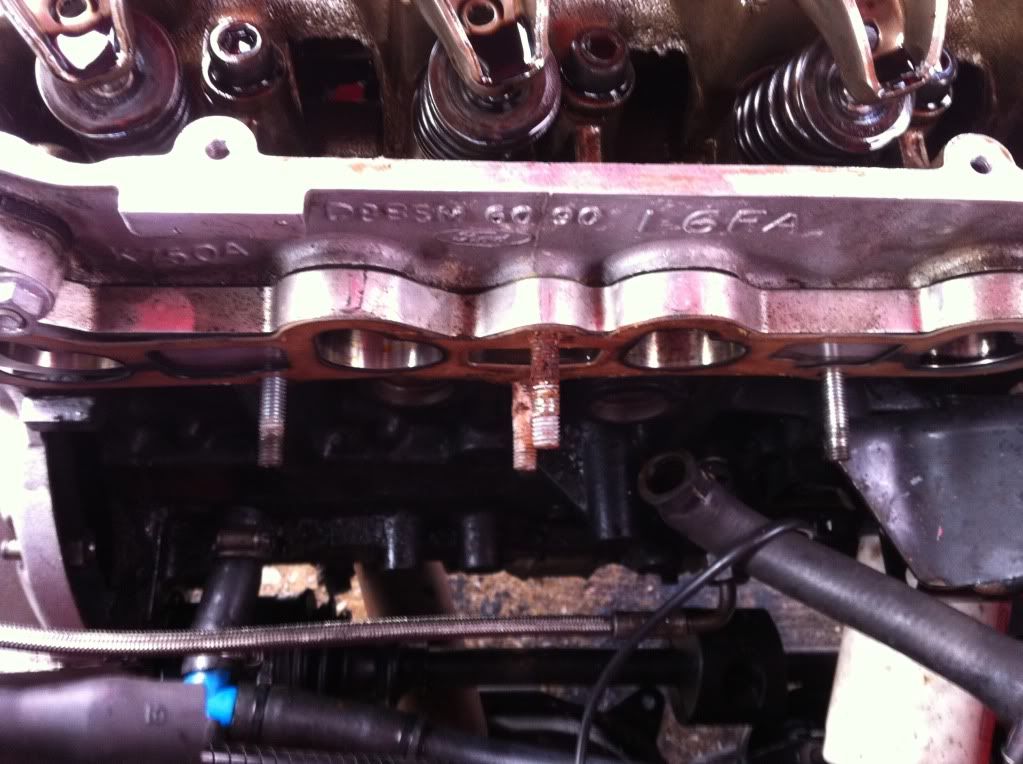

start of the strippage
adapter plate turns out i have an mfi head
first pic as soon as the head come of

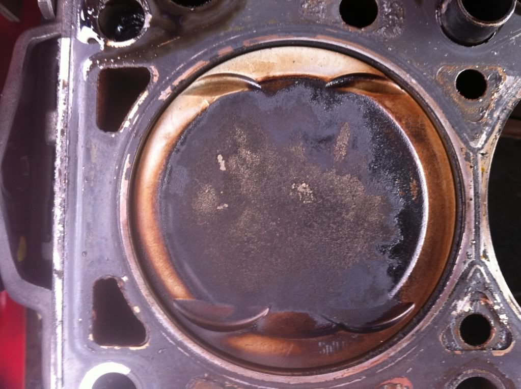

pistons an bores
send this pic to jon (FRSJON) to conferm what pistons they are an from that they are calibra red top forged pistons.
head gaskit turns out its a genuine ford st170 multi layer one
with the gaskit of
from all of these pics you can see that there are no tell tell signs of the gaskit going which is abit anoying
also spoke to ian howell an he has said the reason the liffter had been stuck is either a manufacturing fault with the lifter or oil feed issues.
i am having the head stripped by my mate to look for ware on the lobes on the cam check the vaulves are not bent ect give it all a nice clean up.
few pics of the head
if anyone spots anything i have missed please comment for me as it will all help.
pistons an bores
with the gaskit of

Tonight me an a mate checked over the head and GOOD news everything is all sound gonna get it all cleaned up also checked the cam an that is sound and it is a kent cvh35 so all good
turned out the liffter that stuck down wel it colapised inside its self so what we are gonna do is take out the lifters from the 2i head as its only done 21k never been thrashed so will give them a clean check them all over that they will
be good that way i wont need to fork out the £240 for the genuine ones or get s**t like the ones from matt crap lewis lol.
what we did find is as you see in the pics from above in the center 2 bores the vulve heads were a nice dark colour but the outer 2 bores the vulve heads were a bright sandy colour.
ollie
ollie
