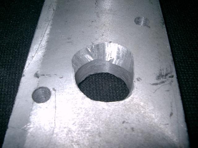

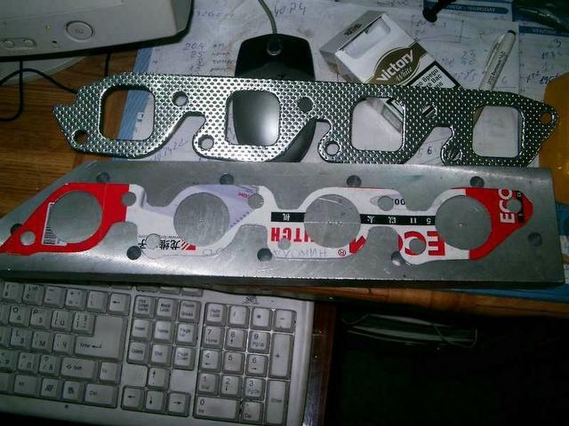

Postby Hartza on Sun May 15, 2005 8:23 pm
ERST turbo with original A/R .36 is small even for 1.6 CVH... Well, it spools up quickly, but backpressure and heat grows exponentaly if you raise boost.
I made allso an adapter plate for Zetec head for ERST manifold, and the holes don´t line up perfectly. Little porting should do the trick :) I´ll add some pictures some day.

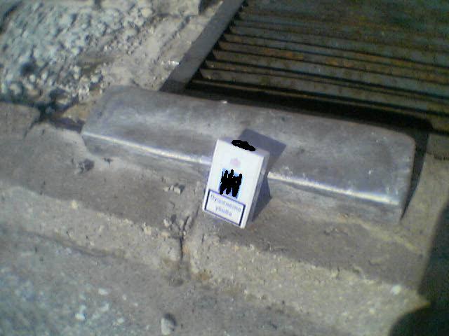

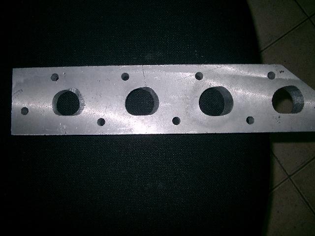

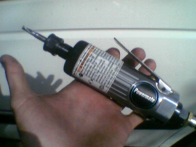

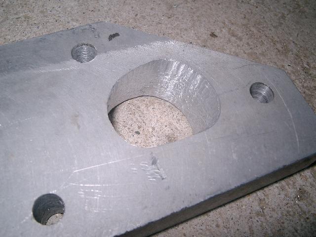

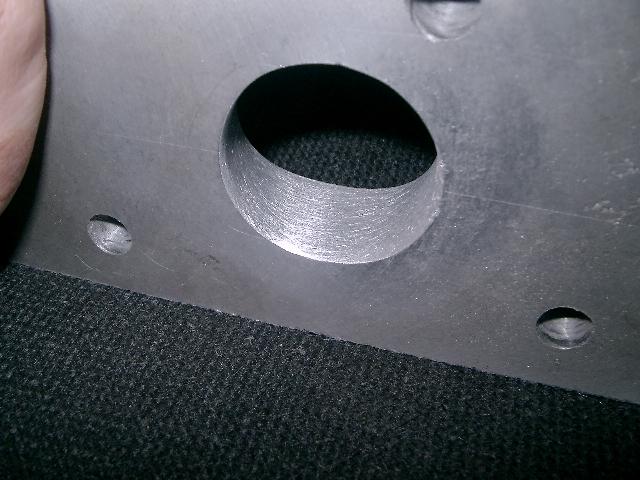

Postby disc on Mon May 16, 2005 7:52 pm
My home made adapter plate:
Solid aluminium block:
A little bit of machine work:
Ready for handwork:
Holes for head drilled:
Ports planing:
Initial port holes:
Trial fit, a lot of work needed:
Userfull tool:
Half done:
Before some sanding (head side):
More sanding needed (opposite, manifold side):
Threading:
Almost done:
Sorry for my bad english...

A better way than an adapter plate, is to machine the head. Obviously the best way is a decent manifold. Like has been ordered now by the looks! Hope to see some nice pics of that!
We did this on a zetec head, (inlet side shown).
Sorry for the thread hi-jack Mr Dragster!
With any luck your manifold will look sweet!
Steve

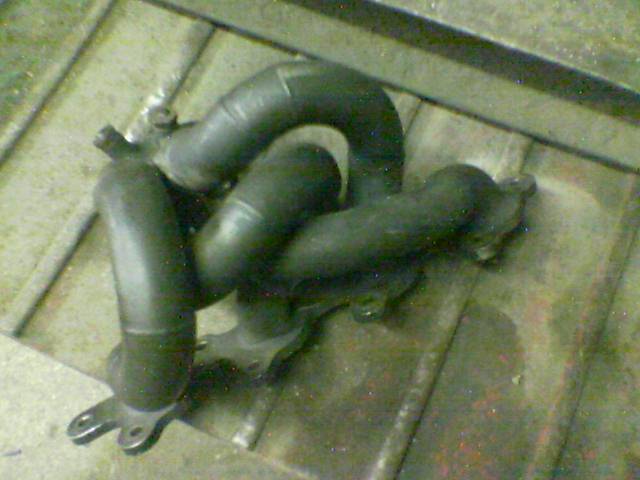

Postby Ruishy1 on Mon May 16, 2005 11:13 pm
His manifold wont look like that anyway mate :lol:
but he does have one awesome motor :wink:

Ruishy1 :His manifold wont look like that anyway mate :lol:
Ah, would I be correct in assuming its the standard manifold? Cast jobbie?

Postby StreetDragster on Tue May 17, 2005 12:18 pm
Morning Guys.
Looking good disc, yours looks like it'll work better than mine, mines steel and damn hard to cut/port out. I'm mainly changing the manifold for the addition radiator>turbo clearance i'll get.
Scort, hyjack away, i don't mind :) As Ruishy 1 said, its a cast jobby, so doesn't quite look as cool as the tubular one, which is a shame, but if you look at it from the top, its very narrow, which is great. It'll hold the turbo high and close to the block giving my fields of room between the radiator hopefully :)
Also, its looks like the weapon of choice is going to be a Disco Potato, with the 0.64 exhaust housing and the 51mm inlet pipe. Just need to do some money juggling to pay for it and then i'll look into fitting it all. I'm probably going to wrap the exhaust side and the manifold to as per Mr Hardy, should help drop ACT's a fair bit.
Probably have to alter the exhaust again though, grrrrrrrrrrrrrrr.
