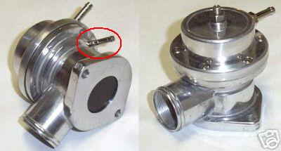

I haven't been on here for a while but the your cars looking and sounding great :D What recirculating blow off valve do you have installed mate, I'm looking for a decent one for my SX :)

Thanks Kris, I forgot you had a 200 these days :) I'm using one of Forge's recirculating dump valves, have a browse around their site to see what they have :)

heeman10 :Kris - What's up with the GReddy valve? :-? Glad you liked the vids, I expect some of yours sideways! ;)
knuckles - Grow up you twit :p
:lol: @ knuckles :D
Lol, I'll get some vids when I have someone else in the car to hold the camera :wink:
If it were an authentic GReddy valve, I wouldn't have any worries but this is a copy and I had to take the thing apart as the diaphram inside wasn't even sealing properly (saying that though, my mates HKS sequential valve had the same peoblem). The thing I like about the Greddy valve is that it has 2 nipples (another word for knuckles to laugh at :bonkers:) - One for vacuum and one for boost (one either side of the diaphram) which is apparently meant to help the valve stay closed even on high boost applications, dunno how affective it is though. I'm only running a bar boost but still..... I'll put it to the test when I change from my chargecooler to front mount intercooler :)
Kris :)

Kris - That's how boost pressure relief valves work (be it a dump valve, BOV or whatever other name it's given). They are held close by the combination of the downward force exerted by the spring and the downward pressure introduced with the inlet manifold hose (a positive pressure when on-boost). They are then opened when the throttle is lifted and that inlet manifold pressure turns negative (i.e. vacuum) and the valve is effectively sucked open from above, and helped by the positive boost pressure pushing upwards from underneath the valve in the charge pipe. And yeah, feel free to PM me about the course :)

Yeah I know that they're held closed with the spring and open on vacuum but this has 2 nipples on it. I think its to equal out the pressure changes with the diaphram so the spring doesn't have to fight as much against the boost to hold the valve shut.... God knows, Thats how I thought it was being explained to me on the SX owners club lol. :lol:

Postby krsi on Thu Oct 05, 2006 1:06 pm
Now thinking about it, it doesn't really make sence with the second nipple :-?

krsi :I think its to equal out the pressure changes with the diaphram so the spring doesn't have to fight as much against the boost to hold the valve shut....
That's rubbish matey, tell whoever told you that to read some books or something :lol: Equalising the pressure on the "topside" of the valve with respect to the pressure underneath the valve would leave the spring being the only thing holding the boost pressure in, which wouldn't be enough, and would completely negate the valve's presence :lol: Stick a pic up :)

Postby krsi on Thu Oct 05, 2006 4:29 pm
heeman10 :That's rubbish matey, tell whoever told you that to read some books or something :lol: Equalising the pressure on the "topside" of the valve with respect to the pressure underneath the valve would leave the spring being the only thing holding the boost pressure in, which wouldn't be enough, and would completely negate the valve's presence :lol: Stick a pic up :)
Hmmm... I can see what you mean and does seem strange to put another nipple on it :-?
Here's a pic mate:

Postby heeman10 on Thu Oct 05, 2006 4:32 pm
If that's nipple No. 2, where is nipple No. 1? The threaded bar at the top looks like a preload screw :-? Is it hollow??
