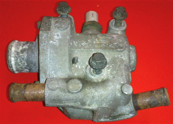

Some bits of advice I can pass on:
Zetec Thermostat housings
The two-piece series 2 Black Top Thermostat housing is pretty dire for Turbo applications as leaks are guaranteed to happen eventually, which in extreme cases has resulted in engine failures on the Mk1 FRS. The Bakelite type housing is slightly better but still succumbs to leaks eventually, so I bought an alloy Thermostat housing from eBay for £9.99. These were fitted to very early Zetecs with the yellow oil filler caps and red plug leads. I originally thought Ford were cost cutting when moving to the plastic housing, but when the alloy one turned up in the post I realised they weren't - it weighs a ton! The alloy housing combined with the alloy cam cover add an unnecessary amount of weight. I will now go for a billet Womble housing.

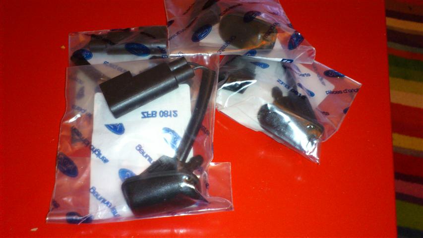

I'm fitting heated washer jets and had chosen the Escort jets which have the same type of spray pattern as the Mk3. Ford kept the same design/fitment of jet but upgraded from a jet to a spray mist for the Mk3/4 Focus, Paynes part shop currently have these for sale at £2.93 - that's new genuine Ford! Search on ebay.

Bargain heated washer jets

escort mist jets?!
really or a typo?
i retro fitted a mk4 focus jet as a tester and it doesnt sit right, and had to do plenty of chopping for it to fit the mk3 bonnet
you got a part number or ebay link?

Jon - Not Escort mist lets but the Focus version of the same jet. I had them on the Si amd all I had to do was use a Dremel to slightly enlarge the bonnet holes
Re: MWSTEWART | 500+ BHP Si Project | Under body coatings 13/09
PS just search for "ford heated jet"
