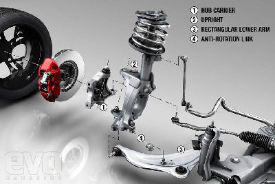

Thanks guys. Suspension and underside is next, engine will be last of all.
I'm about to order some French parts (shock!) for underneath the front end. Itching to get on with that
I would like to use Ford parts, but the Focus RS Mk2 suspension is hideously heavy and the alloy Revoknuckle hasn't made it to the new Focus yet. Interestingly I actually had a long chat with the German Ford engineer responsible for Revoknuckle, and he actually developed it for the Mk1 FRS but bean counters put an end to it! I had a look at the Mk1 FRS knuckle and it was nice light alloy. He also developed an alloy version for the Mk2 FRS but project budget dictated iron brakes, and marketing dictated large wheels, which cost too much to make lightweight, so the end result were hub loads which dictated the need for a cast iron knuckle - shame!
I want lightweight suspension and low unsprung weight so the arms and knuckle must e alloy.

Is that to imply that going for a lightweight alloy caliper setup with bells and rotors would make an alloy revoknuckle setup feasible ?
Also find the miniscule amount of travel in the illustrated coil and damper setup to be fascinating, will be interested to hear how it copes on UK spec (s**t) roads

Re: MWSTEWART | 500+ BHP Project | Screenwash Reservoir 15/08
bloody hell, which setup is that in the picture from? very complex, ball joints everywhere too!
servicing this car is gonna be so confusing
Thanks guys
Setup is from a Renault Sport Clio 200
