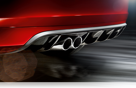

Twin tailpipes will be different!

Re: MWSTEWART | 500+ BHP Project | Rebuild 13/03
Have you thought about a rear diffuser or do you think it will look too modern. Either way awesome work fella

Thanks mate! I'm trying to keep the exterior pretty standard but I have thought about one for the bumper recess , but it will depend on how the underbody airflow management works out. I need to have a play around once the Focus subframe is in

Have you though about a rear diffuser or do you think it will look too modern. Either way awesome work fella
