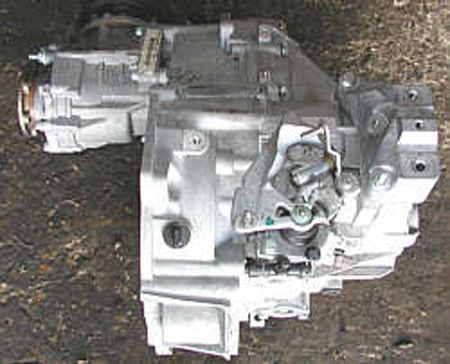

Minor update, but big change of plans.
The Focus ST box has gone to a friend, and in it's place sits (or will when it arrives!) this:
Audi 22s Quattro gearbox (TT 225). I always wanted a 4WD Fiesta from day 1, and with the power I'm expecting FWD would have been useless.
Next on the list is a decent Torsen rear diff, I want to keep diff locking mechanical rather than electrical. I'm still looking in to the various options for this, I wanted to use the Audi S4 rear but it is open as standard as the Torsen is the centre diff in that configuration (and aport of the gearbox which is longitudinal). It seems Mazda have a nice one for the MX5, but I need to know if it'll take the 500bhp the S4 one will.
EDL (Electronic diff locking) will require the use of a CAN bus network (what modern electronic systems use to communicate with each other) within the car which will take a considerable amount of time to install and integrate with mk3 switchgear. It utilises the ABS system (I am using a Mk5 4 wheel electronic system) to mimic true diff locking, however it's no where near as effective as a Torsen diff.
Pretty crap update, I should have more interesting things to add once I've made a rollover jig for the car.

good luck with the can bus its a bloody nightmare :oooh:

still sounds good, what do you mean about the jig, you turning the car upside down?

was reading about companies now mapping the Haldex couplings

Rupert - Yes I think so sir, should be the best option providing it'll fit in the RS diff carrier.
