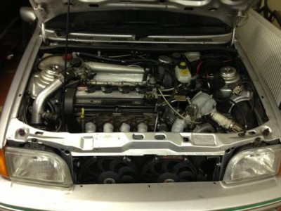

fabbed up a throttle cable bracket with some help from a friend. Had to use a different cable because of the cosworth tb, went for a sierra carb one.
the inlet just needs to be cleaned maybe a lick of paint and a new tps because that weber one is way too big!,then it will be fitted.
going to be taking the turbo off sometime this week to see what room i have with the new turbo housing and wastegate.
i dont think im going to have much room to plum it back in the downpipe ,so its looking more towards a screamer pipe.
how do you lot feel about screamer pipes? i not 100% on them too loud really.
here's the room i have now(dont watch the mess

Re: MOONDUST MONSTER update screamer pipe
Took the turbo off mocked up the new housing and wastegate and only got room for a screamer exiting where the screenwash bottle was.
the washer bottle will be relocated in the boot or somewhere i can find space.
