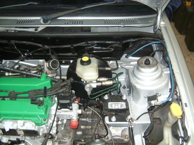

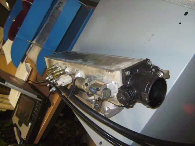

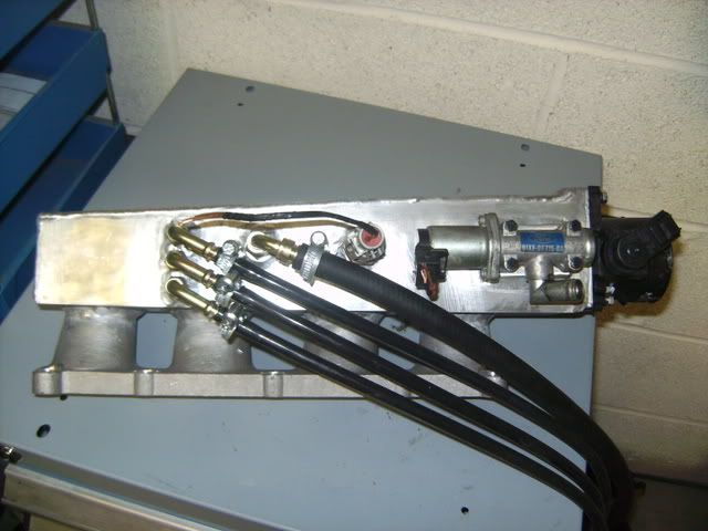

At long last - the inlet plenum is finished! :D Here's a pic of how the underside looks, (busy!!) :oooh:
As you can see, all the unsightly stuff is tucked out the way so that it's all clean and simple from the top.
Bonnet still closes, even with the throttle body and cable fitted (thank fcuk! :oooh: )

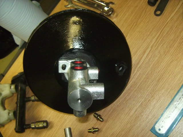

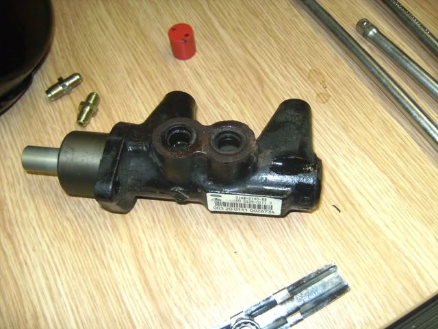

The eagle-eyed amongst you will have seen that the Escort MK5 servo & master cylinder are now fitted too :)
Originally, the RS2000 MK5 servo came with this 2-outlet master cylinder, useable but a pain in the arse due to the fact T-pieces would need making...
On Ebay I managed to win a MK5 "4-outlet" master cylinder for £5.00! :Q Here it is fitted to the RS2000 Servo (the rear part of the cylinders are identical).
Here it is fitted to the car.

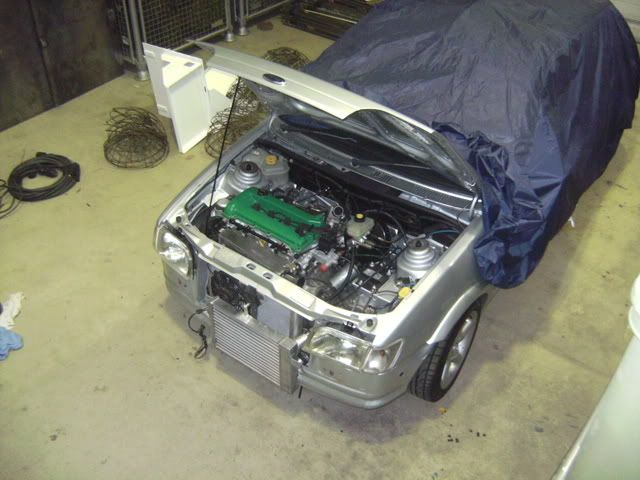

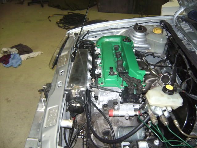

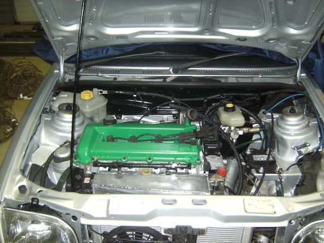

Some of you will have noticed that I've started to fit the intercooler, it's a Radtec S2 Escort item that a friend in the Army gave to me in return for a couple of beers! :oooh:
Mick and I modified the pipe outlet positions and angles slightly to allow it to miss the Fiesta front crossmember and get is as central as possible. I've already removed whatever metal I needed from the front panel (that was bloody new as well! :rolleyes: ) just need to knock up a couple of brackets then get the bumper sorted. It's postioned so that the top of the intercooler sits just below the top edge of the bumper (doesn't protrude through) but I am going to enlarge the hole above the numberplate downwards and move the numberplate down to the bottom (as per Heeman10's car), cheers for the inspiration James! :wink:
Any advice/photos of how to enlarge the hole in the front bumper much appreciated, Jim. :)

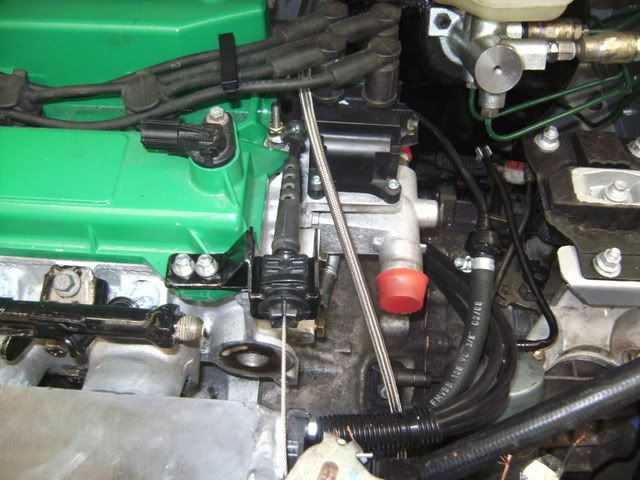

In my lunch hour today I sorted the throttle cable bracket, with a friend pressing the loud pedal I checked it moves through its full range and shuts fully, as you can see it's now fitted :)

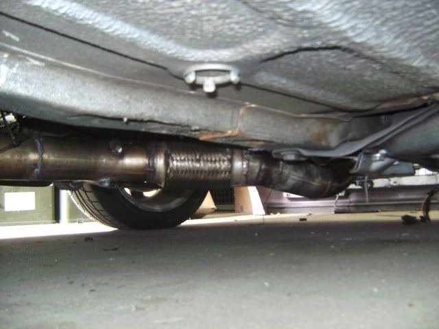

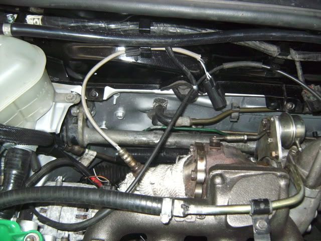

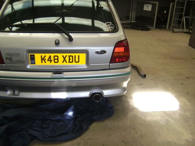

Started fitting some of the Mongoose FRST system too, the pic shows the rear part and centre section are dangling down pathetically at the moment! :rolleyes: :P I dummy-fitted it all with the front section as well just to gauge how much i need to remove from the front section (the Duratec exhaust is on the back of the engine unlike CVH/Zetec lumps where it is at the front). It's looking like around 400mm needs removing but I'll do a lot more measuring/fitting just to get it perfect, then it's going to be assembled by my mate Mick :)

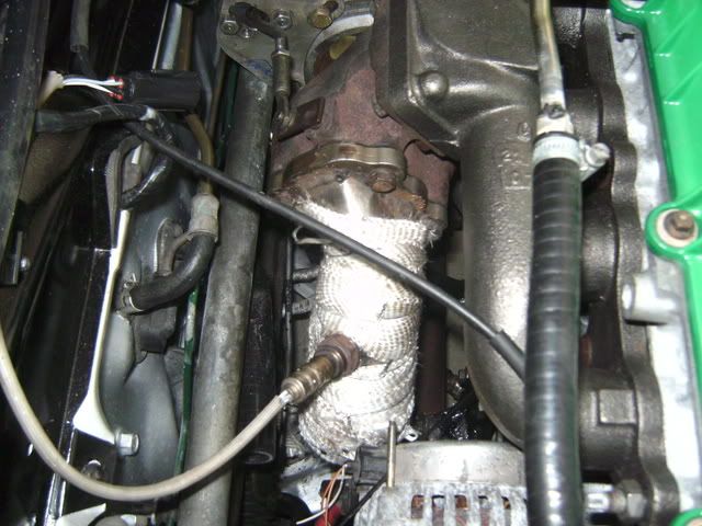

I've ordered a Garrett GT28 5-Bolt stainless exhaust flange plate, a lamda boss and some 2.5" stainless pipe bends etc so we will be making up a new downpipe in-house before making it fit the Mongoose system as soon as it all arrives...
Also ordered a load of black silicone universal bends, reducers, joiners, ect for making up the coolant hoses - should be here in the next couple of days hopefully.

Made some brake hoses up at work today for the RS2000 rear calipers and fitted them - also continued sorting the exhaust side of things. It's really starting to come together now - just wish I was rich as I'd get it done by the end of the month! :bonkers:
As it stands with the house move (greedy solictors' fees etc :x :rolleyes: ) and my impending short-term move to Catterick it's put the completion of the car back a couple of months - most likely July/Aug time now :(

Had an epic afternoon/night of working on the Car yesterday.
After nipping home at lunch I was happy to find a nice Japanese Flange on my door mat! :P
Seriously, it was a stainless Garrett GT28 5-bolt exhaust discharge flange that I had ordered on Ebay from Japan. I also had some 90 & 45 degree 2.5" exhaust bends at work, along with a stainless Lambda boss. Together with the FRST Mongoose downpipe/front section I had to get it to fit the rest of the car! :aaah:
By about midnight the car had a full exhaust system from the engine all the way to the tailpipe :Q The centre section and back box are normal FRST Mongoose items with the 3.5" inward-rolled tailpipe. The front section and downpipe have been extensively modified to fit my back-to-front engine. The downpipe has also been fully wrapped with exhaust heat-wrap but I still need to protect all the vulnerable areas of the bulkhead with aluminised matting/tape (£££ :rolleyes: ).
Silicone hoses have been arriving daily so I'm slowly getting the coolant & boost plumbing done :)
I'll take my camera into work next time :wink:

Re: MK3 2.3 Duratec-Turbo. 07/03/09
Postby jimmyesh on Sun Mar 08, 2009 4:13 pm
Here's the pics that I should have taken on Friday! :) I know it's not the prettiest pipe ever but I had to do it all myself as my skilled welder friend was away :( I know I could have just towed it somewhere and given someone a fat wedge of cash for the priveledge but that's not what this car is about :wink:

Re: MK3 2.3 Duratec-Turbo. Exhaust Finshed! 08/03/09
Postby muz on Sun Mar 08, 2009 6:42 pm
Are you going to attack the floor at some point and bufty that up? Looking good as always.
muz
Posts: 2596
Postby jimmyesh on Sun Mar 08, 2009 6:57 pm
muz :Are you going to attack the floor at some point and bufty that up? Looking good as always.
Cheers Muz, yeah when I get the time I'll spruce that up a bit - although not in a "bufty" kind of way! :oooh: It'll be more just rubbing down any exposed areas and painting them to safeguard against corrosion. I've already been around the underside of the sills/rear/front valences etc. Just got a lot more to get finished before I can do "tidying-up" jobs such as that :)
