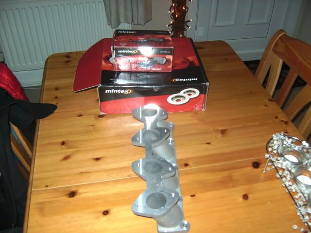

Postby jimmyesh on Mon Feb 09, 2009 8:57 pm
Hi everyone, just a quick post to say that the project is still very much moving along and I'll have some pics posted up here soon of some new updates :)
As I showed a few weeks ago, the Caterham Cosworth inlet plenum was just WAAAY too big to have even the smallest hope of fitting in what's left of my engine bay :cry: . As a result I sold it on ebay for near enough what I paid then set about designing and fabricating a custom compact aluminum plenum that's more suitable for my needs.
There's only about 7.5" room between the face of the head and the rad/slam panel, so I'm aiming to keep the depth of the plenum to 6.5" to allow room for movement etc, also as it's located right at the front of the 'bay it can't protrude too high as the bonnet won't shut! :oooh:
I'm using 4" X 4" section 400mm long aluminium extruded tube for the main plenum body (I cut this to size today) and have already made a throttle body mounting plate for the end, complete with time-sert steel m6 threads. This is housing the standard 2.3 Duratec 65mm throttle body. I've also ordered a twin DCOE/Throttle bodies Duratec inlet manifold from ebay which is going to be TIG welded to my plenum as soon as it arrives! :D
Still got mock-up where the throttle cable bracket will be welded on and where I'm putting the vacuum take-offs etc but hopefully it'll come together.
Also have some front brakes now in the form of Esc Cos calipers & discs which should work well behind my 15's :)
Bye for now, next time I'll have pics - I promise! :bonkers:

Here's what landed on the doorstep today, I've been waiting for that manifold so that I can get the inlet fabricated - mega happy that it's turned up :)
The discs and pads are just standard Escort Cosworth 280mm items to go with the Esc Cos calipers that arrived the other day. I'm not into fancy drilled/grooved stuff as my car is a primarily road-going civilised beast! :lol:
