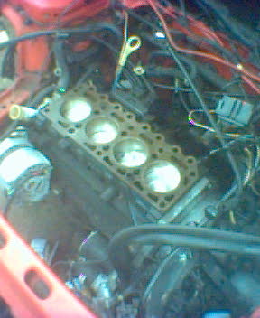

When I had the head of my car off, I am sure the pistons were flat at the top?
Picture:

Postby Liebo on Mon Apr 26, 2004 6:24 pm
Look at the pic of my engine.
Looks like mine have flat tops?
Wasnt you saying the Endura-E had flat tops?
Mine is a CFi model so wouldnt this be closer to the Endura-E type engine than maybe the Mk2 fiesta OHV engine in earlier Mk3 fiestas (manual choke, non-ecu)

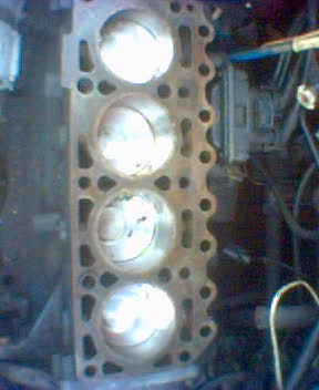

Postby jdfiesta on Mon Apr 26, 2004 6:27 pm
this is what my pistons look like, as of 10 minutes ago
spot the recess

Postby Liebo on Mon Apr 26, 2004 6:34 pm
I had those.
Those are nice clean pistons :D
Engine seems great.

Postby 8skellerns on Mon Apr 26, 2004 6:45 pm
jdfiesta :this is what my pistons look like, as of 10 minutes ago
spot the recess
JJ
Looks the same as my 1994 block pistons. Those pistons have definitely been cleaned though. No engine has pistons that clean if the engine has been used.

Postby jdfiesta on Mon Apr 26, 2004 6:46 pm
here's some more pics, yeah them pistons are nice and clean.
don't know if it being stood for a bit does it any harm though
jj
