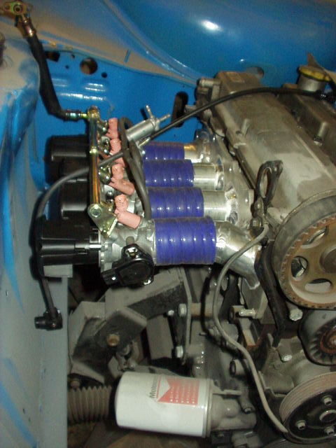

In the meantime, I have just bought these to go on.....
Should fit on like this....
They are off a Kawasaki ZX636 and are 38mm.
Dunno when I will get round to fitting em!

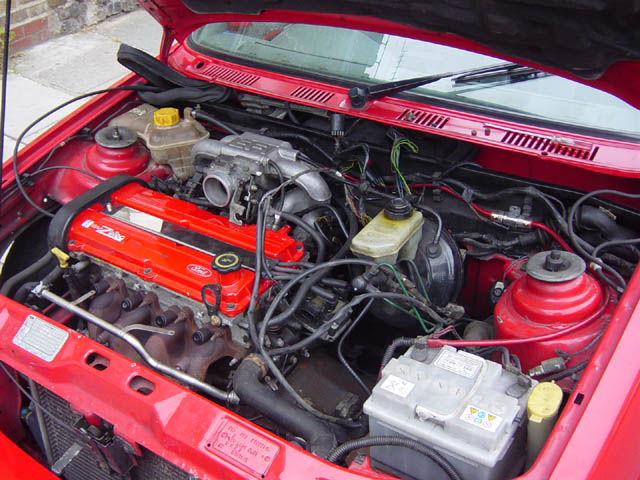

Ok, another update!
I decided to fit a 16v loom over the weekend.
And at the same time I decided to remove the EGR.
3 of the ports were easy to get off....but in typical fashion, 1 was a Bic™!
It took a bit of effort, in which time I actually distorted the nut. In the end, I used a drift to spin it. Once off, I used the blanking plugs.
Here it is removed: -
Then I got onto removing the old 8v Loom and fitting the sub loom:-
It wasnt too difficult, with me amazingly remembering what connectors went where!
Heres the main loom fitted, with just the O2 wires to route:-
I also fitted a new O2 sensor and wired it up. A lot easier than I thought.

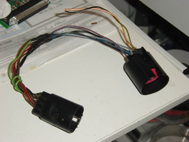

Now, as my car was originally an 8v, the car loom connector is incompatible with the 16v engine connector. I could have cut the connector off the engine side of things, but I didnt really want to start hacking at the loom.
I decided the best course of action was to make an adaptor plug:-
Left hand side is for 16v loom, right hand for 8v.
Quite proud of it! Just need to run a wire to Fuel relay for the HEGO sensor.

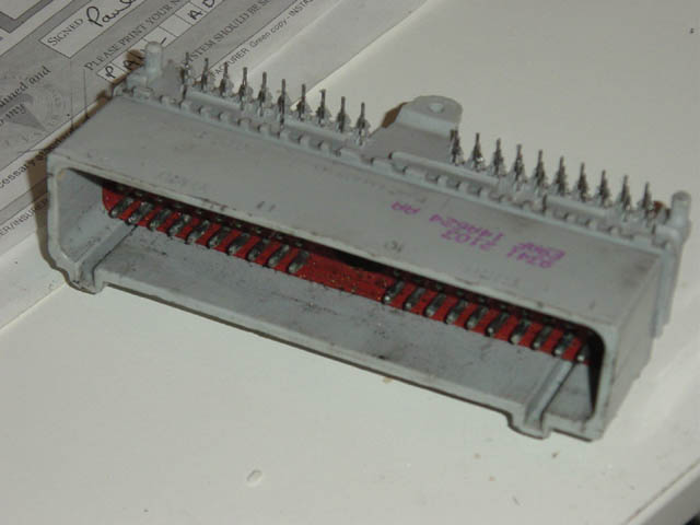

Firstly, I modded the megasquirt to run the Ford Idle valve. This required a resistor and transistor to be replaced.
I was in two minds as to how to connect between the Ford wires and the Megasquirt.
I actually started to solder wires to the db37 connector but decided this was the way to proceed:-

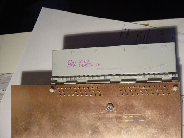

I got the ECU connector and got a piece of Copper clad board:-
You might notice that i managed to get it the wrong way round! LOL
Heres the correct one! :-
Im basically gonna make my own PCB with the Ford ECU connector on one end and the DB37 connector on the other.
Here is some practice with the wrong PCB!
And here is a design I made :-
Once im happy with the design and get a Female DB37 connector, im gonna use etching solution and make the board. Then it should just be a case of plugging in the board!
Asad
