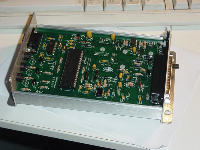

Okay lads! Here it is!
Sitting in case everything done!:-
This side will connect to engine loom, and you can see the MAP sensor inlet:-
This side has the laptop/pc connector. The LEDs are Injector firing, Fast Idle and Acceleration Adjustment :-
Case cover is on and all sealed up! :-

Phew! Easy part is over, now begins learning how to tune!
First though, i need to decide which direction to take with the loom. Use my existing 8v? Get 16V external EDIS?
Oh, and the MAP sensor can take up to 2.5 Bar
