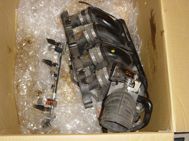

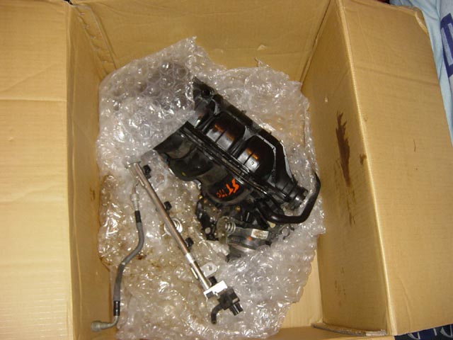

Right,
This was waiting for me when I got home! Big Box!
Fuel rail was seperate and a little oily :-
And heres a better pic of the rubber pipes, with the fuel rail off :-
Im not sure it will clear the brake bar or not... but will check later.
Plus, the Kawasaki TBs I have will not space out easily too fit.
So I'm gonna put them up for sale and try and source some with 90mm centres!
Asad

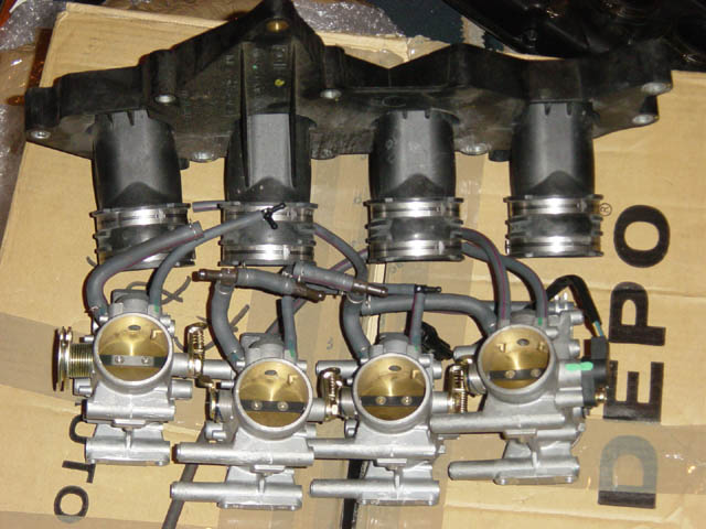

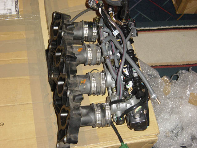

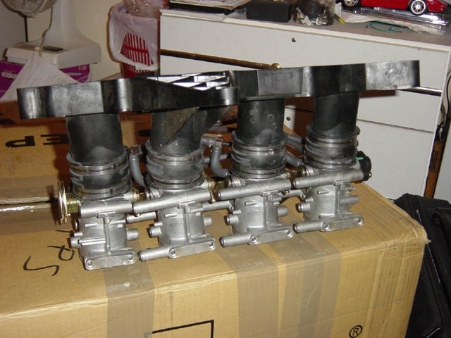

These arrived today!
Close up:-
Airbox removed!
Here its lined up next to the ST170 inlet:-
You can see its not centred:-
I then stripped all the bits I dont need, secondary butterflies etc :-
Here they are split up :-
And with the ST170 inlet sitting on them! :-
Back view :-
Will hopefully get a bit done this week and on the weekend. Need to size spacers etc.
I want to get them on and running before Trax, but I'm not sure if I will as I may be going away for work.
Asad

I will be using the ST170 manifold after all, with an adaptor to improve air flow. Pics later.
All that will remain is a decent exhaust manifold
Then another trip to the rollers for a setup.
