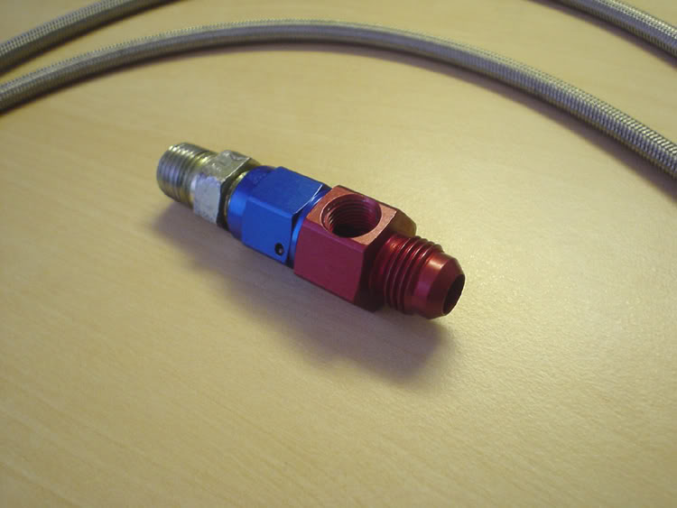

Lee @ Fusion ended up sourcing that oil feed adaptor for me.
Also, have you retained just the single breather on the cam cover, or is there an additional one I haven't see? Mark had a second welded to the one on my old engine, which wasn't the worst idea IMO. If you DO plan of adding one, don't put it where mine was. The emulsified oil used to run back down the port (which was vertical, and not above any baffles) and drop onto the camshaft beneath it. Oil + water + camshaft isn't beneficial!
