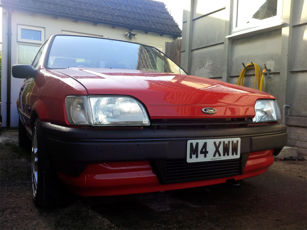

That's the neatest positioning I've ever seen of a cooler fitted that way. It's a shame about the bonnet catch; couldn't you fabricate a brace piece that goes behind the intercooler?

Excursion :That's the neatest positioning I've ever seen of a cooler fitted that way. It's a shame about the bonnet catch; couldn't you fabricate a brace piece that goes behind the intercooler?
Thanks Mark, The rad will be right up high so Its not going to happen. The 'hook' on the bonnet hits the rad too so this will be removed.

could paint the aerocatches red so they blend in better? :)
looks very neat!

So so impressed with how you've done the intercooler and valance! :D

jonyb4 :could paint the aerocatches red so they blend in better? :)
I thought about it, but it may look really ropey. There will be enough black on the car so should look OK.

Epic, looks like a double capacity??

jonyb4 :Epic, looks like a double capacity??
What do you mean?

looks very "thick" as in deep/depth

Looks standard depth to me. It's a single-pass cooler though so that might be why it looks deeper than some.

Yea its just 60mm or so thick.

One again a great looking car from Max with some very individual touches, loving that ic & cutout. :Q

Looks good max, nice attention to the cut out :Q
Re: M4X WW - ZT Project [Rad & Cooler on!]
Postby dontpannic on Tue May 14, 2013 2:39 pm
The thing that impresses me the most is the rubber seal around the cutout on the valance. Perfection.

Sheriff Burman :The thing that impresses me the most is the rubber seal around the cutout on the valance. Perfection.
Its just a bit of genuine Ford (!) vac hose that I got from TompeteRS for £1 a few years back that has been split down one side 8)

Thats a SERIOUSLY well hidden front mount :Q :Q

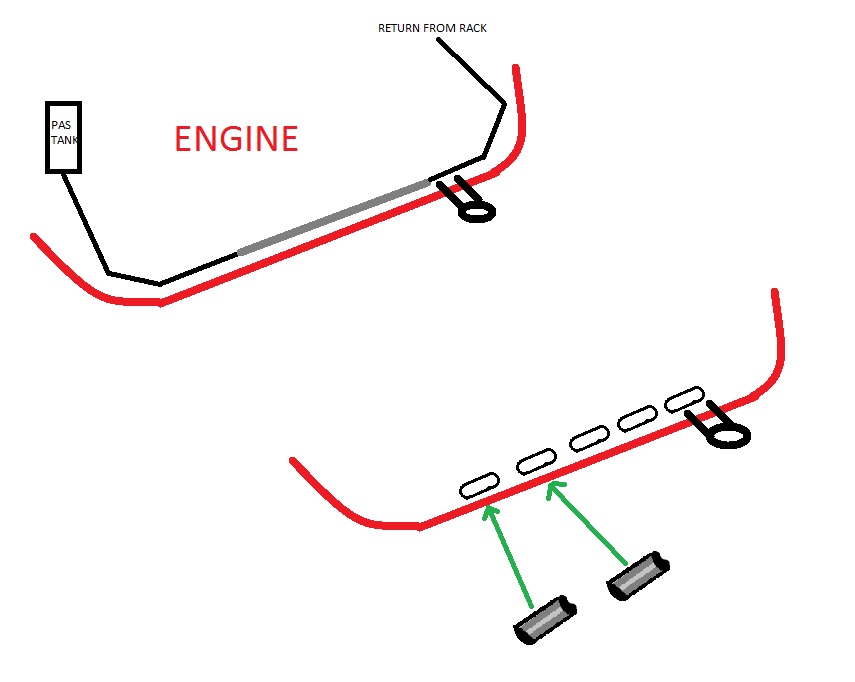

Thanks all, so to aid with my PAS cooler fitted above (with no air flow) I want to try and direct a bit of air through the holes in the valance.
I've 'illustrated' this in the attached mess - but basically I need to think of some small plastic items that I can attach to use as small ducts. They need to be a sort of 1/4 circle size - not thought of anything yet but there must be something kicking around I can use. Cut up plastic drain pipe or similar!

Have a Ganda around b&q or a builders merchant, look at the wall, cavity, and roof/soffit vents, might find something that would do the trick.
Failing that make a mould and make ya own from fibreglass
