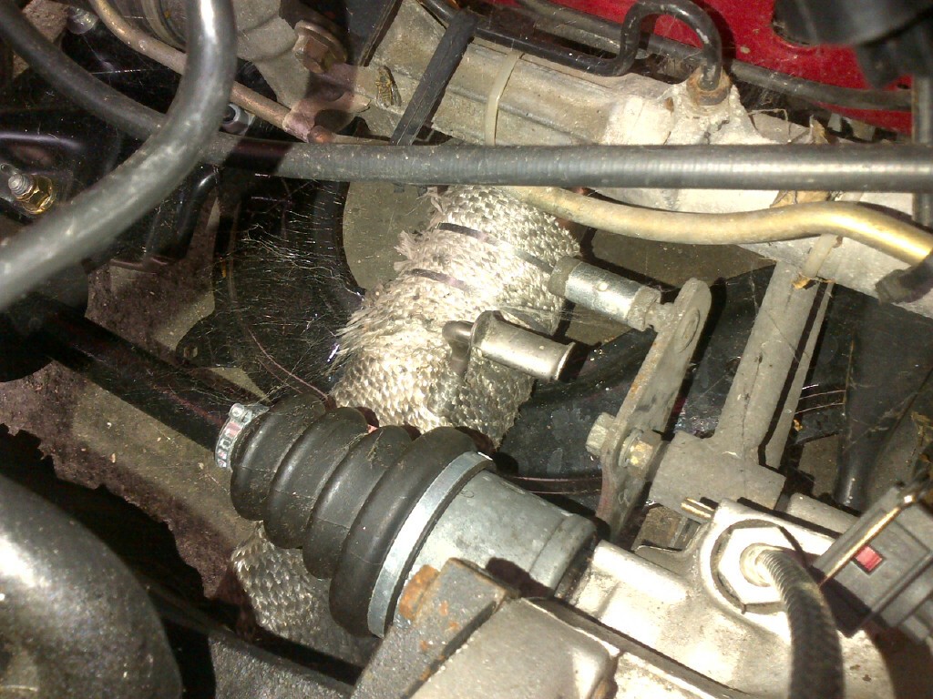

Got a week off this week to try and make some progress, its currently raining so just checking through things.
Is this front gearbox mount wrong? I have a Zetec cradle one the way but want to be sure what gearbox mounts I have.
Max M4X WW :Image
Re: M4X WW - My Zetec Turbo Project
Postby Excursion on Mon Sep 10, 2012 10:10 am
Yes, that is a small block mount. Get a Zetec cradle and mounts.

Postby Max M4X WW on Mon Sep 10, 2012 10:15 am
Is it just the front one I need?
Postby Max M4X WW on Mon Sep 10, 2012 2:05 pm
Are those mounts right? Look the same as mine to me but apparently CVH items.
Postby - Danny Boy - on Mon Sep 10, 2012 2:44 pm
Looks exactly the same as what you have already got.
The front on the zetec is different for sure. I can't find any pics of it though. But if there aren't any up by later and I am down the garage later then I'll grab a pic of it - and there rear too so you can see. Taking the gearbox cradle off anyway so I'll take some pics for you while I am there.
Postby Max M4X WW on Mon Sep 10, 2012 2:53 pm
Its just the front I need photos of really, the rear is the same. Cheers

Postby - Danny Boy - on Tue Sep 11, 2012 2:49 pm
Few pics - not the best because they are just quick snaps from my phone.
Postby Rhinopower on Tue Sep 11, 2012 3:37 pm
I reckon that I was using the wrong cradle mount and that's why I tore one of the studs out the gearbox..... Lol
Postby Max M4X WW on Tue Sep 11, 2012 4:45 pm
Looks perfect, I found one in a breakers earlier but someone had tried to remove it badly (SRC Fontwell if you need anything matey, 2i 16v!)
Postby FRSJON on Tue Sep 11, 2012 6:51 pm
the one in dannys picture is the one i have fitted :)
