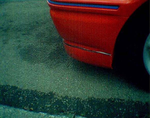

Postby pugeyed on Sun Sep 08, 2002 3:45 pm
look what it did to me front bumper! :x :x :x :x :x :x :x
f**k sake that has really pissed me off!!! :x :x :x :x

Postby pugeyed on Sun Sep 08, 2002 4:09 pm
yer but thats photoshop not fudgekin real life now is it you fuckin gammon slipper!
i must have been over that hump about 100 times and it hasnt caught once! :x :x :x :x for f**k sake!

Postby pugeyed on Sun Sep 08, 2002 4:15 pm
its lowered 50mm on standard shocks, how do people think i should mend it , do it meself with fibreglass and filler or take it to a bodyshop, more fudging expense! :cry:

Postby dr_blackman on Sun Sep 08, 2002 4:21 pm
50mm on standard shocks :o
How is the general ride with standard shocks? :rolleyes:
Mending it your self would be the cheapest way then getting it sprayed :wink:

Postby pugeyed on Sun Sep 08, 2002 4:32 pm
its ok , a bit lumpy but ive lived with it for ages now so i dont really notice it , just a baxtered , sleeky says i should cut out thee bad bits and fibre glass it all back together , opinoins or other ways?

Postby 1600power on Sun Sep 08, 2002 4:38 pm
Nasty m8, I would recommend attempting to do it urself....if u take ur time and are careful with how u do it u'd be surprised how much easier it will become!

Postby Sphinx on Sun Sep 08, 2002 4:51 pm
ouch m8, soz 2 hear bout it.
I've bin debatin blendin a splitter on an havin it nice an smooth like that, but i think not now, 2 much hassle if summin like that happens.
2 repair urs, hack out the loose bits, sand it all down with ruff grade, fill with fibreglass paste, sand, smooth with filler (p 40) and paint. hope that helps :)
Postby pugeyed on Sun Sep 08, 2002 4:52 pm
how would i go about doin it meself though , cus ill have to strip it all right down cus of the crack in the paint , any info ????
cheers mark
