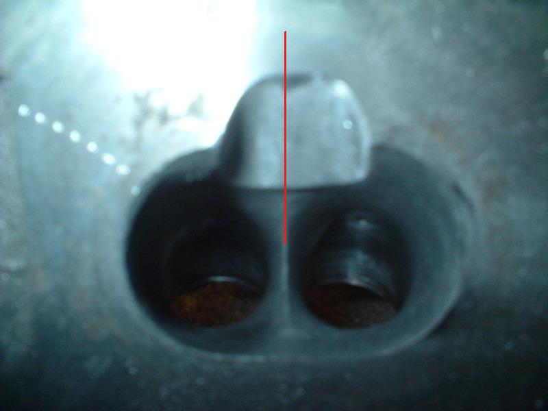

It looks like a child has been let loose with a Die Grinder! The ports aren't even symmetrical.

Postby crazycage on Thu Dec 31, 2009 10:39 pm
Excursion :It looks like a child has been let loose with a Die Grinder! The ports aren't even symmetrical.
thanks for that but you are wrong im no child and you can clearly see the pic is not straight,i could take the same pic of that port and make it look off to the other side.

Re: head work
Postby Ruishy1 on Thu Dec 31, 2009 10:44 pm
mark, i thought a man of your calibre could see the photo was taken at and angle :lol:

Re: head work
Postby crazycage on Thu Dec 31, 2009 10:55 pm
just taken a new pic of that port but you will prob just find a new fault with it but here it is anyway, seems some people dond believe in diy tuning.

Re: head work
Postby Excursion on Fri Jan 01, 2010 12:26 am
It's nothing to do with the angle of which the photo was taken; an offset angle would result in more shadow on one side, not an illusion of greater width. This is basic stuff. Photo's show nothing other than what effect your tool of choice had on the surface of the port, which is largely irrelevant to flow.
I'm not out to pick fault with what you've done, just there was some good advice earlier on in the thread which you advocated, but now seems forgotten.
It can benefit us all if you post the flowbench results from your experiments rather than pictures of the ports themselves.
Re: head work
Postby crazycage on Fri Jan 01, 2010 10:48 am
ok so why do these two look so off set ? if its got nothing to do with the angle? there the same port from both sides ,i cant see the pic on the lcd screen before i take the pic as its to dark in the port.
