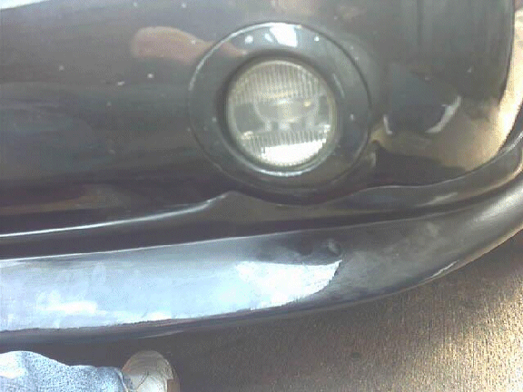

understand some people have had difficulty fitting the fibresports si bib so here u are
tahnks to bridger and elm_us for the info of brackets etc
1. the first thing i did was to secure to the bumper the hockey sticktype bits. i used self tappers but am gonna replace 2mo with rivets
2.if theyre on correct the gap between the sticks and bumper should have a little as gap as poss. however due to fibreglass being crap this may take sum effort :o
3.you will notice that the middle of the bib is not quite pulled up to teh fogs and wobbles all over the place, so i used sum brackets bought from b+q
4. holding the bib up with a jack i marked the bracket holes on both the bib and bumper. (underneath between the bumper and bib)
I used rivets to the bumper and bolts to the bib, however these will be changed to rivets too.
You will have to unscrew the bib from the car to gain access :(
5. Once complete it should be pulled up to the fogs nicely :D
Please note i would recommend that you use silkoflex on all contact areas for added support. I am going to do so 2mo :D
Hope this helps ppl :D :D
