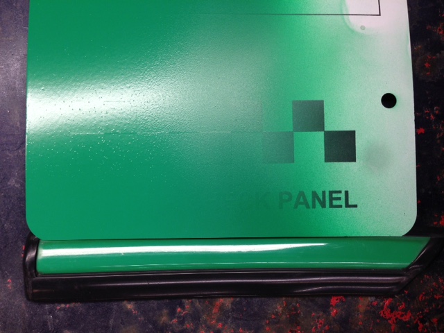

The green bumper mouldings aren't available anymore so I managed to purchase a new genuine xr2i one from the net. There are green ones available from a well known auction site but the colour match isn't as good as the original rs turbo ones.
Im going to prep and paint the xr2i one and the original one that's on the other bumper but was in poor condition to the same colour as the original side mouldings I have by mixing/colour matching from the paint on my mixing scheme.

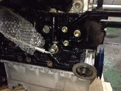

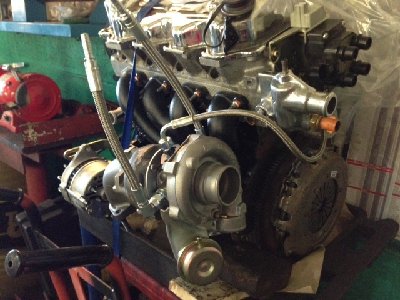

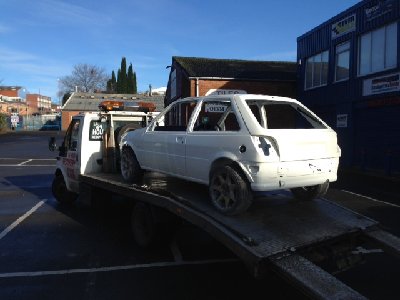

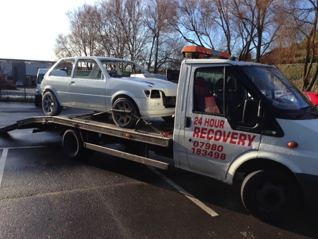

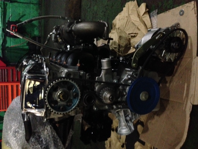

Also, the fiesta got collected this morning to be dropped off to have the engine fitted
Here's some pics of it on the truck and a sneaky pic of the engine.

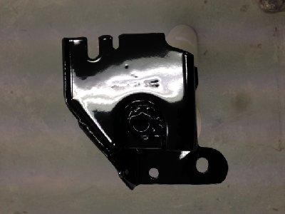

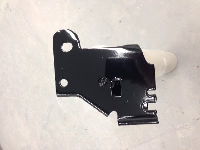

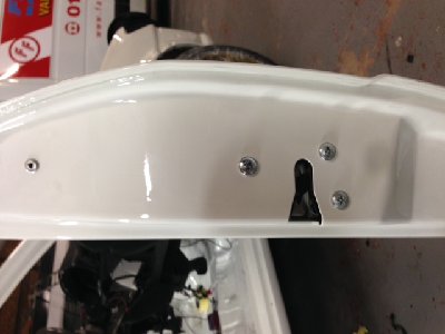

Engine mount has been modified for zvh conversion and painted.

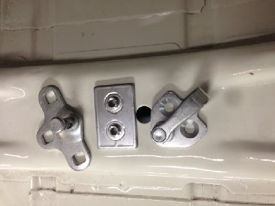

I've started to fit the rest of the car up. Black dash is in and doors have been fitted up using original fixings which have been bright zinc'd.

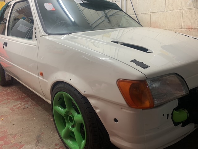

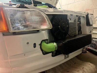

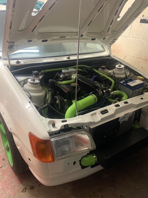

Omex has finally arrived having been ordered in November last year and is now being fitted at my local tuners.
Body kit has been fitted.
I’ve had the gearbox rebuilt using an escort LSD.
Front intercooler from a sierra cosworth has been modified and now fitted.
Once I get it back from the tuners I can crack on with the rest of the interior.
It’s finally going to be on the road soon !

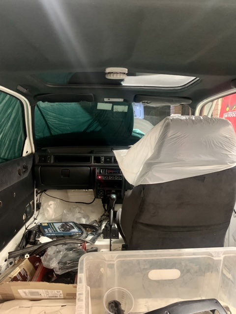

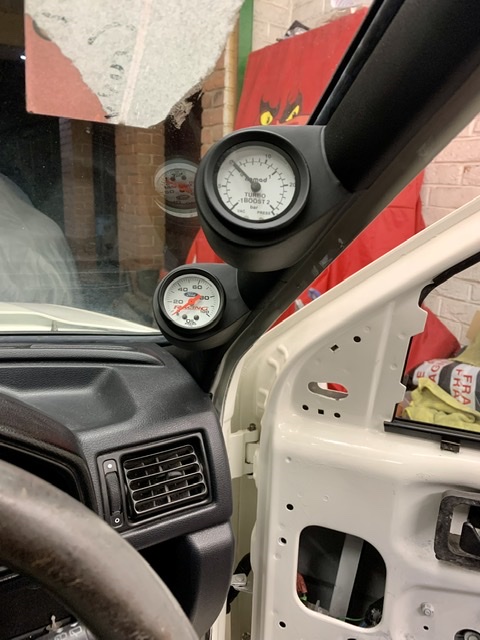

I’ve gone for black interior as the plan with this car was to modify it as I would have in the 90’s.
The headlining has been re covered in black. Black dash and trims along with mint RS1800 recaro seats.
I’ve also fitted boost and oil pressure guages.
In the process of building it up to get it ready for an mot and running into a few problems !
