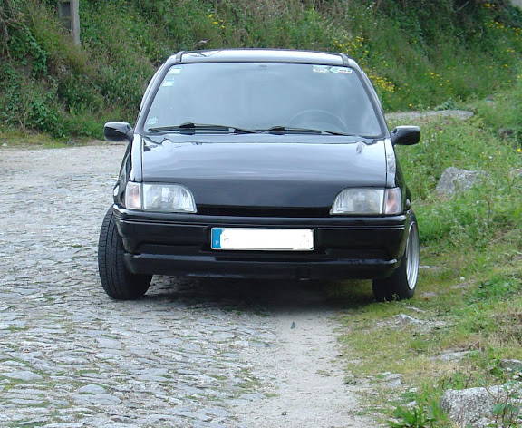

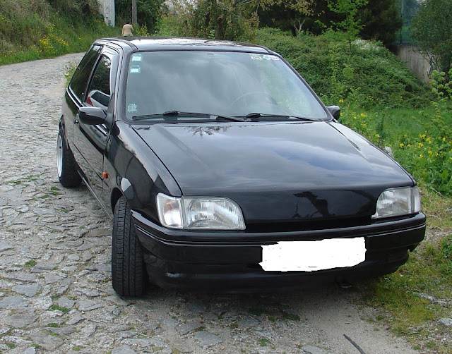

this is the actual look of the car
a little tyre stretch

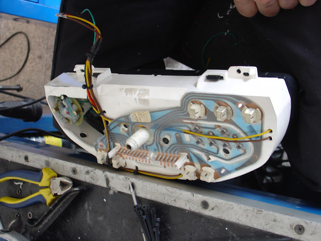

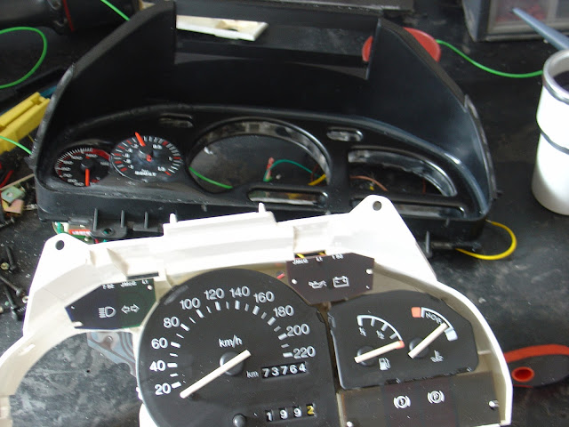

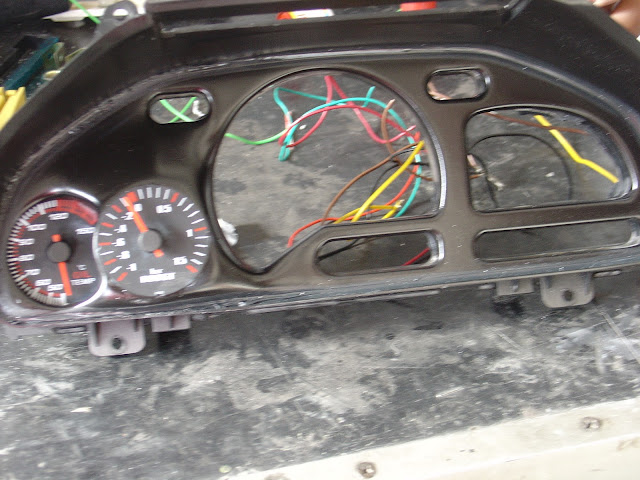

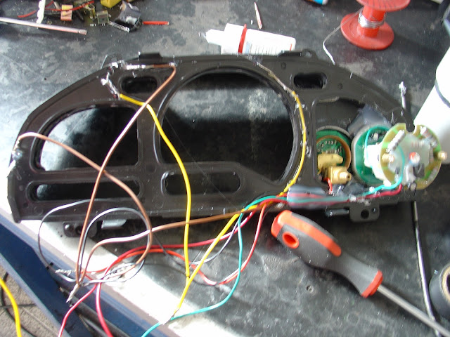

i had a friend that made this dashboard for me:

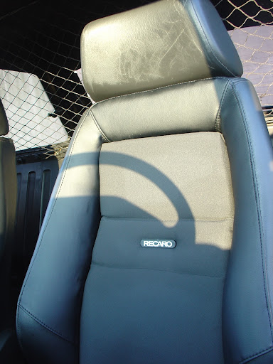

after that i've received this present in christmas from my girlfriend
recaro

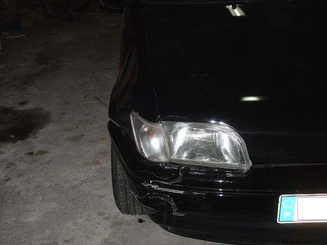

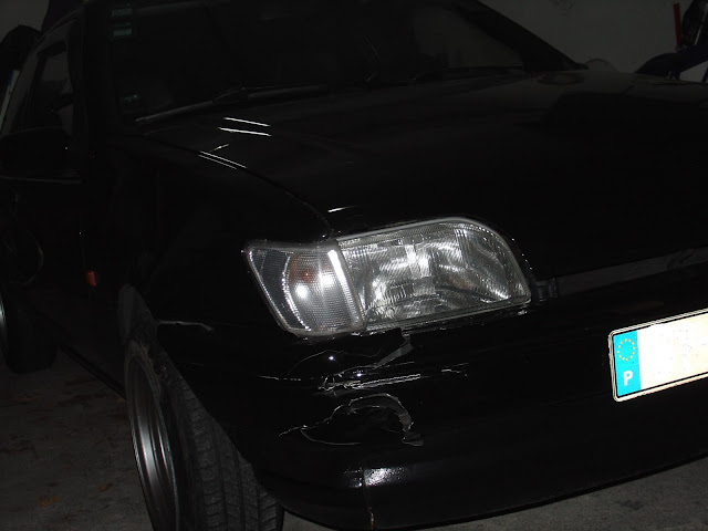

a car bumped into me in reverse so my car was like this

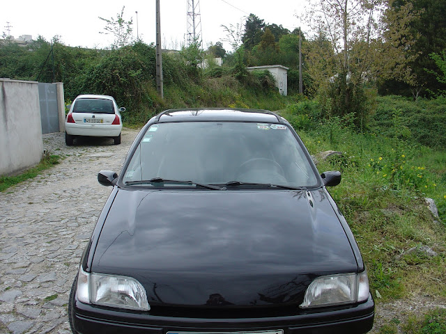

i removed the 2 holes in the hood.

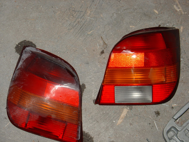

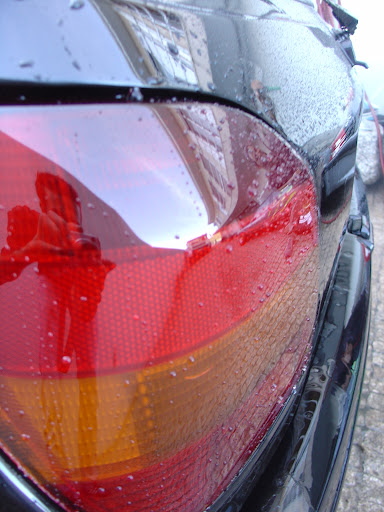

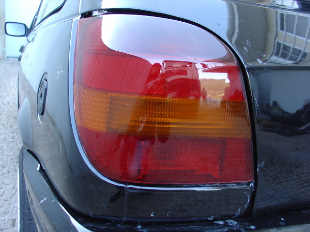

a little detail on my tail lights eu já andava cansado de ver os meus stops traseiros baços, então toca a falar com um amigo a pedir umas dicas e prontos lá meti mãos à obra
working on the left one and the right one with 50% of the work done
final results

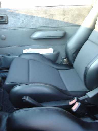

while doing some engine maintenance i had my seats rebuilt

Thanks, the seats are great for long drives
so the polishing was something like this if i remember:
Material:
sheets of sandpaper grit water 400.1200 2000
Polish
Polishing Machine
Soap polishing (fine for aluminum), i've used light blue .
Wash the headlights then start sanding the pieces well until they any grip like the serial number of the headlights i've removed mine, the headlight has to be smooth when you pass your hand on it.
Skip to medium grit sandpaper and repeat the process
Add a little sweat and tears because without these it will not shine
After the surface is smooth with sandpaper repeat 2000 frequently with abundant water in all steps after being homogeneous go to the polishing step in polishing machine, add the soap to the doll and always polish in parallel position to the doll not to hurt the plastic you get a smooth and shiny finish with a mass of fine polishing finish it.
hope you understood, i haven't practiced my english that much
