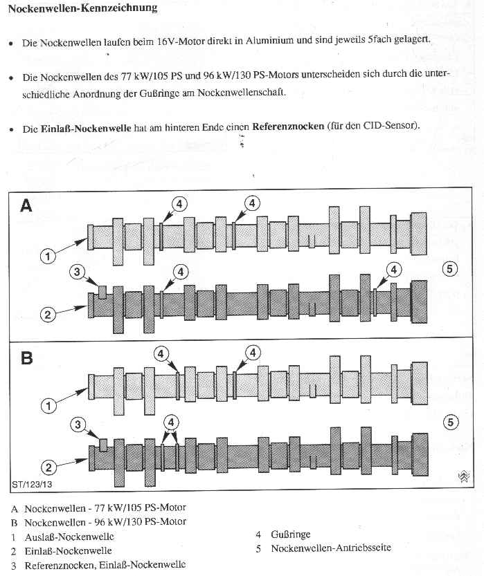

130 cams are different to 2.0l cams.
i was told that the exhaust cams in both mentioned were the same but the inlet cam was not.
i have had a few sets of 2.0l cams and 130 cams.
i have noticed there seem to be different types or shall i say different rings in different places on alot of them.
here is three i have at the mo;
105 spec N stamped on both inlet and exhaust
2.0l with 90 stamped in inlet and the exhaust is blank
130 spec with N stamped on inlet and D stamped on exhaust

There are various cams that were used in the 2.0 engine, i.e., there are differing part numbers. If I remember rightly, the 1.8 130PS exhaust cam matches that of one of the 2.0 combinations, and the inlet matches that of one of the other 2.0 combinations.
So therefore, even though a genuine 130PS set doesn't match any given 2.0 set, it would *probably* be safe to say that the 130PS cams and 2.0 ones are pretty much interchangeable.

Part numbers for anyone who is interested (to follow on from my previous post):
RS1800 (130PS) Cams
Inlet: 958M 6A266 CA
Exhaust: 938M 6A269 CB
Mondeo 2.0 02/1993 to 08/1996
Inlet: 938M 6A266 CB (No Match)
Exhaust: 938M 6A269 CB (Match)
Mondeo 2.0 08/1996 to 05/1998
Inlet: 958M 6A266 CA (Match)
Exhaust: 958M 6A269 CA (No Match)
I have to say, I think it's odd that the RS1800 inlet cam has a 95 year part number, but I can only imagine it was just replaced in some way, and that the actual cam itself is no different?
