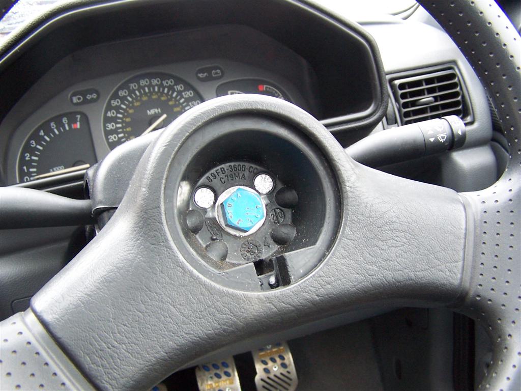

Firstly remove the cover in the centre of the steering wheel to reveal the 22mm bolt, make sure the steering wheel lock is on, unscrew the bolt then put keys in ignition and turn to the first click - you can now remove the steering wheel while pulling it towards you (try to note or mark how the steering wheel is positioned so that you dont put it back on wonky!!) ***Also make sure front wheels are straight***

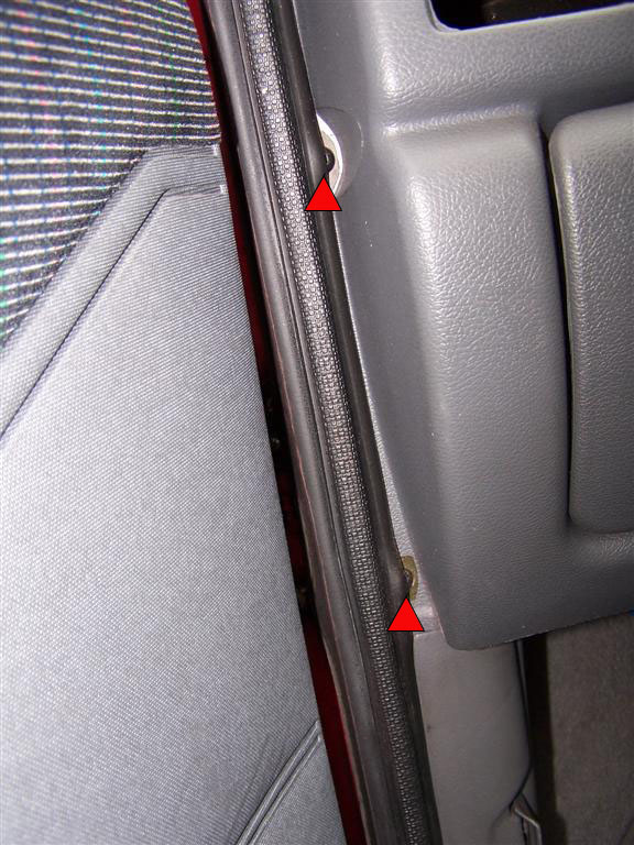

Next up is to remove the steering column shroud, there are 4 screws to remove on the bottom shroud, unscrew these then take off the shroud *as marked*
Then remove the 2 screws on the top shroud, there are 2 more screws underneath the top shroud towards the dials.

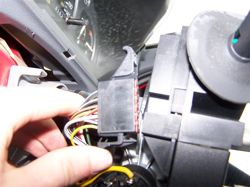

Next is to unclip the 2 wiring harness's clipped in just behind the stalks, once this is done you may remove the stalk assembly.

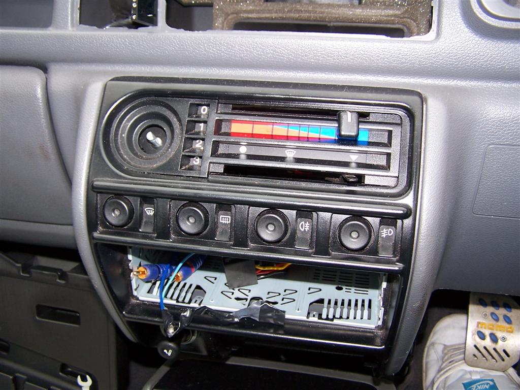

Next up - the heater controls, push both tabs to the right hand side and pull the tabs off, then pull the heater dial off.

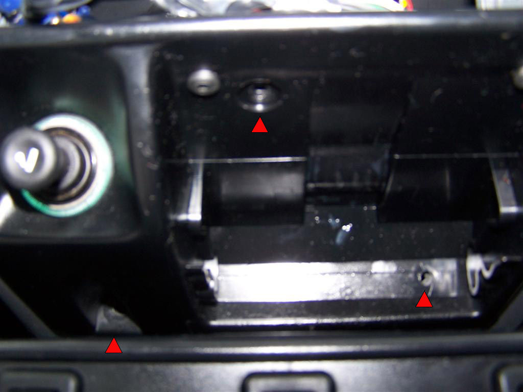

Now remove the ashtry to get to the next set of screws. 2 by the ashtray slot and one bloew the cigarette lighter.

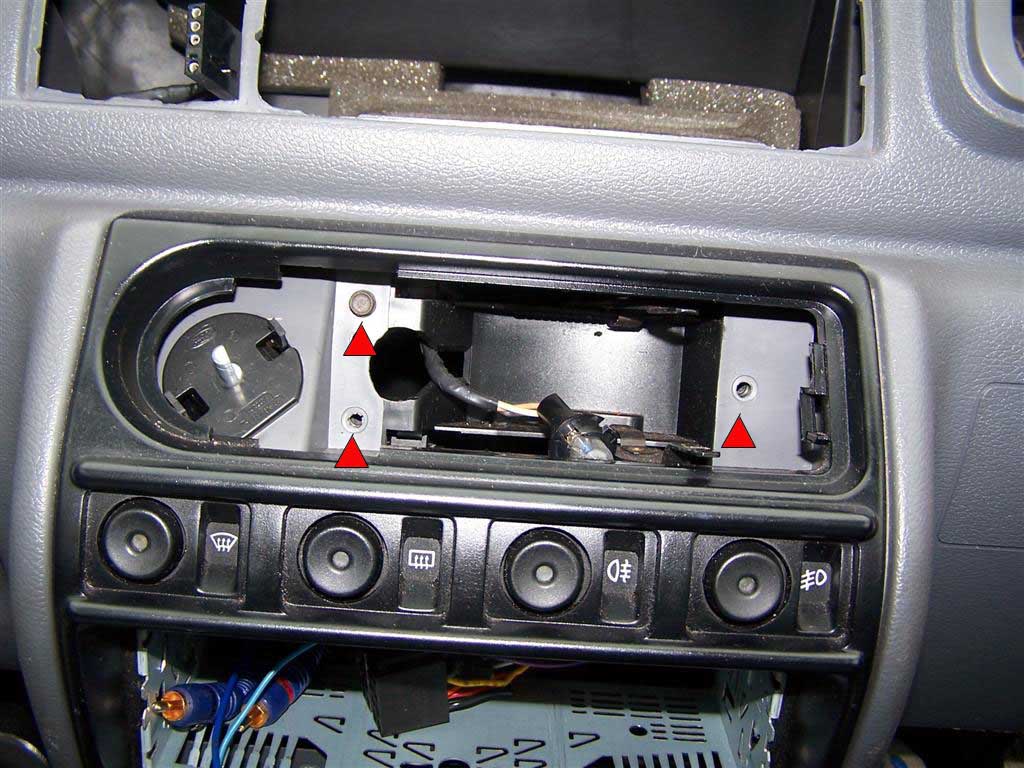

Now remove the heater panel to reveal three 6mm hex screws, remove these, then push the tabs in and pull out the heater control dial and disconnect plug and also the bulb.

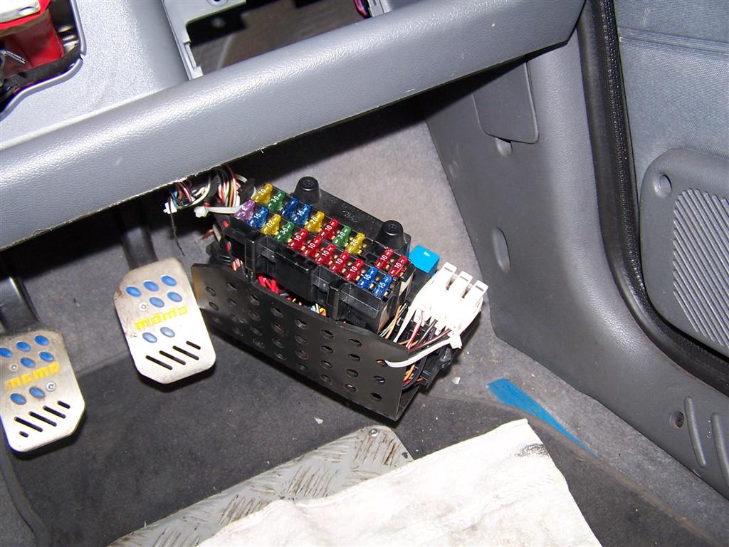

Next i removed the fuse box cover and removed the 2 screws holding the box in place, push the 2 tabs in on the side and push fuse box into the footwell.

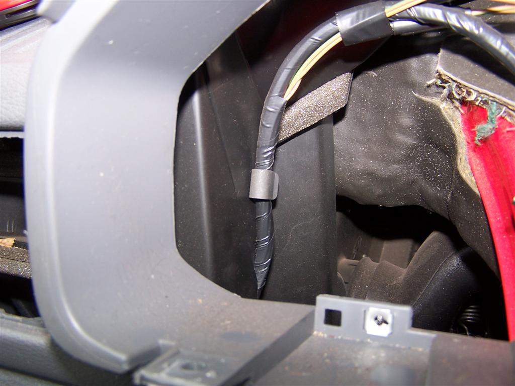

Now you want to start unclipping the wiring looms that are attached to the dash, i have pictured just a couple - you will find more when you start to remove the dash and it wont come forward, just get into the footwell and see what clips are still holding wires in place.
Now get into the footwells and start cutting all the zip ties which secure the loom to the the metal bar behind the dash.

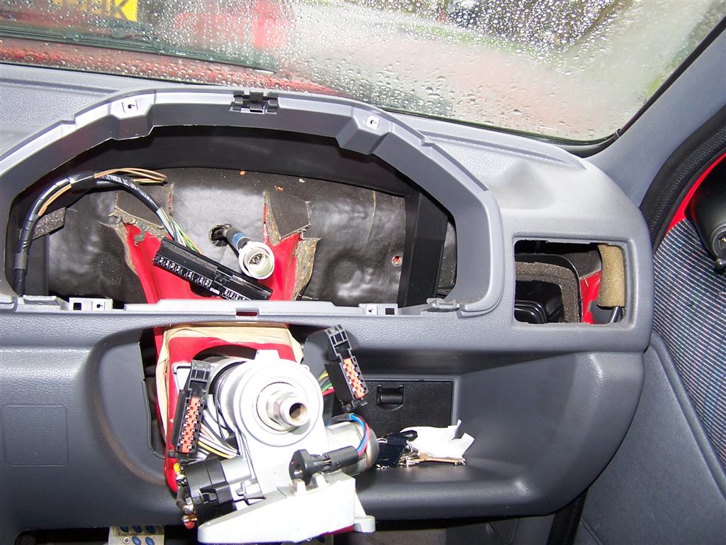

Prettu much all that is left now is to unscrew the 7 Torx screws that hold the dash to the bulkhead - there are 2 each side of the dash by the doors (partially covered by the door seals) 1 on top of the dash in the middle covered by a plastic blanking plate and then 2 in the top corners of the dash by the windscreen - also covered by blanking plates.
Now you can slide the dash off and you will be greeted by this!
at this point i started getting scared!

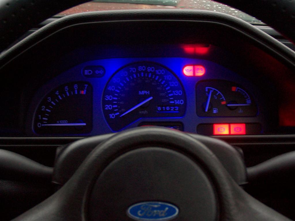

**While the dials where out i thought i would change the colour of the lights like i did in my Zetec S, think its much better then the crappy depressing green colour
looks much better in person!
