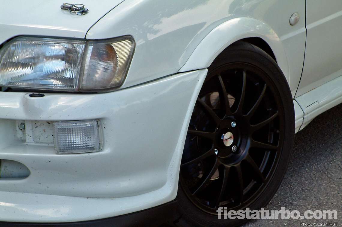

Lightweight Wheels
One of the most effective ways of improving the handling of a car is to reduce the unsprung weight. The prime candidate for this is the wheels. Lightweight wheels such as the Team Dynamics Pro Race series are around 25% lighter than other wheels. For example a 17” Pro-Race 1 is over a pound lighter than a 15” Compomotive MO, despite being two inches bigger (17.3lbs for the Pro Race, 18.7lbs for the MO).
This means the car can accommodate larger brakes under the biggest wheels, without compromising the handling normally associated with increasing wheel size.
