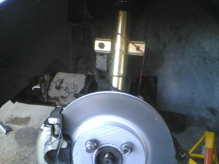

Suspension is now on, wasn't too bad, hardest bit was getting the 19mm bolt at the bottom of the rear struts undone but managed with a big persuader bar in the end!
Also fitted these bad boys, ST170 calipers and discs, cheers to Jay at XFactor for provising the calipers, discs were from Ford.
Compared to standard discs........
Got all of the fun of draining the system to replace the fluid then bleeding it all up this weekend then hopefully ti should be back on its own 4 wheels and rolling soon. Just need to sort some small spacers for the wheels though, although I have trial fitted them quickly, looks like im gonna need 3-5mm spacers at the front and around 7mm at the rear.
And a bit of work in progress, smoothed off the old clock housing and re-cut out to fit Nomad ACT gauge, just needs painting black now.....

Postby andyhardy on Wed Feb 16, 2005 12:48 am
Wow! :o
Looks absolutely great mate - love the wheels, love the brakes, love the suspension. Those 3 things will make the car such a hoot to drive - enjoy!
I'd recommend a strut brace next :)
Postby CRF on Wed Feb 16, 2005 12:56 am
Cheers Andy :D
Wheels are bloody light as well. :)
Suspensions lowered around 40mm at the moment I think, will need some fine tuning when its got weight on wheels though.
Had a look at strut braces recently and seen you can get front and back, not a priority at the moment but probably an upgrade in the future. just want to get it back on the ground ASAP. Then I can see what the wheels look like properly at the correct ride height. Then check up on spacer dimensions to make sure and get them ordered along with some heat wrap for the exhaust manifold as now ive gone T25 the pipe from the compressor housing is shorter so the silicone bend is too close to the manifold for my liking so i want to get both wrapped for protection.
