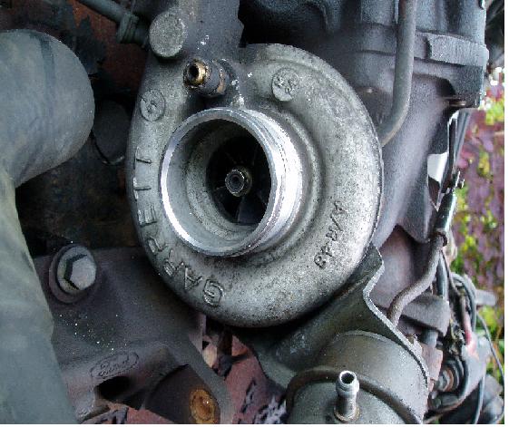

right keep seeing this question poping up so i thought ial write this :D
Here is from memory what you will need to buy to fit an rs turbo engine into your 8v xr2i
heres what i originally brought:
-i used ofac as its easier to convert your loom to that and i heard its better :) so you need the:
- ofac ECU
- ofac map sensor
- iat sensor
- charge carrier
-air box with amal valve (although i didnt use either, i just ran a hose from the turbo to the actuator so the car will boost to the actuator settings :) -
- you need the turbo
engine as parts are differnt, although you can use your 2i's head becuase theyre identical
- manifold include turbo :D
- i used a magnex full system s/s exhaust, not sure if you would be able to use your 2i exhaust, i dont think it sits i nthe same place (from memory) and would probally be too restrictive- recommend fittign 3 new engine mounts as theyre most likley going to b old now but theyre identical to each other
- ideally you need a turbo rad and fan (bear in mind bottom and top rad hoses are differnt from 2i/rs) but you should eb able to pick these up pretty cheap
i used my xr2i rad
1. becuae its bigger and theyre no subsititure for surface area for cooling,
and 2. becuase ive got a front mounted cooler, you cant use a 2i rad and normal intercooler (which you will also need) i will explain this better below :D
- gearbox, the 2i and turbo ratios are slighly differnt but you can use your 2i box with no problems, but you would be best of with a gearbox from a series 2 rs turbo that has lsd
- as for driveshafts you can keep your 2i items with no problems - - brakes you can also keep these as theyre identical, im going for cossie ones though :D
- all boost hoses, and boost pipe (not sure on its name)
im sure i will add to this list when i think of more stuff...

so the conversion it self:
the fun bit: stripping the 2i engine.. basically every hose/ wire multiplug ect.. has to be removed from the engine
its a good diea to either label make a note or take pics or where everyhting goes :D i didnt do either :lol: o yeah disconect the battery too and put it somewhere (its worth randomly charging it to keep it alive while the car isnt running)
so basically you want an engine that looks liek this but still in the car
Image naked :lol:
- disconect the exhaust :D
- disconnect the gear box selctor rod and the other one (not sure of name) but thats easy just a 13mm bolt i think (check haynes) might be worth leaving the car in 4th or 2nd so its easier to connect back up in the right place
- driveshafts... they way i did mine was to undo the torz bolt at the bottom of the hub and pivot the part of out of the ball joint (this freeing the hub and out pops the driveshaft.. try yuor best to keep them level or you will damage them.
- unbolt engine undertray that runs from side to side undo the car 4 or 6 17mm bolts i beleive, nothing needs suporting at this stage.
- personally i would advise taking the front bumper off too
- at this stage i put my car up on ramps at the front- to make it easier as the engine has to come from under neath :D (if your doing the gearbox with it atleast)
- right i think from this stage its hoist time (or scafolding or whateever depending on how mad you are.. the cvh isnt light :lol: )
theyre is two lifting eyes on the cvh that you can see , i ran a seat belt through these and gently lifted the engine so i could tell it was slightly suported, i then proceeded to undo all the engine mounts and all the bolts holding on the lower cradle, top engine mount is on the o/s theyre is a bolt behind the wheel and on top of the mount, i think the engine should be then loose. so carefully lower the hoist and your n/a engine should eb on the floor
- dont know if this is right but i lifted the front of the casr with the hoist but it worked and was able to slide the engine from underneath (ive got pics somewhere ial try and find them)
reverse this process, quite awkward lifting the new engine in but it will be able to get into position, then do up the mounts.. its then your job to connect every wire, and hose ect... as pictured it should look sumthign liek this..
and below with the rad held into postion for size :) ( hadnt seen it done before - but it works :D )
