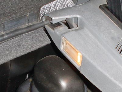

Like many other cheaper Ford cars, there is only one tacky light in my boot, which looks very dull and most importantly, not bright enough for general usage. So I was going to fit one more light, but then I thought... as I am doing it anyway, why not change it to blue merely for the wow factor. And no, since I am doing it to my boot (with practicality) not the footwell or dash, it is not considered "Max Power youth" style.

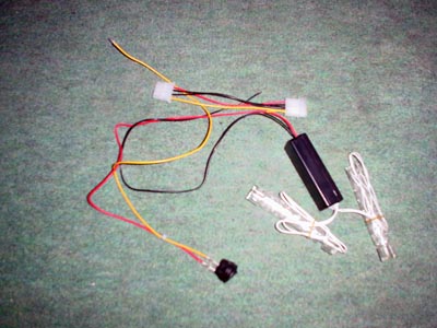

This is what I got. The kit consists of:
1. Two cold cathode tubes
2. Inverter (these lights use AC current)
3. Switch
4. Molex connectors
Comparing to neon tubes, cold cathode tubes are quite fragile. A plastic (probably acrylic) tube was there to protect the tube, but care still needs to be taken.
To connect the cold cathode tubes to the car, I chopped off the molex connectors, and used two crimp bullet connectors, one for 12v (yellow) and one for earth (black). The kit was apparently tested using my PC before commencing modding
This boot light is going to be redundant. So I removed fuse before doing anything, then twisted the bulb out and chopped wire and used two female crimp bullet connectors for the 12v live and the earth. Then, yes, just connect the bullet connectors, use the supplied sticky pads to stick the tubes to somewhere hidden, and cable tie everything making sure nothing moves when I am driving, stopping, going around corners, etc.

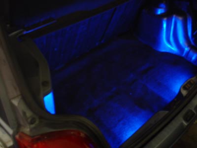

Before lights on...
Voila!! There you go.
An added bonus is that, because there is a switch, I can turn it off when I open the boot but do not really need the light.
3. Switch
4. Molex connectors
Before lights on...
