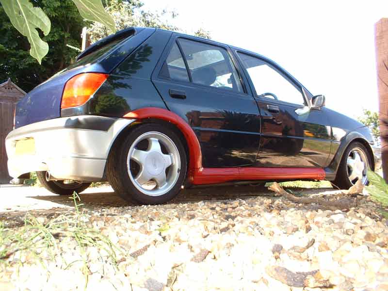

Postby MaXsteri on Mon Jul 28, 2003 6:40 pm
wywywywy :When are you going to paint them?
:lol: One day :wink:
DaveMCMkIII ::lol: nutsack is it easy, its a bloody nightmare!!!!! :lol
:P I found using fake_xr2i's methodwas more or less impossible to make it look decent :oooh: Wrecked 3 arches doing that :oooh: But using my method i found it WELL easy and got it looking mint first time :bonkers: Just try to make a better job of the Tigerbond than i did. i need a respray anyway, and my tube had burst, so i didnt care about how it looked and just applied it with fingers, then sanded it down and primered over. Unless you want a respray you might want to be a bit more careful when applying tigerbond :wink:
MaXsteri :After THREE failed attempts :oooh: I found THE best way was to forget about the door to start with. Get the arch all self tappered on top and bottom so the door dont open. Then use Tigerbond to stick the arch to the door, using g-clamps and the self tappers to keep it in place.
Then once its dry, remove all the screws and you left with the arch stuck perfectly in place to just the door. Which means, now you can cut the arch very close to the door top and bottom, then screw the top and bottom pieces back in place and you are left with an extreamly tight gap around the door piece and it will rub when you close the door. Then all thats left to do is sand the edges down VERY slightly so that it doesnt rub, leaving you with the best fit ever :)
Then just Tigerbond the top and bottom pieces in place to make them secure, and repeat on the other side :)
I found the best method of cutting was to use a hacksaw and aim for a straight line. All my previous attempts involved using a stanley and trying to follow the line of the door, which was impossible and ended up looking sh!t and leaving massive gaps :(
Also make sure that you leave atleast 1 (preferably 2) weeks between each step :wink: Otherwise it will feel much too much like hard work and progress :lol: I found the weather is a good excuse :wink: Either its too cold or its too hot :bonkers: :wink:
Ignore the half hanging out self tappers and the overspill of Tigerbond :oooh: Picture was taken before i was finished playing :) But thats what my gaps of the rear door look like close up, and if you look at the pics at the top of the page you'll see that the gap is hardly noticable :) So to say im happy with the result is a slight understatement :wink: :D

Postby wywywywy on Mon Jul 28, 2003 8:31 pm
Thanks thats very good info!
So you need to cut off the arches that are originally on the car, before putting the 2i arches on, right?
Thanks.
wywywywy
Posts: 1381
Joined: Thu Jun 19, 2003 8:23 pm
Location: Warrington, Cheshire
Postby MaXsteri on Mon Jul 28, 2003 8:38 pm
No! :o

Postby MaXsteri on Mon Jul 28, 2003 9:23 pm
You mean the Max Poo manual? :-? Cause those arnt 2i arches, and they are also cutting away the arch to fit bigger alloys.
You dont need to do that tho, i didnt :bonkers:

Postby Tweek on Mon Feb 16, 2009 10:15 pm
They don't look that good really, I had them like that on my old car:

Hello!
The RS skirts arent long enough to fit a 5-door right?
What have you used to extend them, just fiberglass and filler?
teamshock nick
Posts: 82
Joined: Thu Feb 18, 2010 10:08 am
Re: Skirts for 5dr
Postby Tweek on Fri Jul 08, 2011 5:16 pm
teamshock nick :Hello!
Huh? 3dr and 5dr Fiestas are exactly the same length. Only difference you'll notice with the skirts on a 5dr is the gaps where they meet the front arch pieces is offset because the doors are shorter. Haven't been extended in any way!
The arch pieces also include part of the sideskirt so you need all 3 parts on each side.
