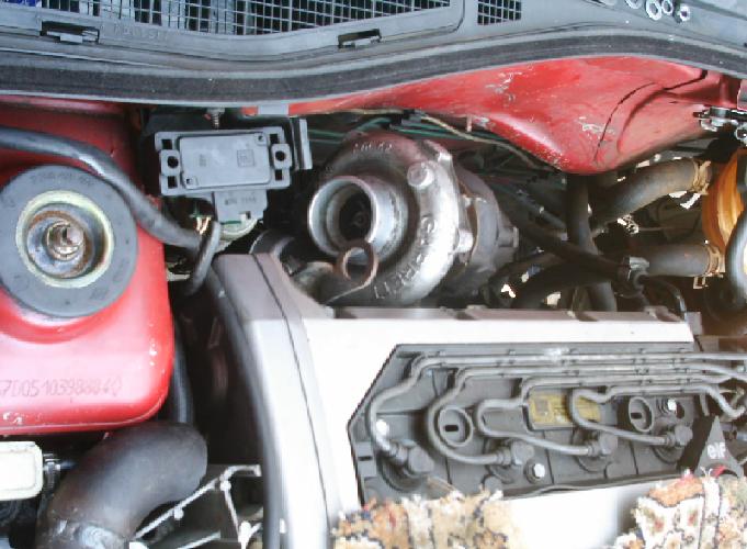

Just started making an exhaust manifold tonight, still early days but u can get an idea of what it'll look like.
Pieces of pre-bent pipework welded together, could be useful for the zetec turbo people to make their own free flowing manifold!
Got a stage 3 hybrid t3, 2 ltr 16v williams engine, renault 21 turbo management, 10 row oil cooler, frontera intercooler (5ltr estimate)
Busy saving for some JE low comp pistons from america and uprated rods n bolts
Manifold is just about complete now :D couple of runs of weld still needed

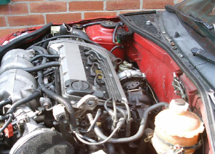

fitted rather nicely i think :D :D :D :D :D :D :D
another WOW it fits angle :lol: :Q :D

cheers chum, was the best one that would allow the turbo to be mounted as close as possible to the engine, as space is tight between engine and bulkhead! :oooh: should flow rather well i think :)

Red16 have u not tried alternative locations for the turbo?? Am i right in saying it'll be right infront of the engine just behind the slampanel?

nah chum, the turbo will be sitting on the otherside of the engine (opposite to a zetec engine), so its trapped up against the bulkhead, which may need persuading back a little :lol:

Postby chumkila on Fri May 30, 2003 8:45 am
Whoa! thats gona be tight Red.

Postby TJ on Fri May 30, 2003 8:50 am
Better get the Vaseline on that turbo!!
