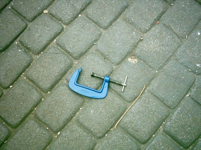

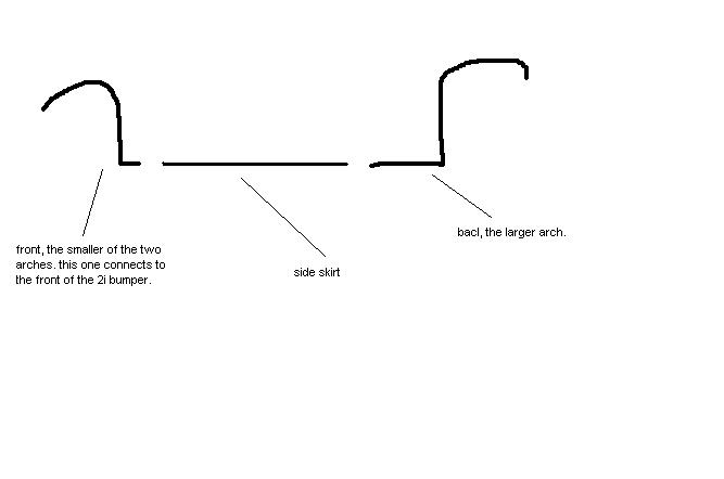

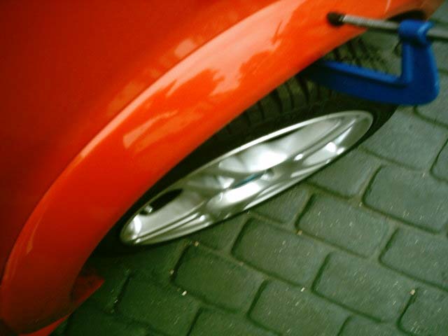

The skirts and arches are fairly straight forward, but i will make this guide to show you how to do it so you cant go wrong.
Obviously your kit should consist of two front arches, two rear arches, and two side skirts.
The smaller of the two arches go on the front of the car, and the larger of the two go on the back of the car, and obviously il leave it to you to guess where the side skirt goes :bonkers:
Here is a little diagram ;
To stick them on, i put two or three self tappers on the inside of the arch, i used 5mm wide ones and they were about 25mm in length. Make sure you put them on the inside of the arch though as you dont want them to be showing, but obviously to do this you will need to take off the wheels to be able to get a suitable size screw driver in to tighten them up. Along with the self tappers i did use sikaflex at the time when i bought them but didnt think much of it, so i went to b&q and got something called EVO-STICK and a clamp, and its worked a treat. I put this evo-stick all the way along the inside of the arch, and just held them in close for about 2 hours with the clamp, and they are perfect. If on the other hand, you do not have a clamp and dont want to spend one of the best 8 pounds of your life, there is the option of masking tape, but obviously you do not get it to fit as nice, as the resistance peels the masking tape off! So thats that done!
As for the side skirt, make sure you do this last as these basically just slide on over the bits of the arches. You could either use rivets or self tappers again to secure these on, i didnt use any glue for them as i didnt see the point, but i know other people who have so the choice is yours obviously. I think the recommended way to put the skirts on is to rivet the top of them, and screw them in at the bottom, but its not the end of the world if you dont have a rivet gun and use self tappers all the way, they wont budge!
Let the glue and everything to dry for 24 hours or so preferably with the clamps on, and you should get a finished outcome of this;
hope this helps, feel free to catch me on msn or anything if you have any questions :)

lol the staff at halfords round here prob dont even know what a clamp is :lol:

jay m8 i love the diag! :lol: :lol: :lol:

Postby eXtreme-fiesta on Wed Jul 02, 2003 8:46 pm
you might be able to get away with just that on the arches but i wouldnt risk it, specially when travelling at high speeds i.e motorways in wet conditions. You could kiss them goodbye!
The skirts i def wouldnt just use an adhesive to put them on. If you are worried about drilling into your car, just drill them in from the underneath so if you do take the skirts off at a later date you wont be able to see the holes unless you look under the car.

is the diagram to scale?

Postby chimp2k2 on Thu Oct 02, 2003 4:32 pm
SantaHul :is the diagram to scale?
it probably took him about 3 seconds to draw on M$ Paint, so i'd take that as a good chance it isn't to scale :lol:
:lol: :lol: :lol: :lol:
Pi$$ed myself when i read this!!
