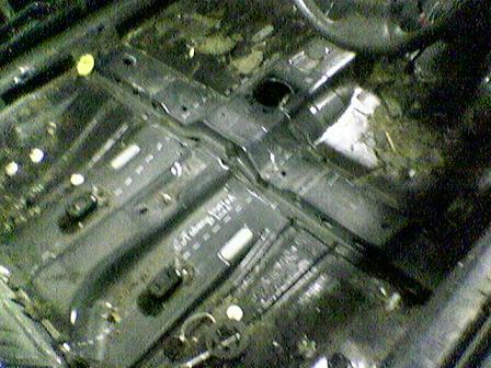

Right, this whole project started when i was offered a mk3.5 fiesta for the pricely sum of £40 (bit steep i know).
I originally planned to do a if i dare say straight forward zetec turbo fiesta, but i have a lot friends who are into classic cars and believe that front wheel drive cars are the worst thing to happen to cars. So with only a little bit of persuasion they got me thinking of making it rear wheel drive, which lead to me asking a few questions of what gearbox could i use to mate upto the zetec, what rear axel could i use? Up until now i didn't know a great deal about rear wheel drive so its all pretty new to me too.
Appologies for the lack of photos from the beginning of the project but i didn't originally plan to post this up.
With the fiesta stripped i started measuring up for the tunnel, so that i could get cutting the floor and bulkhead out. At first i was going to fabricate my own tunnel but a mate was scrapping a mk5 cortina so i decided to use the tunnel from that.
Once we had measured up it was time to get cutting :devil:
In that picture you'll notice that the chassis rails bend in towards the centre of the car which obviously will be in the way for the propshaft and possibly gearbox. Once i got those cut away it was time for the rest of the floor.
Then it was a case of positioning the tunnel into place and welding it in place.
The tunnel will be welded from both inside and outside of the car.

Postby Sphinx on Wed Oct 19, 2005 10:48 pm
:o What are you going to do now you've chopped the chassis legs out?
Postby Rodge on Wed Oct 19, 2005 10:54 pm
I have some already made up and waiting to go back onto the car :D
Instead of coming in towards the middle of the car there going run straight down either side of the tunnel

Update
Not much of an update as today it was mostly welding the tunnel in, have most of the inside welded just need to put the cross section back into place then the inside should be done. Then its onto the underneath of the car where i also have to replace the chassis rails that had to be cut out.
Spent half an hour or so cleaning up the rear axle as well today, i was originally going to strip it all down and send it off to be sand blasted but it ain't in to bad a condition, so we'll how it looks after some more cleaning.
Should hopefully be starting to get it mounted over the weekend, which is the job i am most worried about on the whole project, not quite sure why, must just be me being a tart :bonkers:
