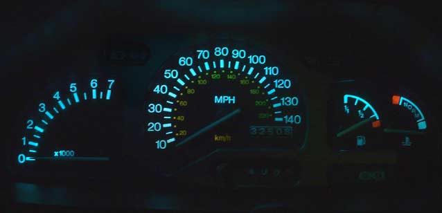

Postby zetec_si on Wed Nov 13, 2002 11:51 pm
(My needles arn't bright enough. :( :-? )
EDIT: Sorted out needle prob. Got the standard dashlight and used blue bulb paint to make it very dark blue. Now it is Dimly Blue and only bright enough to light up the white needles (If using different colours you will need to remove the green filter - See further posts down the page for instructions.)
(Sorry about the pic quality. Digicams don't work well in the dark!)
Anyone have any suggestions on how I could make them light up or something?
Don't want to add a light back where the standard dash lights are. (Kinda defeats the object of having it backlit! :) )
Cheers.
Lee.

Postby zetec_si on Thu Nov 14, 2002 1:47 am
Some good ideas! UV light sounds good but won't the needles light up green? Will have to try to get some clear blue needles.
As for the dials they are :D ORIGINALS :D . Just wired up some blue lights in parallel and they are bright enough to come through the white markings.
Ask if you need help.

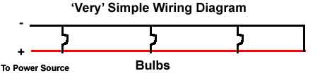

Postby zetec_si on Thu Nov 14, 2002 10:49 pm
I just wired up 5 blue sidelight bulbs (use red, purple, yellow, orange or whatever you fancy if you can get hold of them!!!!) in parallel, insulated them and then carefully put them behind the dials (don't get wire or bulbs in the way of the mechs of the instuments otherwise your speedo might get stuck on 20MPH or summut!).
I them wired it up to the power for the dashlights. (don't forget to remove the standard dashlights or you won't see the backlight very well.)
I wouldn't advise on putting more than five lights in since it might get too warm in the dash or blow the fuse. (I blew the fuse when connecting it up - lost all my dash and centre console lights! Then took me half an hour to find out that its wired up to the sidelight fuse! lol.)
Also, Tried using blue LED's but they produce a focused beam, like a spotlight and don't light up all the dials, plus they are about 4 quid each! whereas I got the bulbs for 50p each (You can get them from halfords or Demon Tweaks but they cost more I think)
I got some blue bulb paint somewhere. May put a coat on the lights to make them deeper blue but I think they look alright and are easy to see.
Hope this helps. Lee.

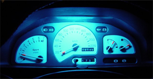

Postby Jur on Mon Dec 02, 2002 11:08 am
This is how i've done my blue front lit dash, using a small (4") neon stick.
- Open the dash
- Remove the 2 dash-lights
- Get the front of the dash
- Remove the 'white' top
- Remove the green lens
- Drill 2 holes on the both ends of the white top
- Stick the Neon tube on the white top
- Lead the wires out
- Connect the wires to the transformator
- Connect ground and +12volt wires of the trafo to a dummy dash-light-bulb (empty lightbulb holder) (soldering)
- Put all back together again (leave the green lens)
- Connect the dummy bulb to the dash.. ATTENTION +12V is the nearest to the windscreen...
Here's the result
